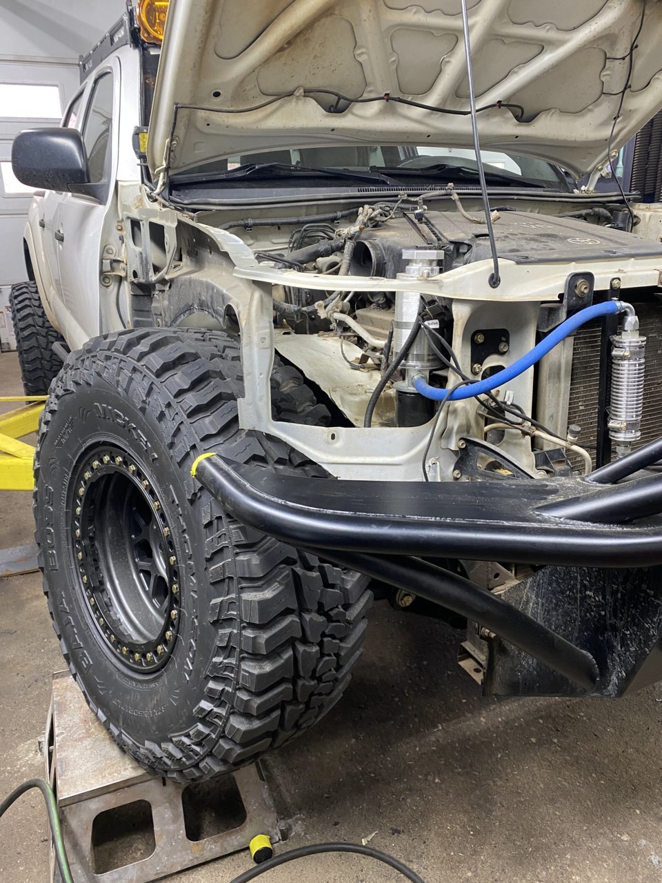

    The new inner fenders set up is looking mighty fresh!!! These are gonna be the next game changer.

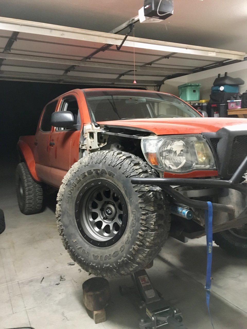

    @kasnerd truck and mine both clear 35’s at 2” forward over stock so if you only go 1” forward you will be good. You will also have to trim the outer corner of the new inner fender but it’s very minimal
