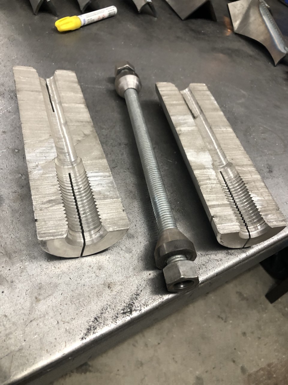

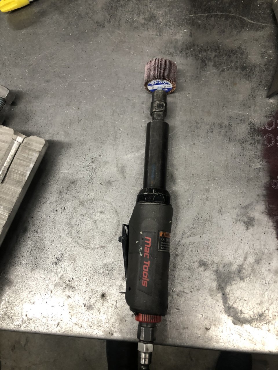

    You make one of these... you CAN NOT use a slug, it will NEVER come out. Even with this you need to use a long barrel sander to tune it in... no problems here :)

    That looks like an expandable slug essentially? Put it in, tighten the bolt and it expands, then undo it when done? Nifty.

    Yes sir

    Ok, so how does a guy at home do it that doesn’t have the equipment to build such tool? Just trying to get my education in before I start lol.

    Don’t weld towards the bottom of the can and you will be fine. Also don’t tig weld the as they will warp badly

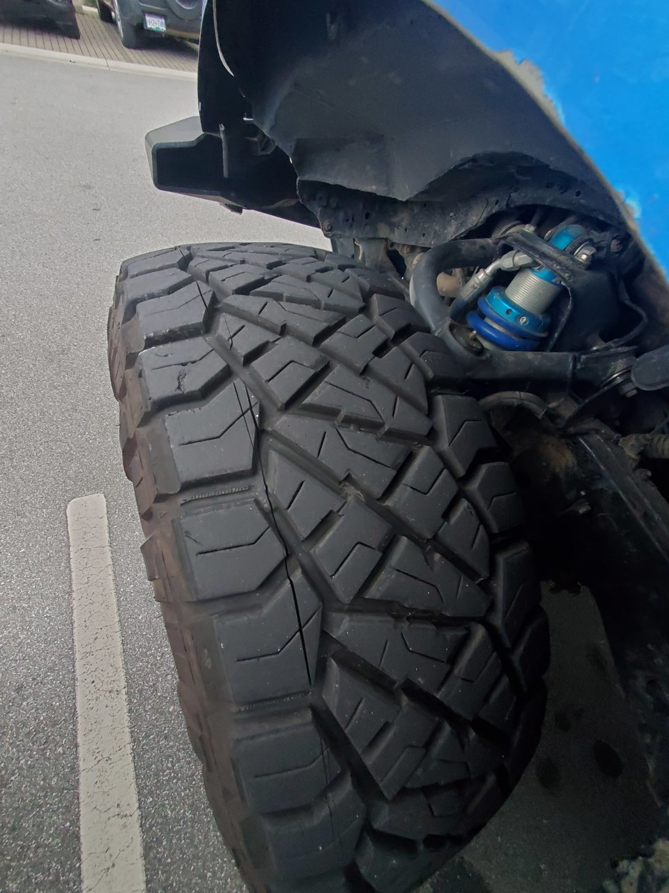

    I don't think I ever showed you guys this. If anybody remembers that I hit a cross ditch super hard a while back, the sheet metal from my fender sliced through my tire. I clearanced them for the 37s so there was around .5-.75" of room at full stuff (no bump stops). Still managed to put a slice in my tire around an inch deep. Just goes to show how much these frames twist and flex. Really really need to do an engin cross over between the coil buckets.

    This is why fiberglass is better.....just explode your fender instead of jacking up your tire........not exactly sure which is better to be honest.....lmao
