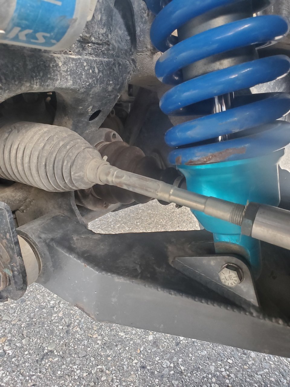

    How far forward do you have the arms pushed?

    All the way back, same on both sides.
    I'm not worried about it really, but don't want that on a customer's truck.

    For the third gens pushed forward you have to run offset mis alignment spacers to avoid that

    On the lower rod end of the coilover? or where?
    That might explain why I'm getting some contact with my TREs

    Is there room for an offset? I thought they were 1.25" spacing with no room for offset spacers, unless it changed from the kit on my truck?

    It’s still 1.25 spacing and you can pull a little bit out of it to make room

    Gotcha. Wish I had a lathe.
    Do you use offset misalignments for stock arms? On this other truck we are just wrapping up, I used offsets for the kings to push the coilover back just to make sure, didn't look like it would touch, but it was close

    Only on 3rd gens pushed forward more than 3/4”

    Perfect, that's what I did. Thanks!

    I guess I better get some of those then -- is that something I can order from like, Kartek or some place? I'm still gettin friendly with the coil/TRE.
