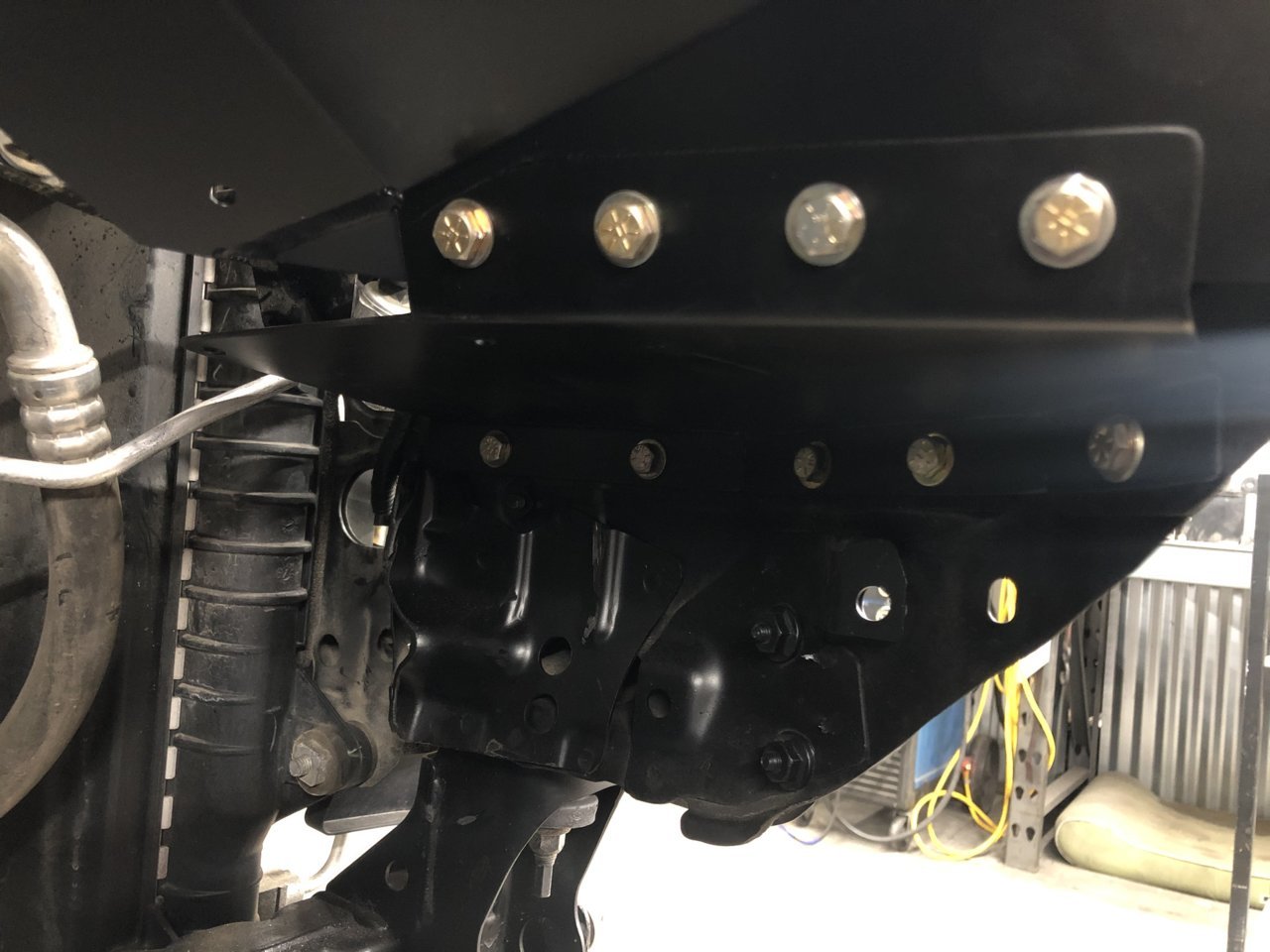

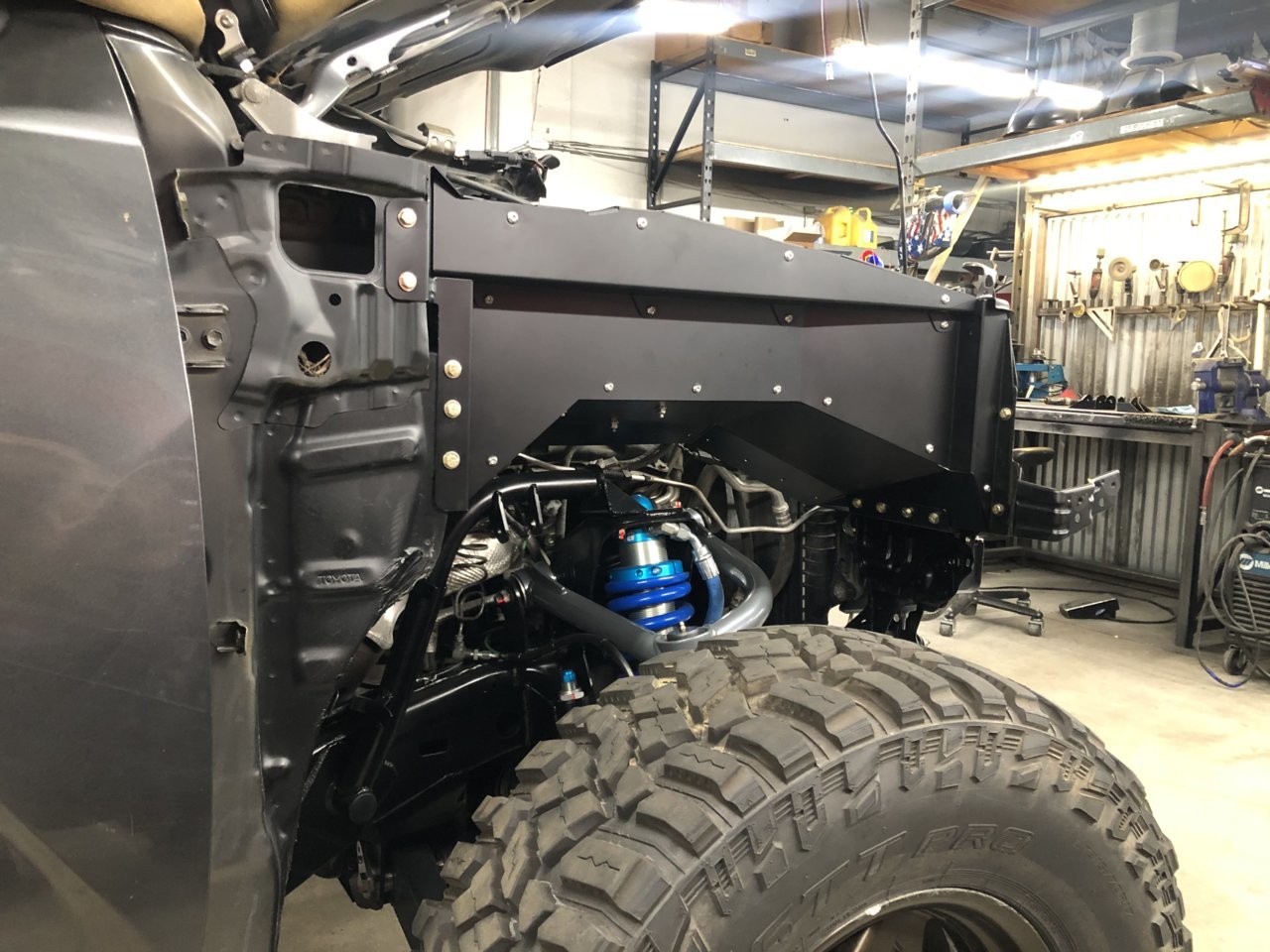

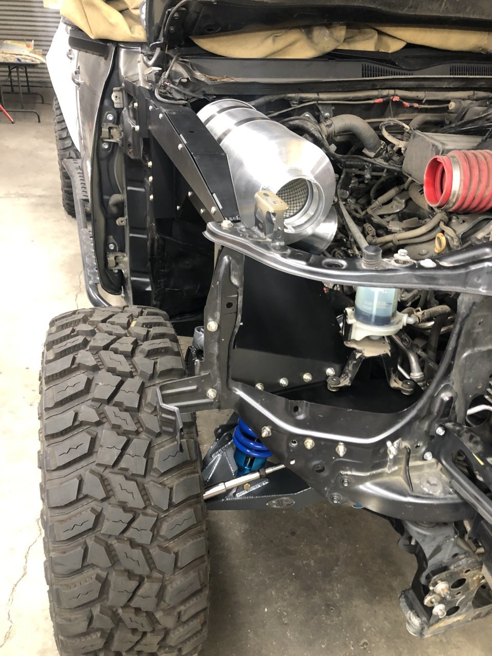

    Got the inner fenders 100% dialed in. I made some changes to version 3 where they attach up front. It’s now designed to completely cut out the sheet metal up front and they bolt directly to the front core support. This will completely fix the issue of the core support cracking underneath the headlights and allows for an easy install of a completely new core support if it’s needed

    Will these still fit up to the 3rd gens?

    That's what you see in the picture

    Nice. I couldn't really tell from the pics

    I’m in for the inner fenders. My core support is cracked to shit.

    Can you give any pictures or list of what has to be modified, remounted, changed from the engine bay side? I see all you have over there is a big UMP. I have a TRD sport, so have the antilock brake stuff over on the passenger side. I also mounted a battery over the inner fender since I don't have an air intake there. But there is also a PS reservoir and a washer reservoir there, I assume all those would have to go or get changed up somehow? Do you provide those solutions or since everyone is different and some will be using your PS pump, like it is up to everyone to figure out their own solution? I recall hearing that there will still be a reinforced battery tray on the drivers side, and the fuse box doesn't need to be remounted. But nothing gets in the way of the vacuum booster, or SC coolant reservoir over there? I know things are new, not like lots of trucks have them yet, and my questions will probably be answered when more kits get installed... but would like to hear it from the source. More pics from the engine bay side might help.

    This has all been covered before with lots of pics between @kasnerd truck and mine
