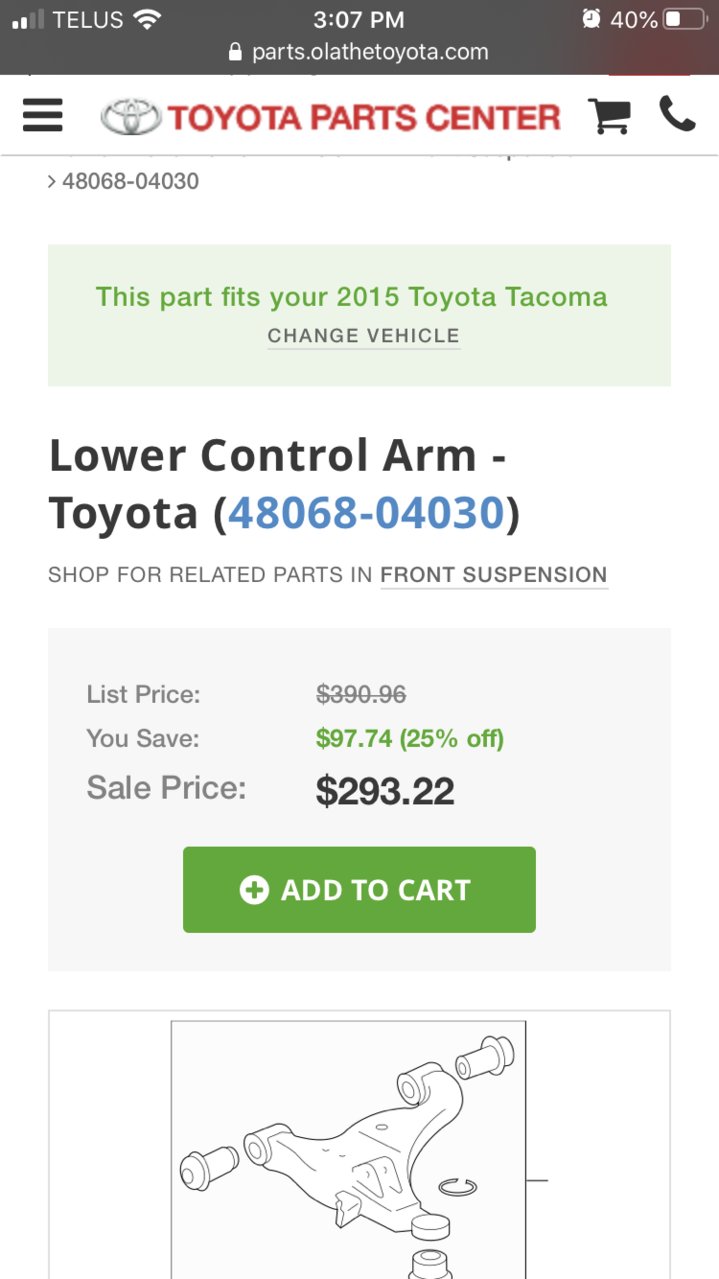

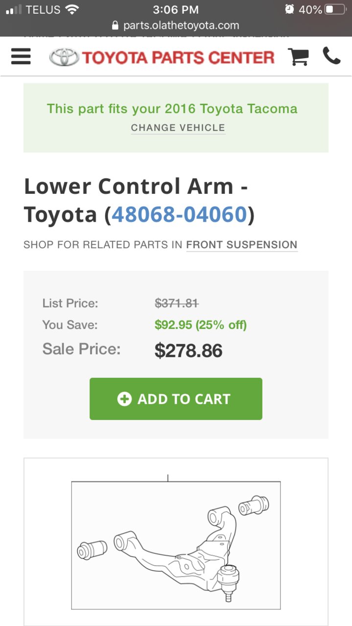

    it’s already been mentioned in this thread there are differences. Rear bolt holes are larger on 3rd Gen. arms are also different. Not asking a new question, asking for an update.

    The real question is what the rear bushing inside diameter? From what I can tell is it’s the same, the difference between 2nd and 3rd gen is the cam diameter. If that’s the case then the kit will work for a 3rd gen as all the cams are replaced with grade 8 bolts

    I believe the differences are the following
    All values are "-ish"
    2nd gen:
    Front - .750" outside of sleeve
    Rear - .562" bolt diameter
    3rd gen:
    Front - .820" outside of sleeve
    Rear - .625" bolt diameter
