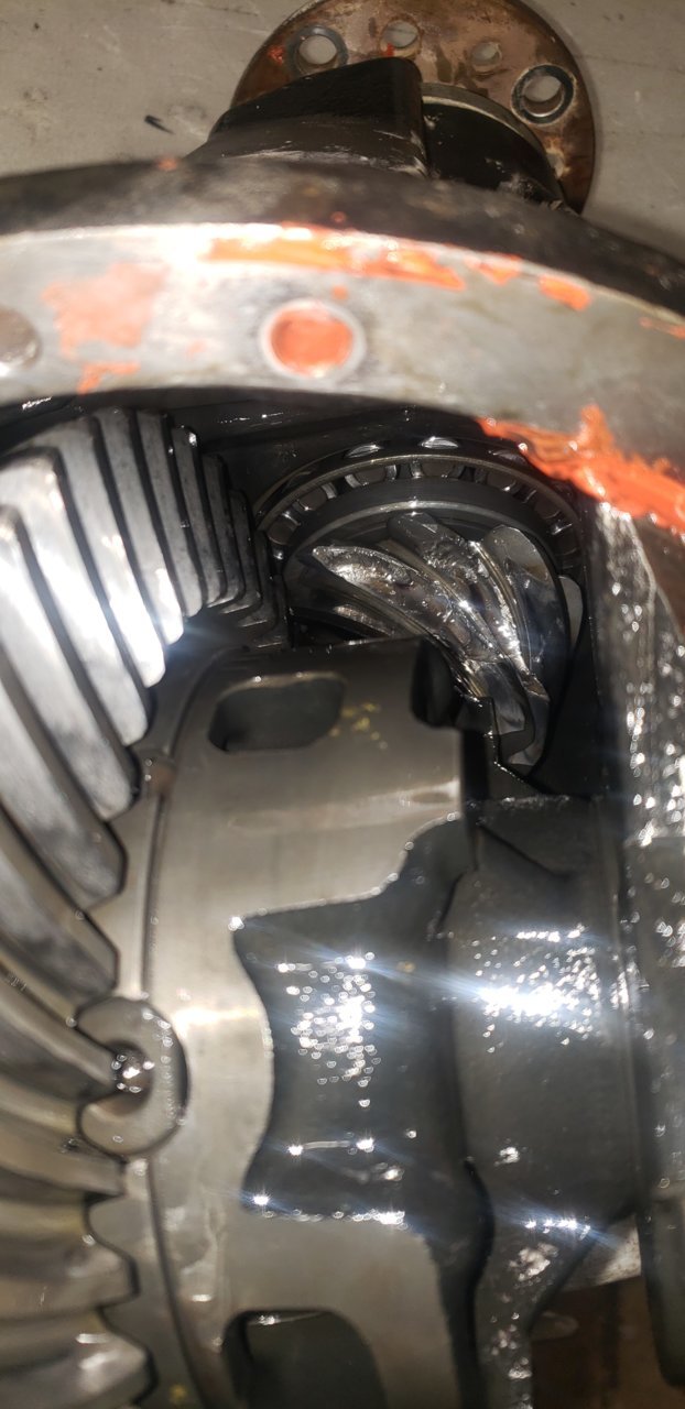

    Sure it’s not an axle bearing? They sure do sound like a bad diff. We put them in the air and run them to about 40mph and scope each side. They get LOUD on the tacos.

    Pretty interesting. Can’t say I’ve heard that kind of noise come from a diff.

    Ya, sounds like a Ujoint immediately. That or somethings binding and releasing

    U-joint or an absolutely whipped carrier is immediately where my head went. That kinda noise coming from a diff would surely show some form of play in the pinion. At least in my opinion.

    That was what I told him yesterday morning so he came to the shop and we put new u joints in... didn’t fix the problem

    Just sounds so much like a driveshaft. I’ve never heard a diff make that kind of noise. Crazy

    To me that clunk sounds like once per wheel revolution, not once per driveshaft rev. Obviously only under load

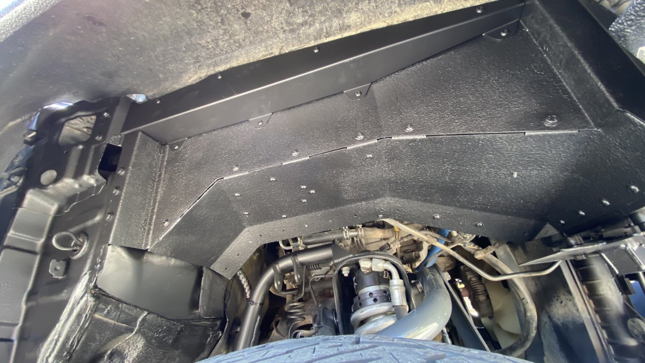

    Pretty much done. Passenger side stuff mounted up nicely. Overall extremely happy with the quality and fit of the JDfab parts especially since I don’t have a core support at all, I was easily able to make it work for my truck. Even without the top of the inner fenders not tied in yet it is still very strong.
    Used the old ABS module mount and it worked out like a champ.
    pretty much looks exactly as it was when I started.

    That sounds like DS speed more than rear. I've heard similar in a rear but it wasn't as consistent since it was from a chipped tooth it would skip sometimes and not make noise.

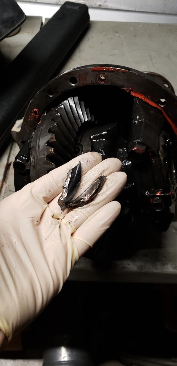

    I bet the diff has a broken tooth on the pinion gear.. Unfortunately I pretty much know what a broken ring gear sounds like as a opposed to a broken pinion gear on our 3rds. I just swapped in my spare diff a few nights for the same problem.
    This is my 9th maybe 10th broken rear since owning my junk.
    I've gone to the point that I have recently learned to rebuild them myself..

    this, that's why it clunks and why it's worse,. probably 2 broken teeth now.

    You did that on purpose to justify the new rear end didn't you...
