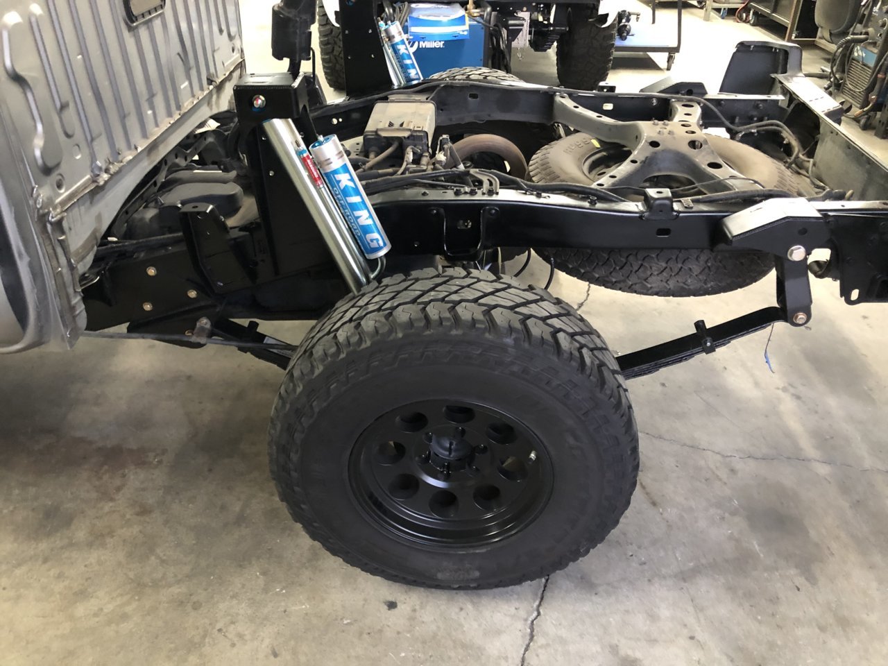

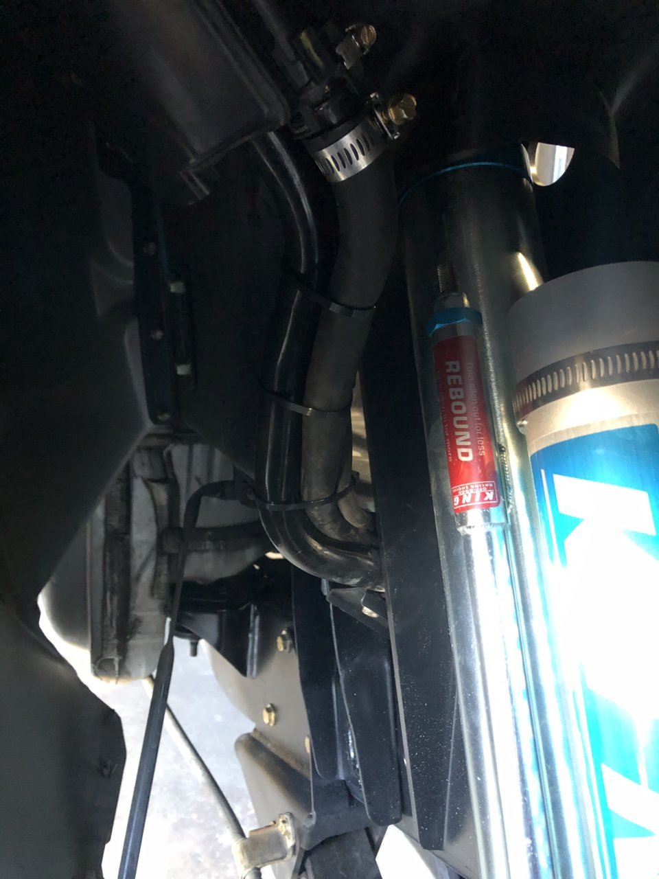

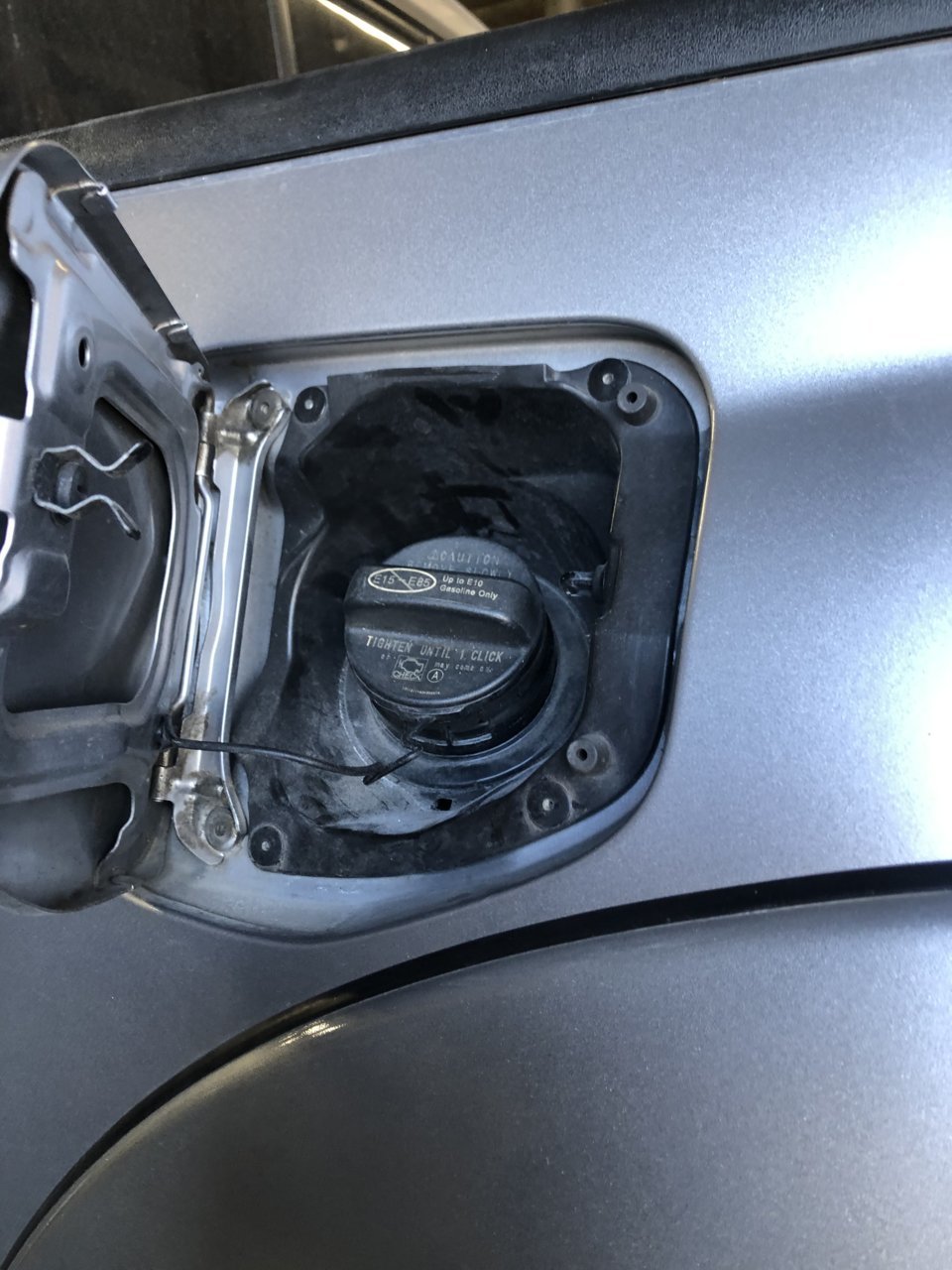

    Just wanted to update everyone... I just did the spring under kit on a long bed and will say it’s an easier job than the short bed. Also the gas fill relocation that the kits come with works better on a long bed vs the short bed

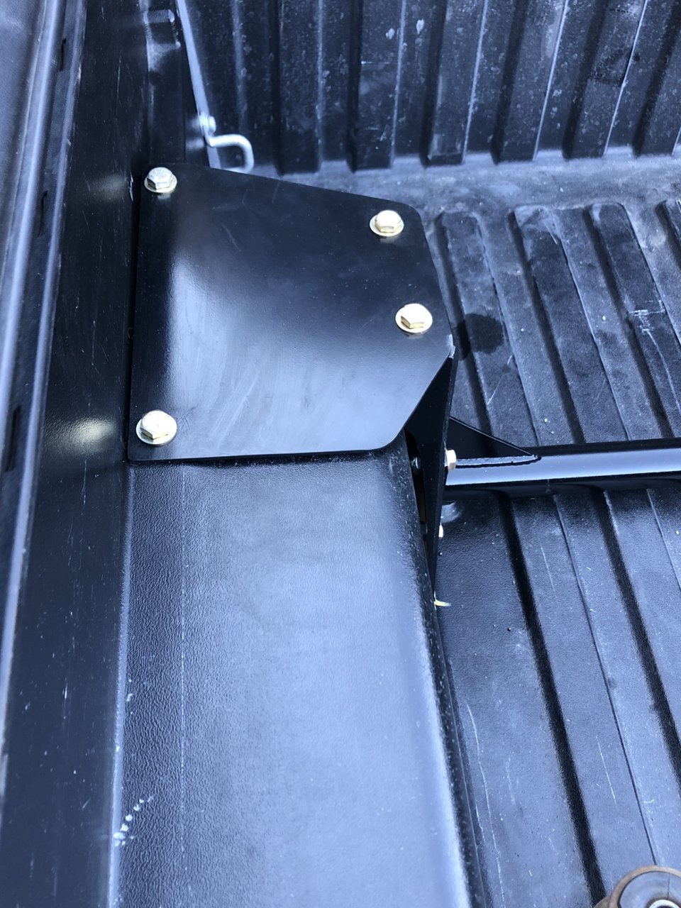

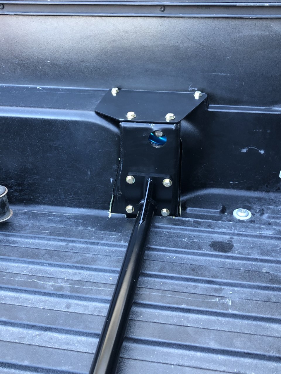

    Interested to see the bed cutout/cover plate for the sua Dclb kit.

    81Trekker [OP] Well-Known Member
    Aug 25, 2019
    #303299
    3,750
    La Jolla SD
    81 Trekker and 2015 CCSB Tacoma
    Too many to remember
    T.Barn, fr0stbytten, Mista_G and 10 others like this.

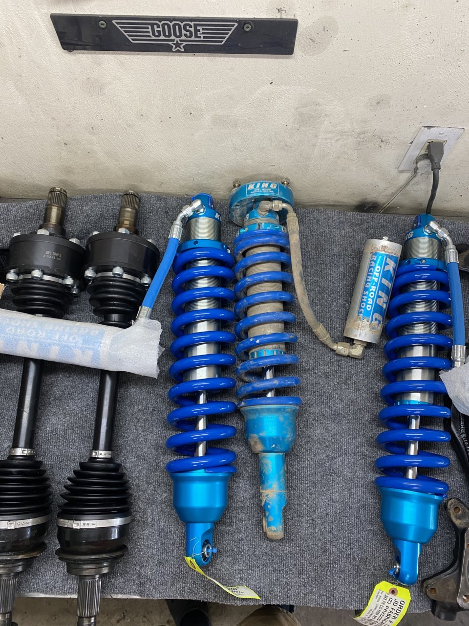

    For those curious, a side by side of the 8” coilover the +2.25 kit uses and extended length king. When I first laid them next to each other, I was honestly surprised at the similar length. Pair that with the fact the +2.25 kit only uses about 6.2” of stroke, that’s not far off of stroke of the ext king which is like 1/2” less than that IIRC.
    I wish I would’ve cycled with my oem king out of curiosity but I figured it would receive backlash for even suggesting not using an LT coilover.
