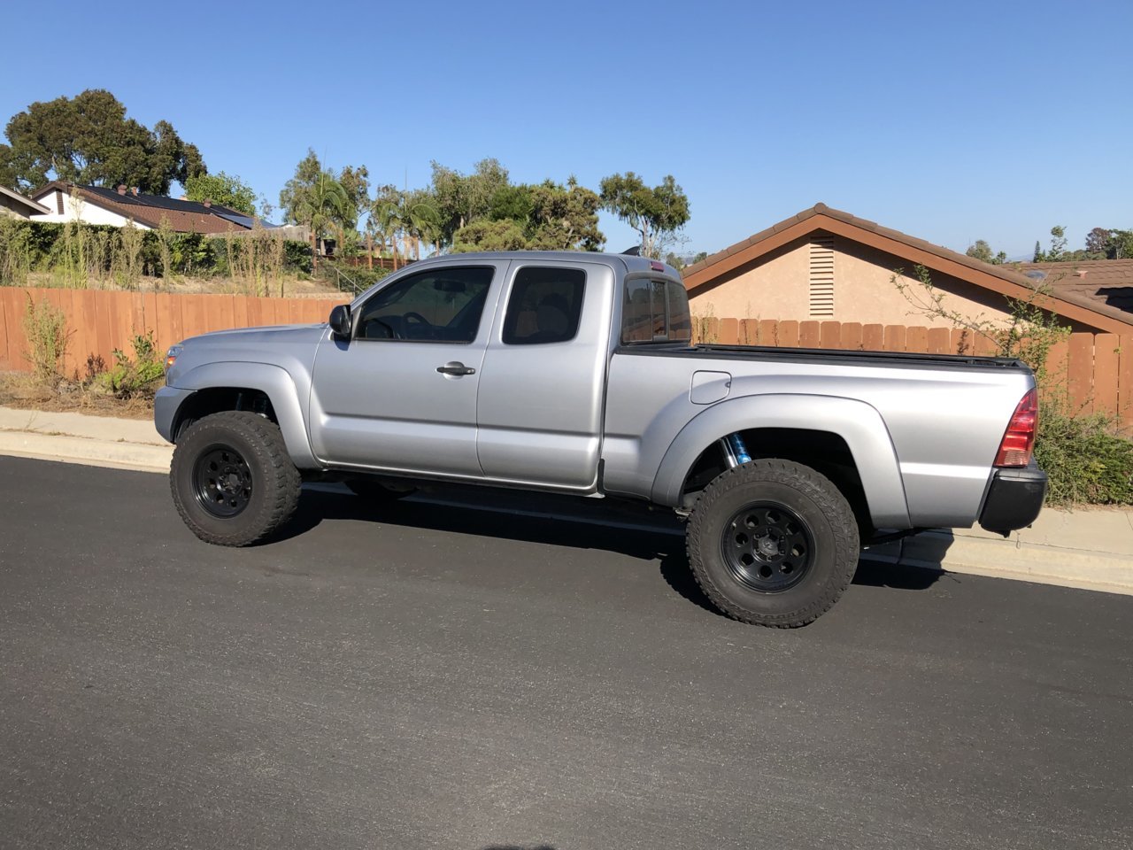

    I think this is my favorite taco yet... mid travel front with spring under rear on 285. Thing drives so nice and is such a sleeper! All it needs is a TC pump to be perfect

    What's the science behind having the shocks canted forward so much. Most gofast have them like that. Where we set them closer to vertical for what we do.

    I think it's just trigonometry, and how much travel do you want out of a given shock size...

    Math and science:)
    It’s so you can get 19” of travel out of a 14” shock. (Keeps the shocks under the bed)

    Maybe, I mean some "claim" that having shocks angled towards the center help with off camber and like body roll. I don't know if that's just old wives tails or if there is any truth to that.
    I just see it a lot on the go fast guys and almost never out here. So was curious as to if there was a reasoning for it.

    It’s definitely an interesting topic. Many crawler guys run them rearward which has always had peaked my interest as it typically runs less than a 1:1 ratio.

    That was my truck before I went with your LT front!! Only diff is I was on 315’s
