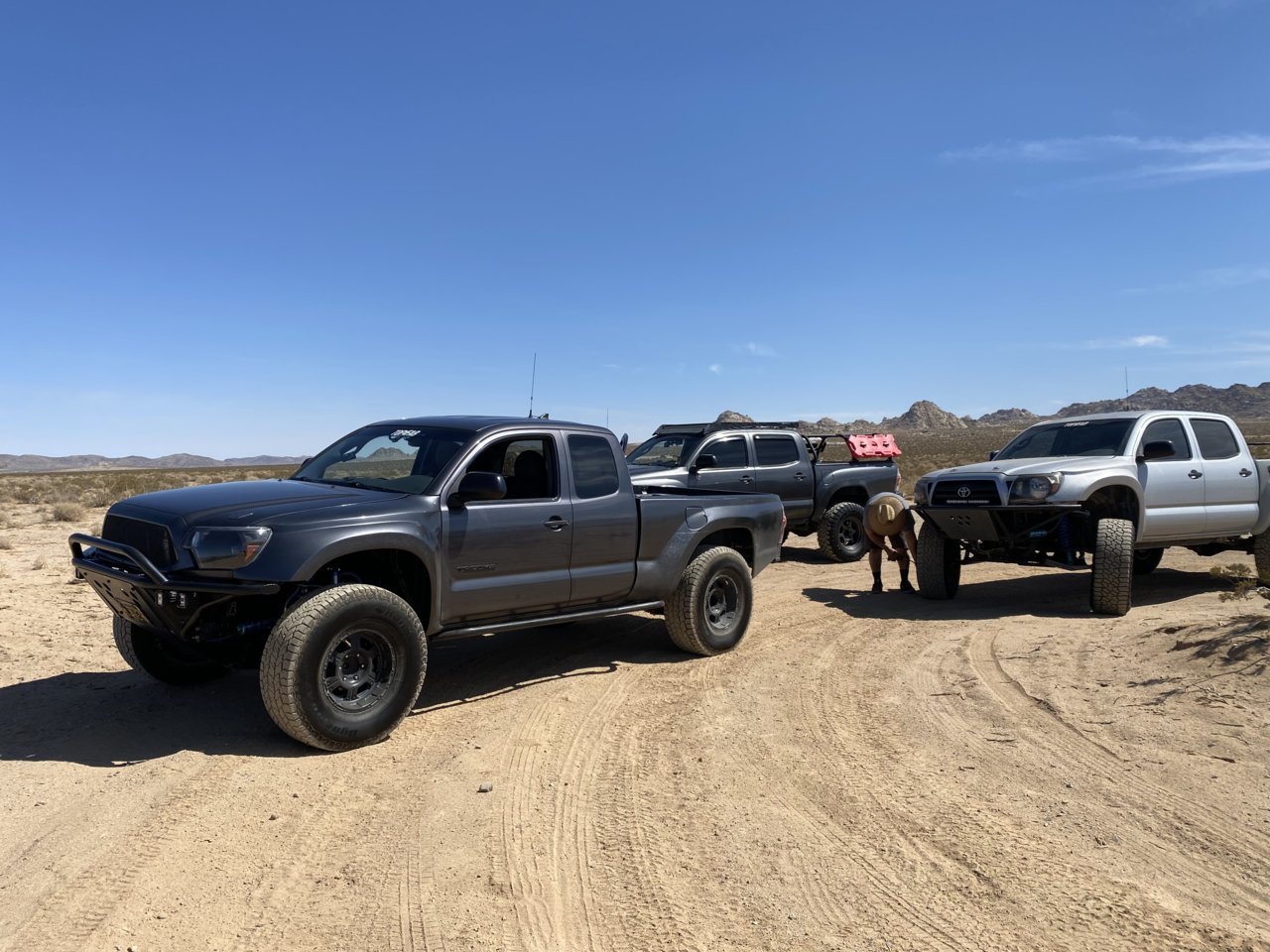

    https://www.tacomaworld.com/threads/airdogs-2012-prerunner-access-cab-slow-build.264263/
