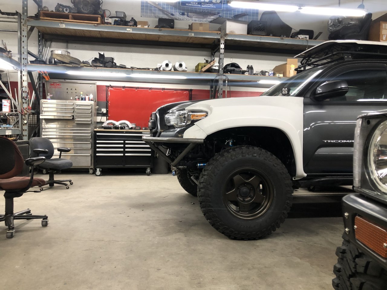

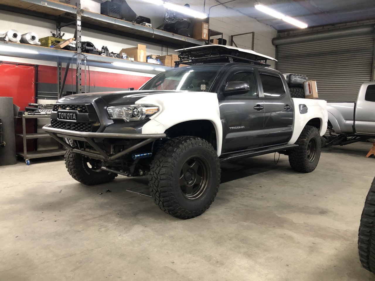

    Are these tubes welded straight to the frame?Looks like two tubes continuous tubes for the main and lower wing tubes? I’m trying to steal ideas for a bumper ;)

    I built a new cross member that’s welded to the front of the frame. Then tubes come down from the top to the new cross member and then all the way down to the LCA crossbar. I’ll take more pics when it’s finished off with the skid plate and valance

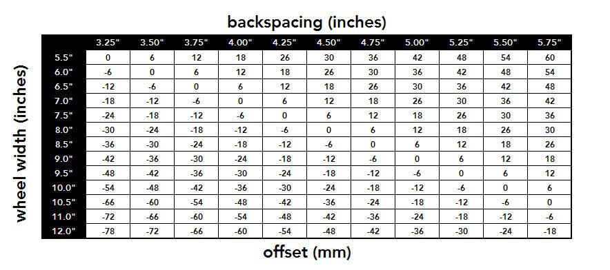

    Offset without knowing the wheel width won’t tell much. Backspacing would probably be a more helpful measurement. For what it’s worth, I have 4.5” backspacing on the LT kit and I’m as close as possible to the spindle gusset on 35’s. This chart has helped me a lot-
