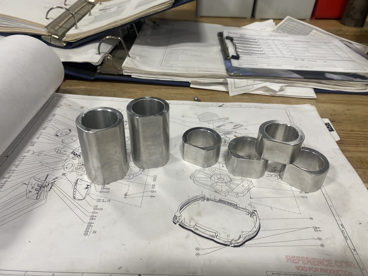

    Also going to be shortening my front bumps, what’s with the flat face on those spacers? I thought king/ fox used 1.5x.120 aluminum or cromoly tube for spacers?

    Ok so where does that spacer go for the bumps?

  15. Oct 8, 2021 at 3:28 AM
    #9715
    EatSleepTacos
    Mar 24, 2015
    #151688
    59,842
    Randy
    West Valley, AZ
    2017 4Runner
    Glad I’m not the only one wondering.

  16. Oct 8, 2021 at 3:29 AM
    #9716
    906taco
    906taco Well-Known Member
    Jun 22, 2021
    #369289
    3,926
    Cory
    08 Taco
    It goes internally around the bump shaft.
    Slashaar and Nimble9 like this.
  17. Oct 8, 2021 at 3:44 AM
    #9717
    ovrlndkull
    ovrlndkull STUKASFK - HC4LIFE
    Jan 7, 2017
    #206806
    37,785
    Skip
    Burlington, NC
    2005 DCLB Silver
    63s, XD Machete, Beat not Babied
    Then wouldn't that be limiting your uptravel by an inch?
    Slashaar likes this.
  18. Oct 8, 2021 at 3:48 AM
    #9718
    906taco
    Jun 22, 2021
    #369289
    3,926
    Cory
    08 Taco
    No, the spacer goes below the piston so it essentially drops out less. All it does is hold the shaft up higher in the body.

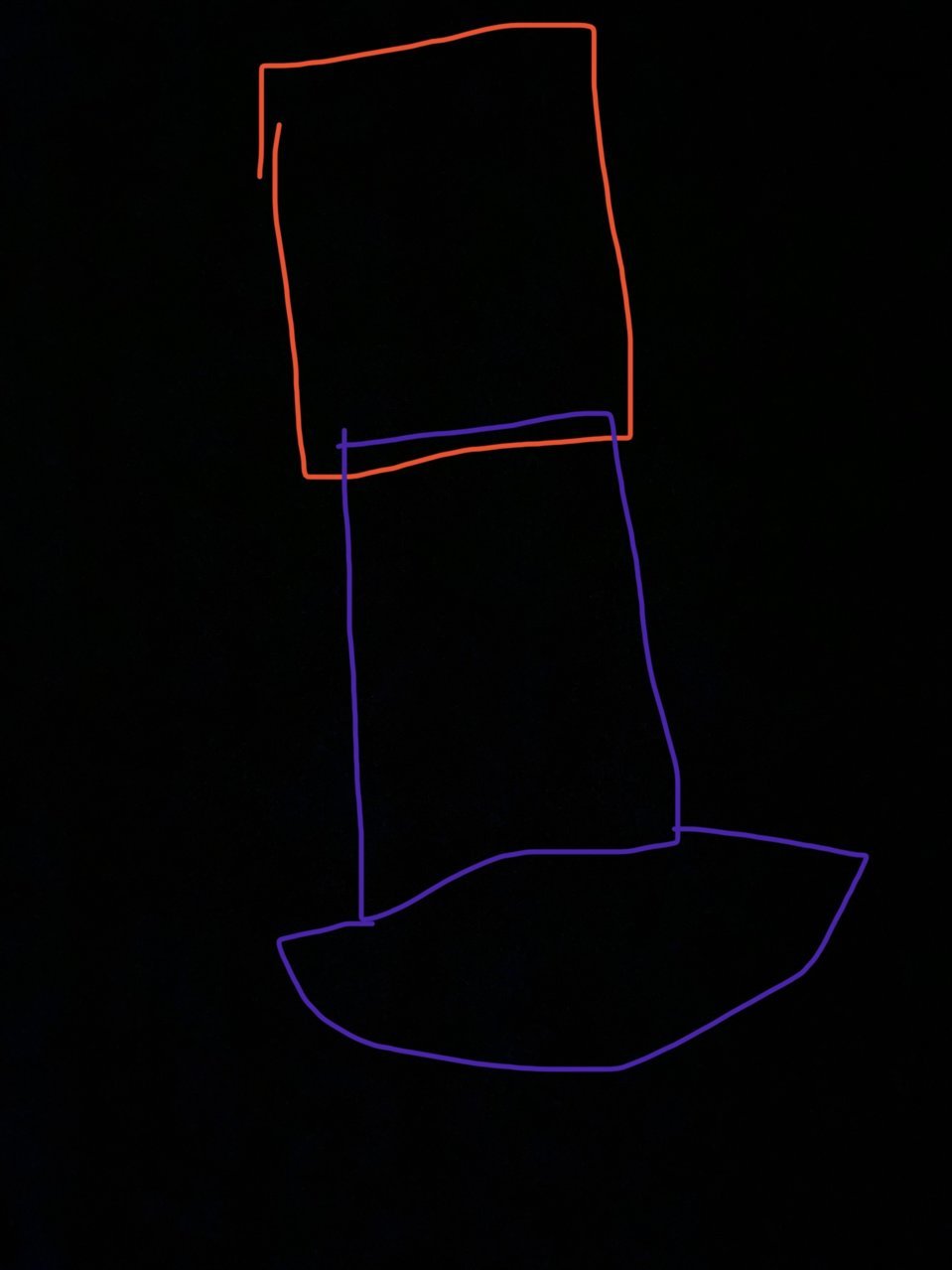

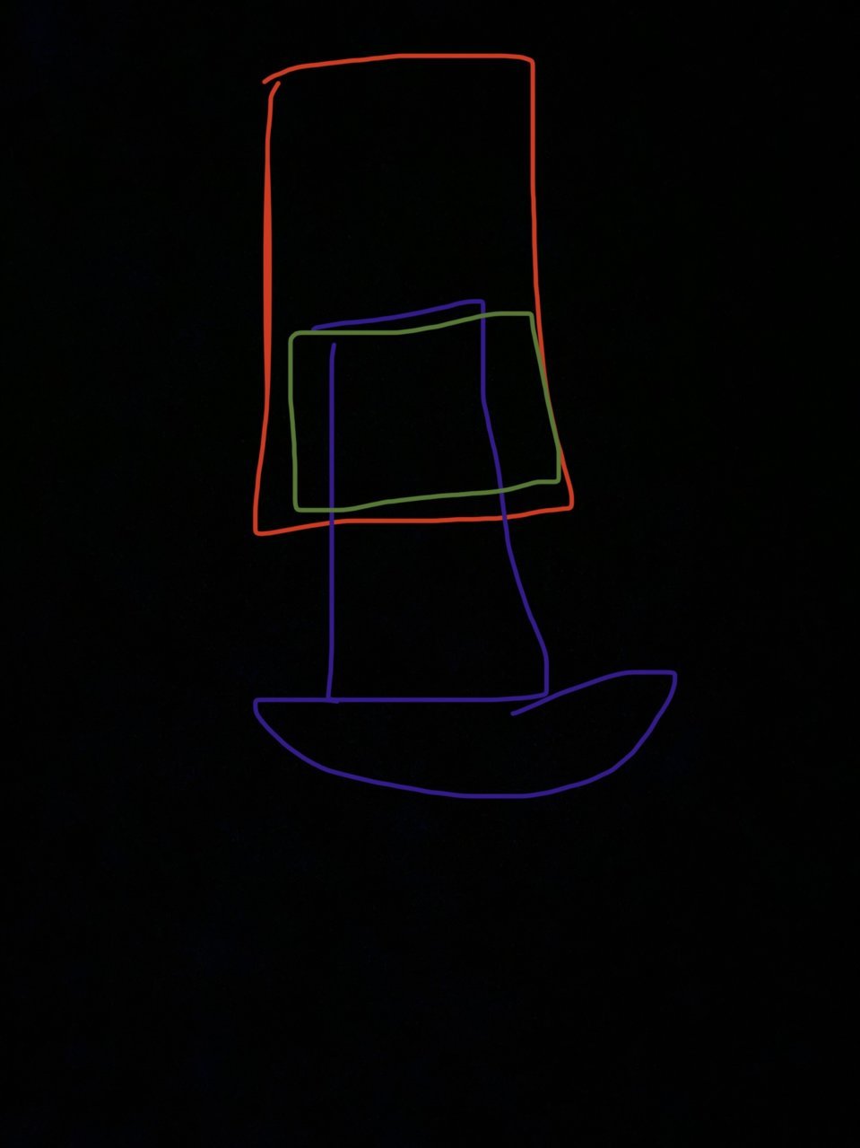

  19. Oct 8, 2021 at 3:54 AM
    #9719
    EatSleepTacos
    Mar 24, 2015
    #151688
    59,842
    Randy
    West Valley, AZ
    2017 4Runner
    I whipped up these CAD drawings of how I’m picturing it.
    5446C501-082F-45C4-9D90-B027961EFC78.jpg E37CD771-1A56-422D-B57F-2D3AC07EBA37.jpg
  20. Oct 8, 2021 at 3:54 AM
    #9720
    906taco
    Jun 22, 2021
    #369289
    3,926
    Cory
    08 Taco
    That’s correct. Beautiful drawing btw
