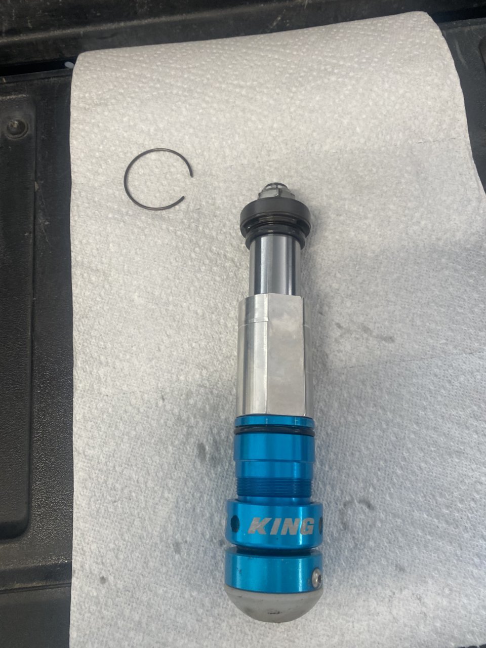

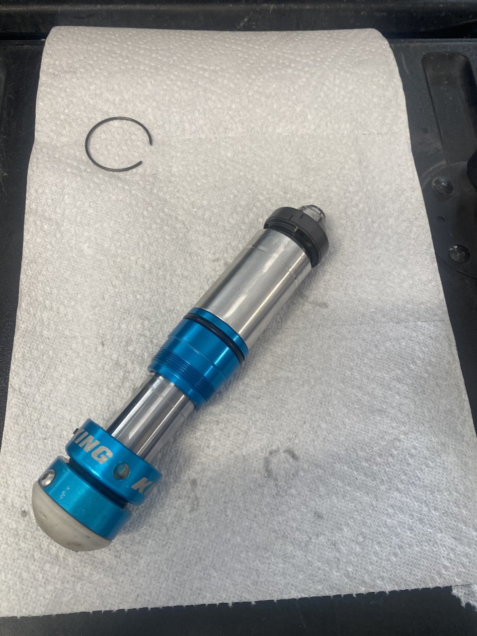

    The spacers I made are actually 2 3/4 inches long. The 4 inch bumps come with a 3/4 spacer stock. So I made the new spacer 2 3/4. Kinda like my 16 inch bypasses have a 2 inch spacer on them. On the long shocks and bumps they want some of the shock shaft inside the body to help decrease the bending moment at the very end of the shock shaft the spacer moves it down the shaft further.

    What's the purpose of the flat machined into the side?

    Well the original spacer had it. So I just copied it. But my guess is that it helps with oil flow around it or helps increase oil capacity. The spacer takes up real estate in there so it takes away oil capacity.
