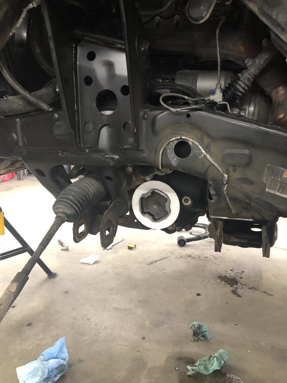

    Wait, 934’s with the stock front diff? Is that inner cv cut in half? Out of hand is an understatement and you have us all intrigued.
    Arcticelf and Taco-Obsessed like this.
  2. Mar 2, 2020 at 3:00 PM
    #962
    81Trekker
    81Trekker [OP] Well-Known Member
    Aug 25, 2019
    #303299
    3,750
    La Jolla SD
    81 Trekker and 2015 CCSB Tacoma
    Too many to remember
    yes 934 with the stock diff... using 934’s for a lot more CV angle. The end of the stock inner is cut off and a machined adapter flange is welded to accept the 934 instead of that crap oe thing that isn’t even really a cv. Axle plunge will now be done through the axle not the cv. The axle will also be longer now as the flange distance has been increased.

    The 934 conversion will be surprising affordable with your old cores.
    As for numbers the stock CV’s max out at 23 degrees and 934’s do 30 degrees all day long. Also the 934’s will allow for a longer axle with more plunge

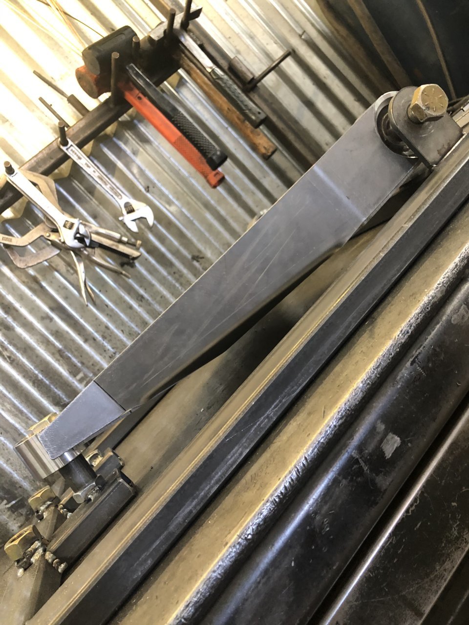

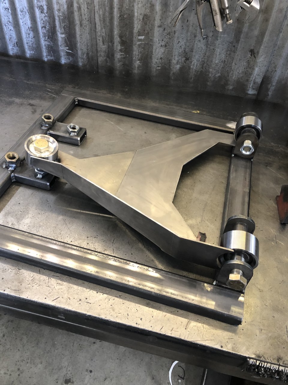

  16. Mar 3, 2020 at 10:59 AM
    #976
    81Trekker
    Aug 25, 2019
    #303299
    3,750
    La Jolla SD
    Just getting started... these arms have way more ground clearance than anything available and the front face of the arm is tapped to help the arm slide over rocks better.
    Working on the top of the arm as we speak, there will be a pocket built in that the CV sits in since the arms are so high clearance

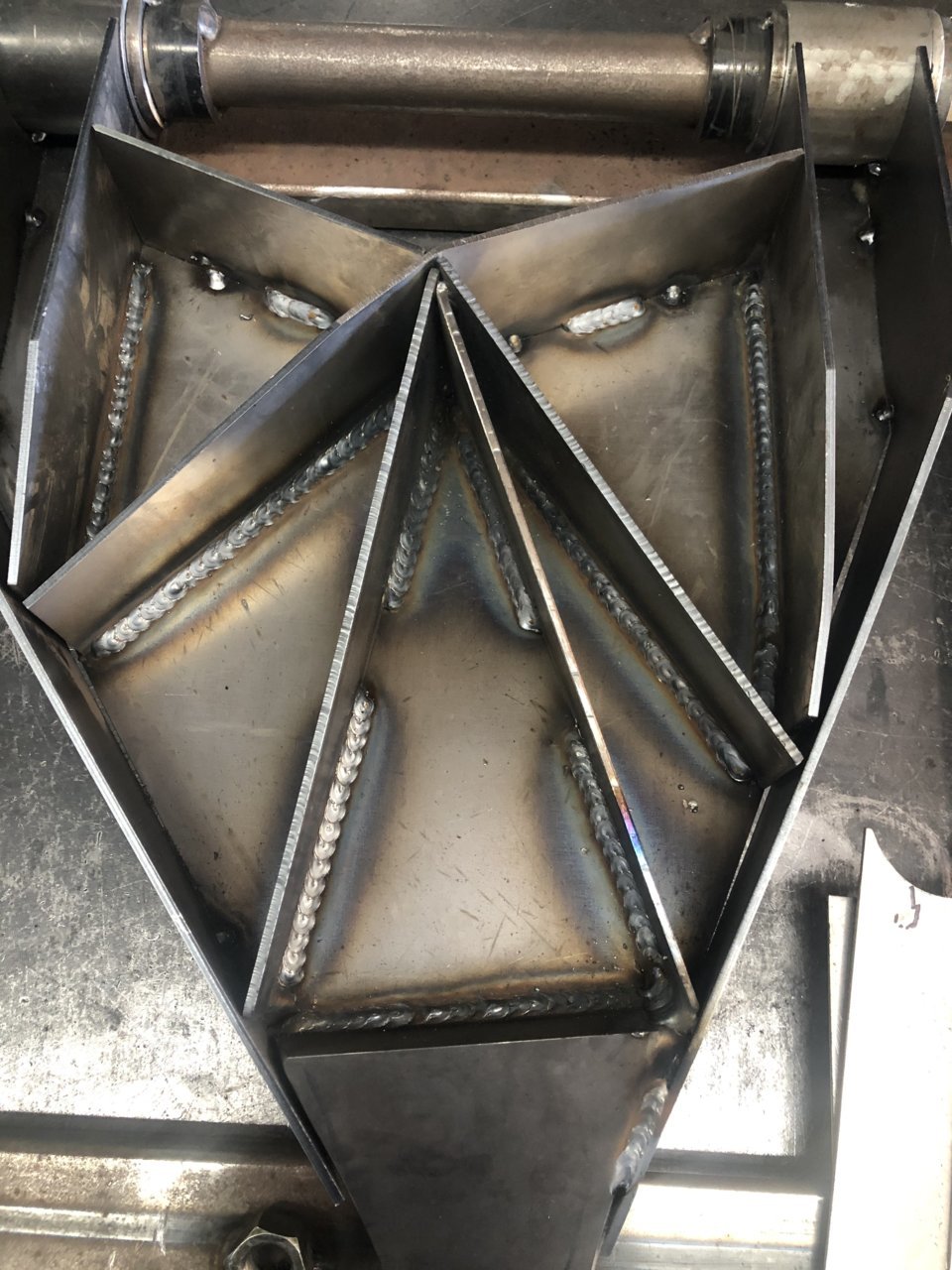

    #978
    sicki
    sicki Well-Known Member
    Jun 13, 2015
    #157339
    1,149
    lets see pics of the internal gusseting please
  19. Mar 3, 2020 at 11:41 AM
    #979
    81Trekker
    Aug 25, 2019
    #303299
    3,750
    La Jolla SD
    Working on it now but it will be similar to what I usually do...
  20. Mar 3, 2020 at 12:35 PM
    #980
    racebug68
    racebug68 Well-Known Member
    Apr 8, 2013
    #101660
    1,234
    Travis
    Chandler, AZ
    05 DCLB 4x4 TRD SPORT SILVER
    I can't leave anything well enough alone
    Oh boy, good stuff here.
    The questions I have: Will you be making arms with the explicit intent to use the tab relocation kit you sell, for moving 1" forward, or are you going to be making the arms with built-in 1" further forward? Also, I see two locations in the jig, is that for stock length and long travel, or long travel and extra long travel?
    What I want to buy: Stock length, high clearance LCA, 1" forward, with stock eyelets on the frame side (use bonded bushings or whiteline kit or standard poly kit, not something proprietary), and a ball joint or sealed joint (NOT UNIBALL) on the outer. I can deal with added caster myself and would not need an upper arm.
