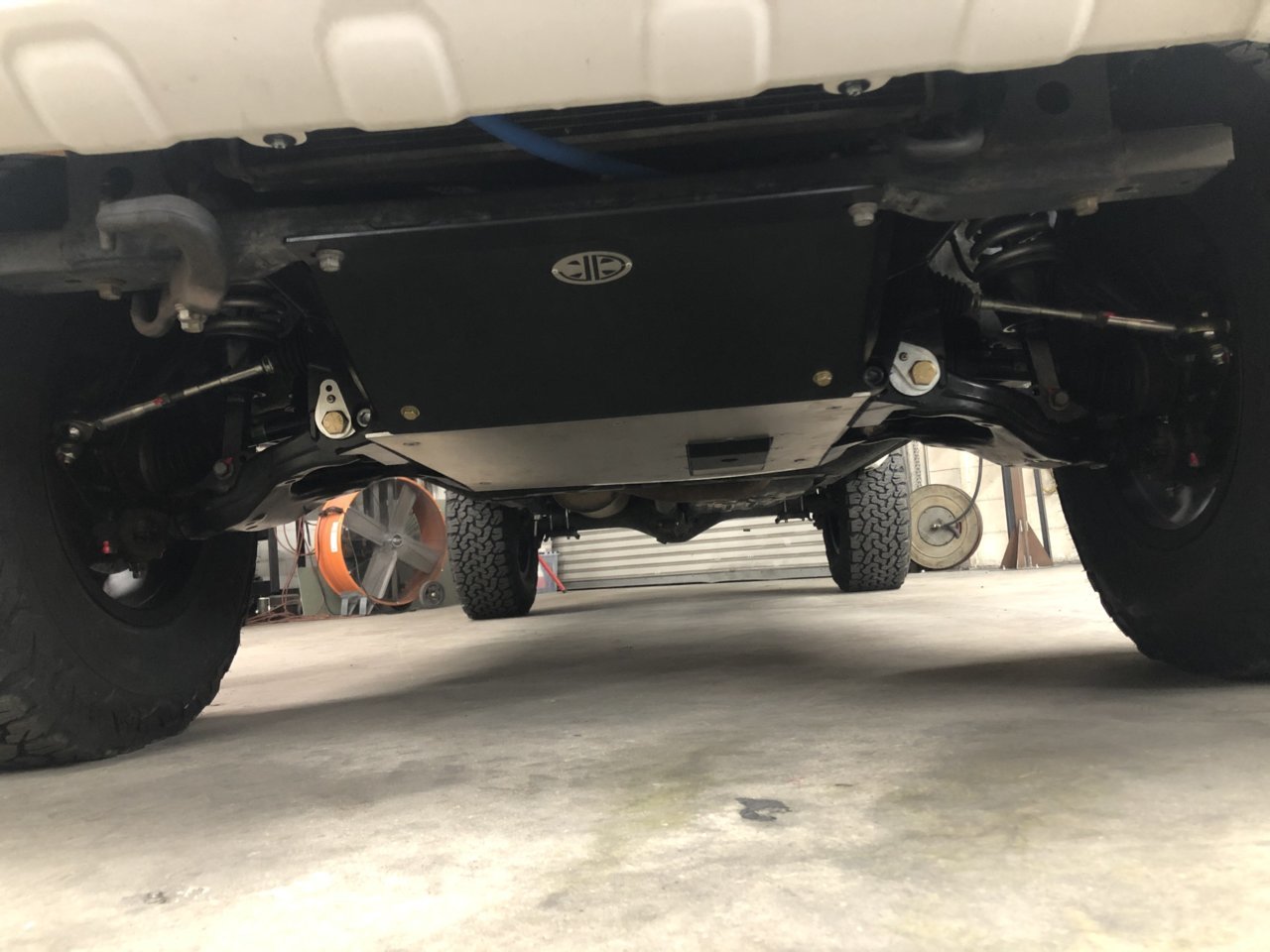

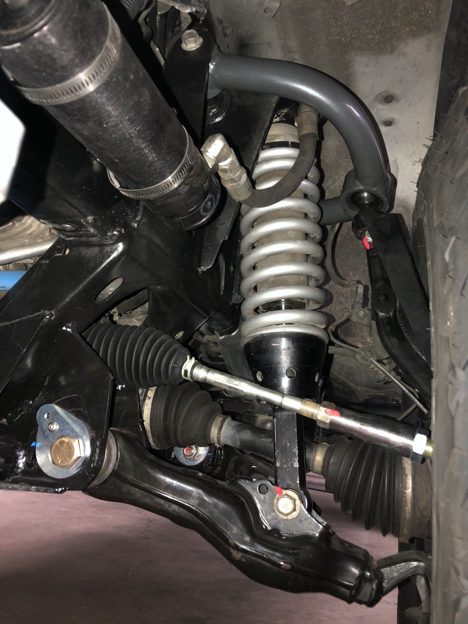

    Just did the LCA pivots, upper arms, spindle gussets, upper arm double shear, steering double shear, front skid plate, fox DSC all around, bolt in Deavers and the TC pump kit... all I can say is wow! The pump makes such a big difference and the truck is really enjoyable to drive now. Thanks @01 dhrracer for letting me do my thing on this one!

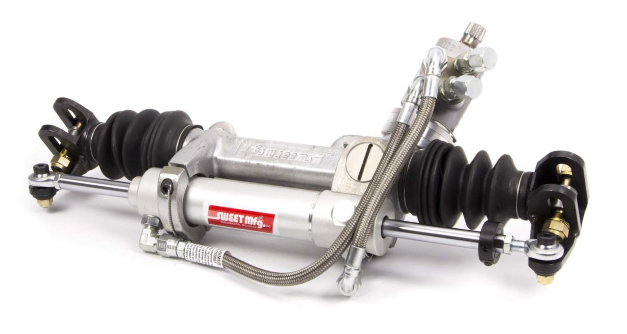

    So, in my brain storming of how to make this steering even better I had a thought. What if one were to replace the slide rack with a hydro ram? You could essentially have full Hydro while maintaining the mechanical link. You could theoretically block off the flow control lines to the rack and use the flow control valve as a servo for the ram. It would make the factory rack only partially power. Am I on something good today, or is this actually a legitimate idea?

    We already went down this road and the problem is packaging with the ram. You will have to cut out one side of the front crossmember completely in order to get the ram to stroke correctly. It gets to the point where you’re trying too hard to desperately make the rack work. If you want to spend the time and money to do it right put a steering box on the truck with a swing set in place of the rack and run the ram to the relay rod in front of the crossmember

    Just to make sure we are in the same page. Like this?

    Yes exactly and we even spoke with Sweet about making a specific rack for the Tacoma. There isn’t enough room for what’s available and making an entirely new custom setup was way too expensive. Again it’s just gets to the point where what are you desperately trying to save?
