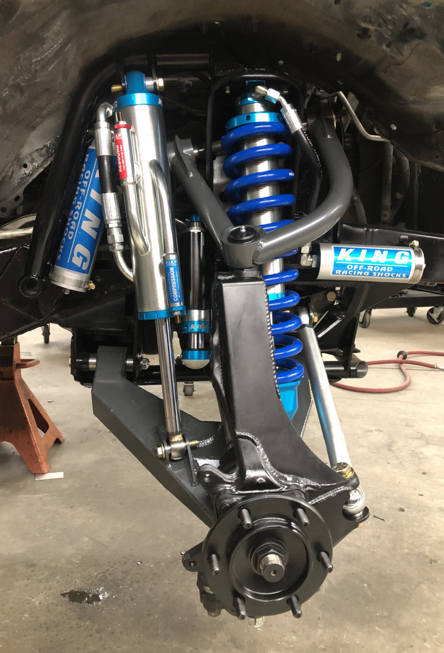

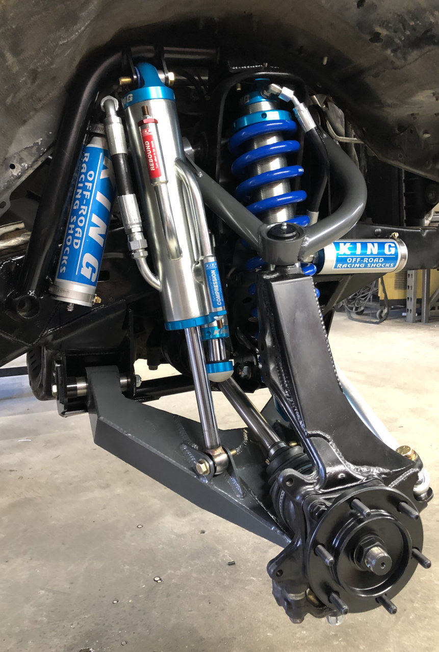

    At coilover max droop our clearance measuring tool was the King build out label off the shock. It is tight in there, I have the LCA pivots moved forward 1/2 inch. 2 spacers towards the rear. We are actually going to cut them off this weekend. I’m moving the pivots back 1/4 inch and we should have more room in a different position. I’ll take pictures this weekend.

    It’s tight but 3.0’s fit with the LCA all the way forward and this is with the 2.25 kit

    Hmm maybe I’ll leave it two spacers forward and try again first. I made a bad call on bump placement, we had room to go forward. But I went lazy and didn’t see how much room I had off the coils. I know at full bump I’m paper thin from the UCA and bypass too. I could probably mess with the alignment some now that I lowered my rear for some castor back. Also want to lower the front a tad. I’ll realign it first and see how everything clears with a new bump position.
