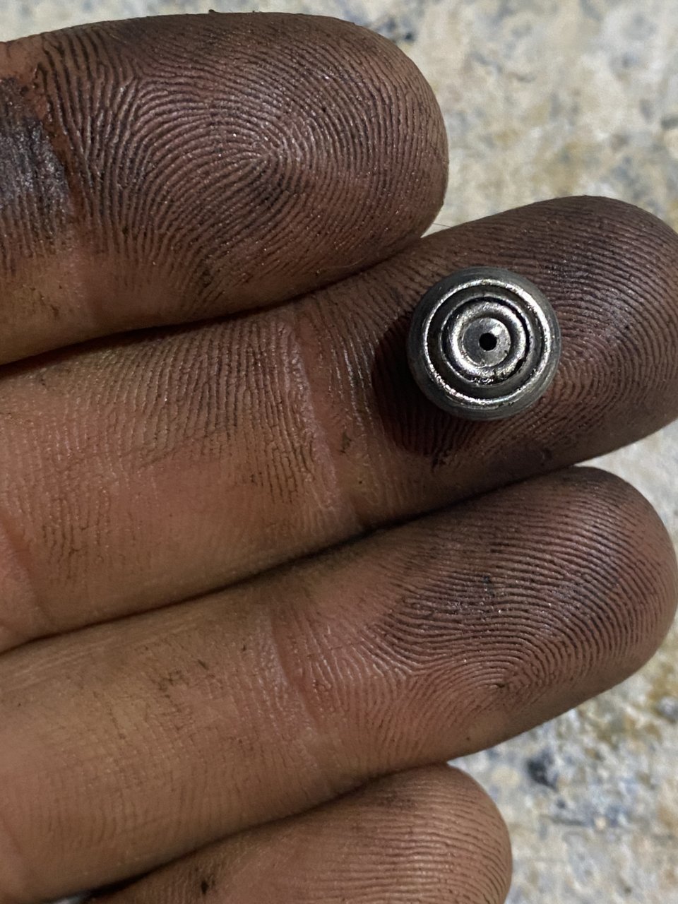

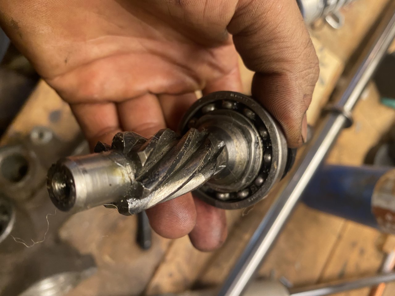

    A local heavy equipment place ordered me some double lip outer seals yesterday that I will be trying in the rack this time. They are meant for hydraulic cylinders that see far greater pressures than this rack ever will and also utilize a wiper. I feel pretty content trying that.
    However, I still want to find a way to seal up that drivers side better. There is still 2 bearings that are 100% open if that side is not booted. But we may have come up with an idea yesterday on that. Attached are 2 pictures of the bearings I am talking about.
    I really do want this slide rack to work out simply because it WORKS. It’s only lacking in a few areas, and if them things can be addressed, this will be the best option available.

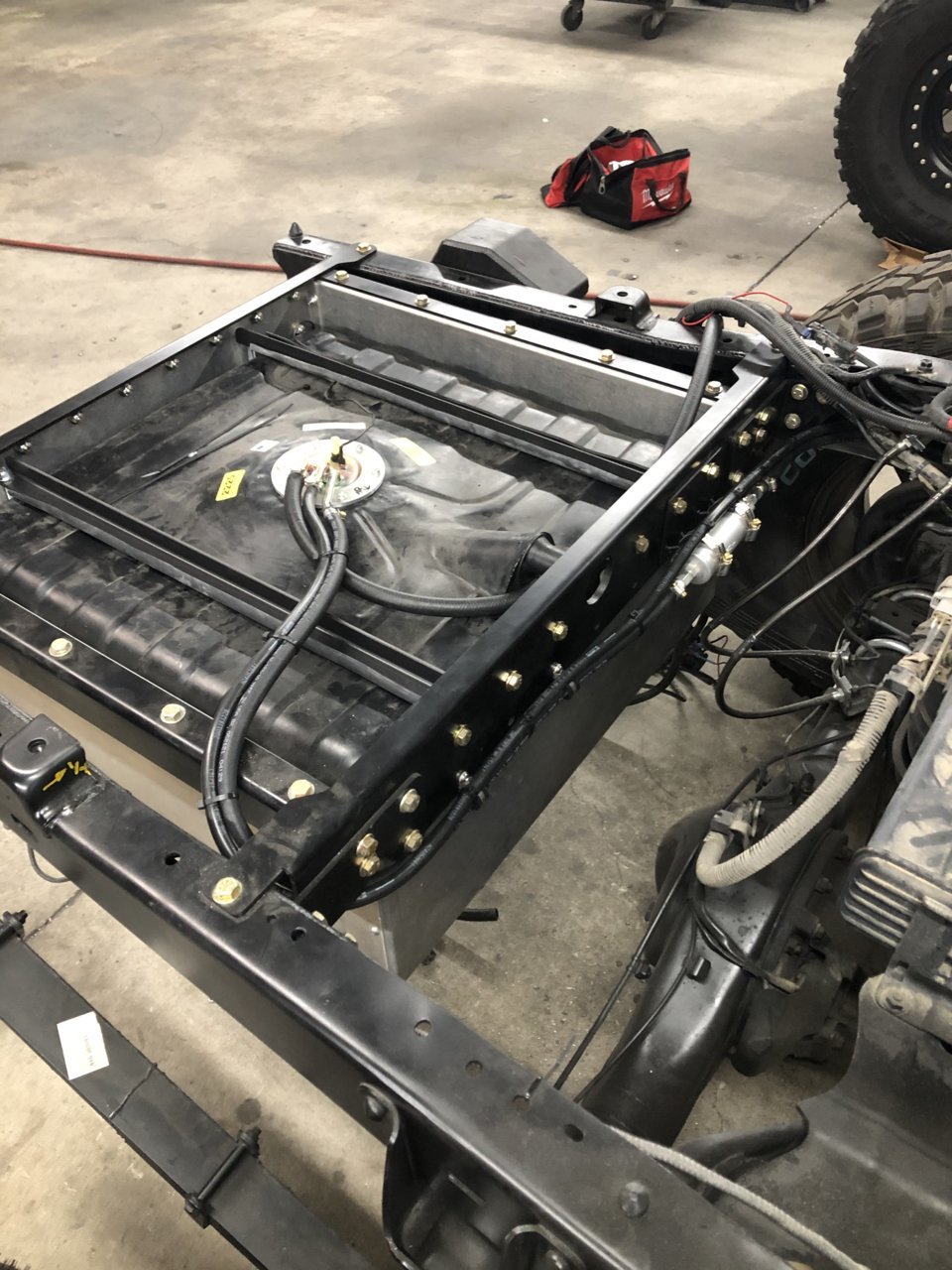

    Aux tank all plumbed in

    If you ever get the chance In the future id love to see both different size tanks side by side installed on 2 trucks to see how much lower the bigger one hangs

    3.5” lower

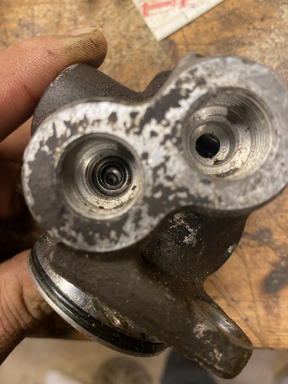

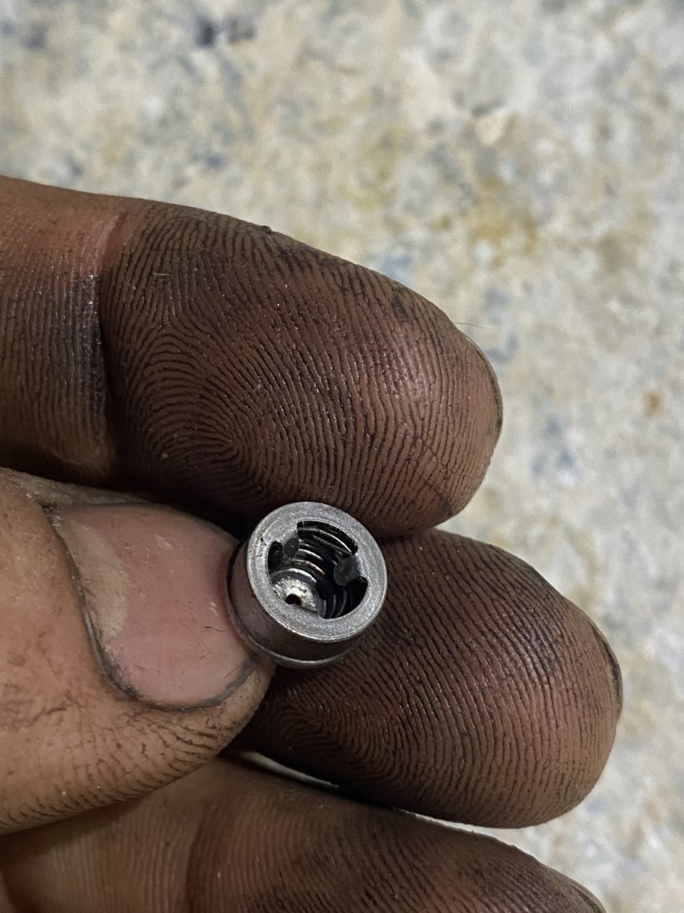

    I have lots of ideas, it’s just a matter of making them happen. After thoroughly dissecting the factory rack I firmly believe even more feedback can be removed. For instance, did you know there is a restrictor in the pressure side of the control valve? I’m betting there is lots to be had by simply messing with oriface size. OR by adding a flow control adjuster to the pump and eliminating the restrictor all together. You cannot tell me that factory restrictor is allowing full flow from that TC.
