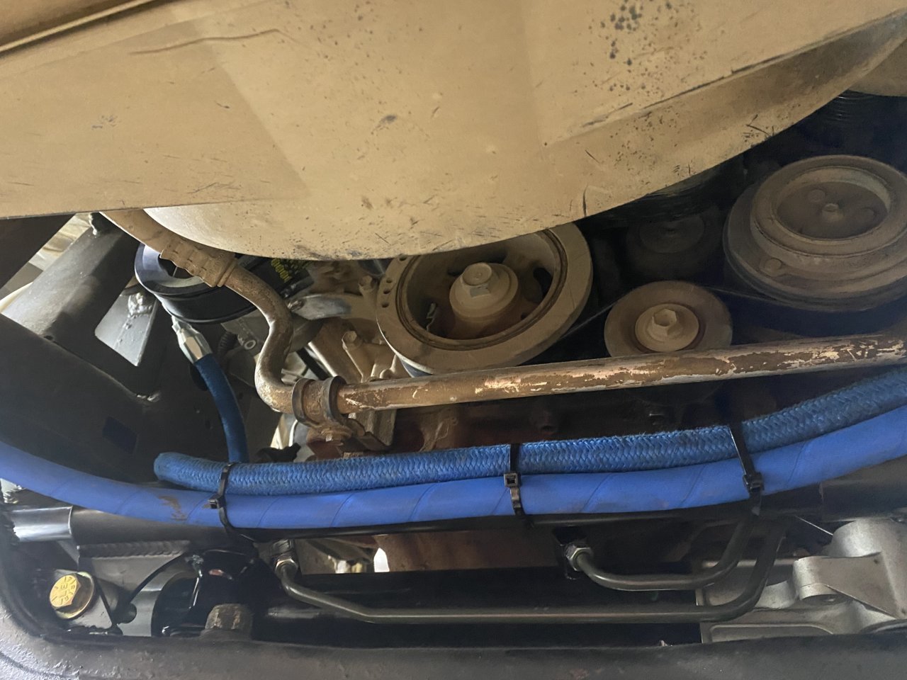

  12. Oct 18, 2021 at 12:16 AM
    #9912
    WormSquirts
    WormSquirts Armageddon
    Dec 18, 2015
    #172583
    2,487
    Braeden
    BC
    I think my kit came with a hose that was too short from the cooler to the rack. The longest was only 36" and it had to stretch kinda weird under my rad. Would have preferred to run it across with the high pressure line and then up to the cooler.

  13. Oct 18, 2021 at 4:55 AM
    #9913
    906taco
    906taco Well-Known Member
    Jun 22, 2021
    #369289
    2,426
    Cory
    08 Taco
    That’s pretty much how I have mine ran. Splits off at the frame and runs to the cooler.

  15. Oct 18, 2021 at 11:29 AM
    #9915
    WormSquirts
    Dec 18, 2015
    #172583
    2,487
    Braeden
    BC
    There's no chance mine would reach like that. It had to go basically straight from the rack to the cooler. Looking at the kit pictures from the other guys they had one bigger loop and mine had all shorter lengths. Unless I'm missing something really easy

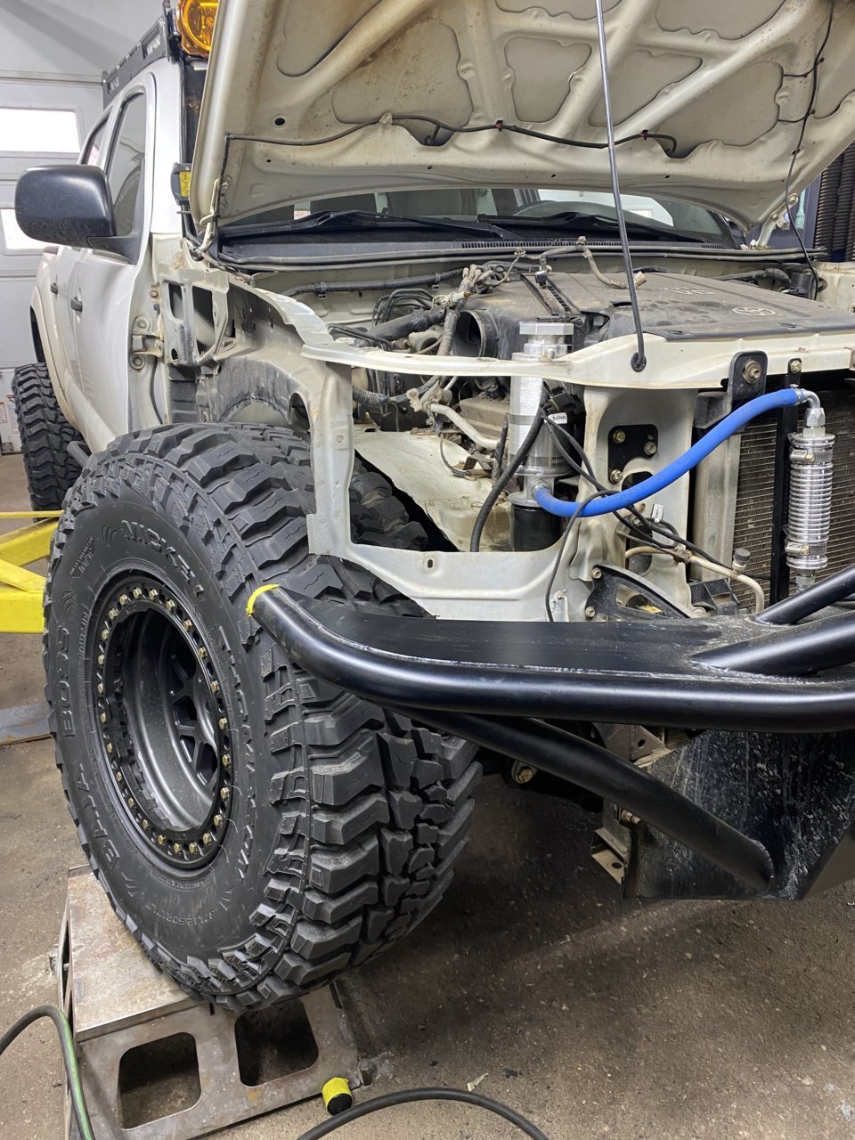

  16. Oct 18, 2021 at 2:59 PM
    #9916
    906taco
    Jun 22, 2021
    #369289
    2,426
    Cory
    08 Taco
    How did you run your line from the cooler to reservoir? Maybe that run was too long and that’s what made the second piece too short? If I recall, I only had to cut the return line once. I installed the fittings and found the shortest cleanest route I could and cut to the exact length needed. This is how mine is run from cooler to reservoir.

  17. Oct 18, 2021 at 3:02 PM
    #9917
    WormSquirts
    Dec 18, 2015
    #172583
    2,487
    Braeden
    BC
    Mine looks like yours. I got 2 chunks that were basically the same length within a couple inches, so I cut the shorter one for the cooler>resi, then used the longer one for rack>cooler.

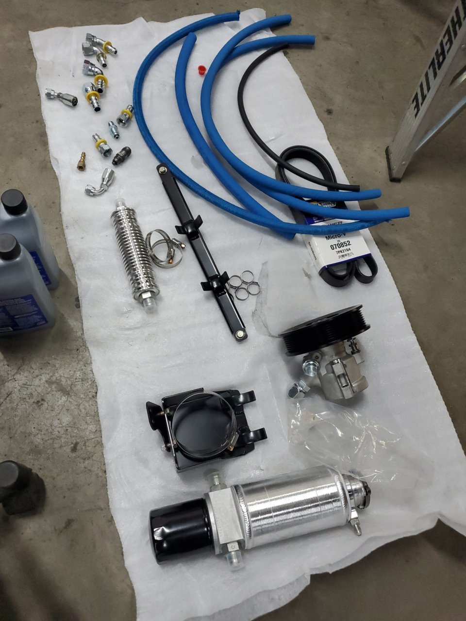

  18. Oct 18, 2021 at 3:06 PM
    #9918
    WormSquirts
    Dec 18, 2015
    #172583
    2,487
    Braeden
    BC
    Here's a pic I had on my phone pre-install. I also didn't receive that nice 90° fitting for the overflow. No big deal though

  19. Oct 18, 2021 at 3:06 PM
    #9919
    906taco
    Jun 22, 2021
    #369289
    2,426
    Cory
    08 Taco
    I know I saw one other that it was ran under the radiator. If I’m recalling right, my hose came as one piece and I had to cut it.
