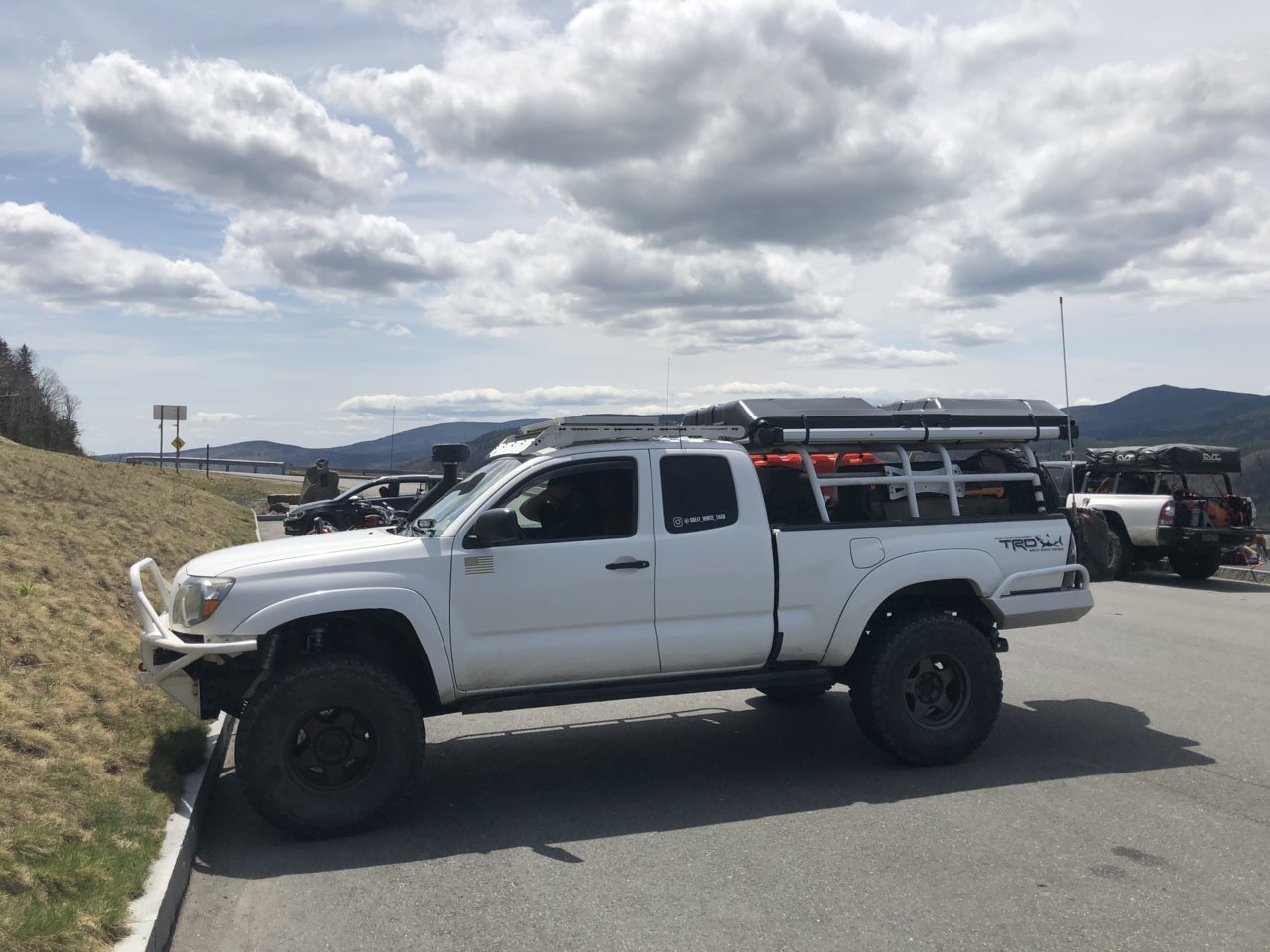

    All i did was pinch weld, trim front fenders/flares 2", and 3" lift, for the front. Nothing fancy in the rear
    I also have a front bumper and UCAs.. but that comes with the build.
    Yossarian and jp_flynavy like this.

    Truck looks really good but my question is how much drop out do you have at ride height? I’m trying to have the truck sit lower to keep the CV’s happy and have a decent amount of drop out
