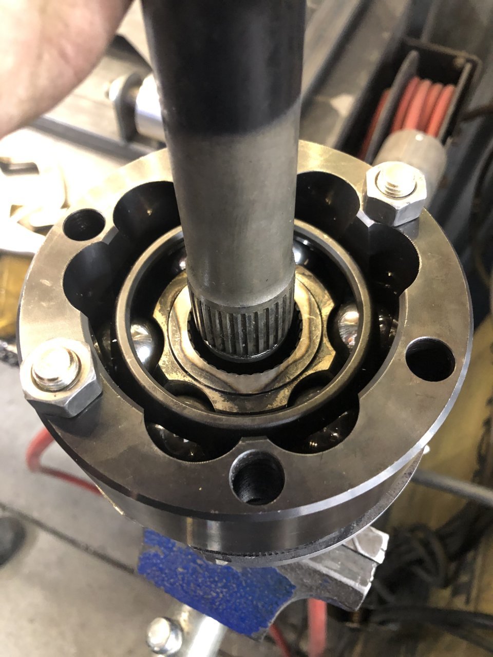

    934 CV adapters almost done!

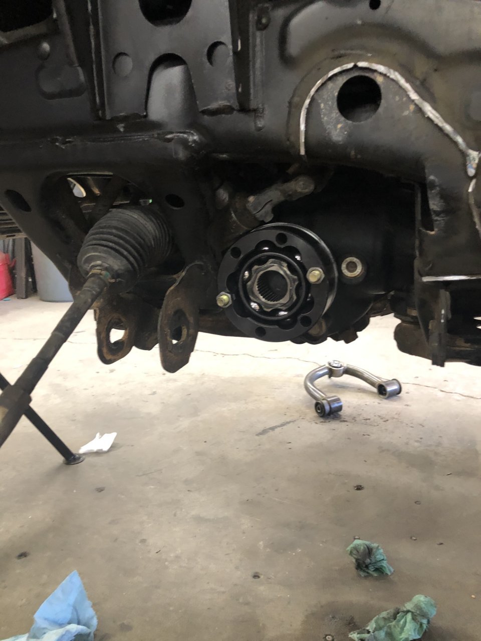

    It’s a tight fit but the 934’s will fit on a stock Tacoma!

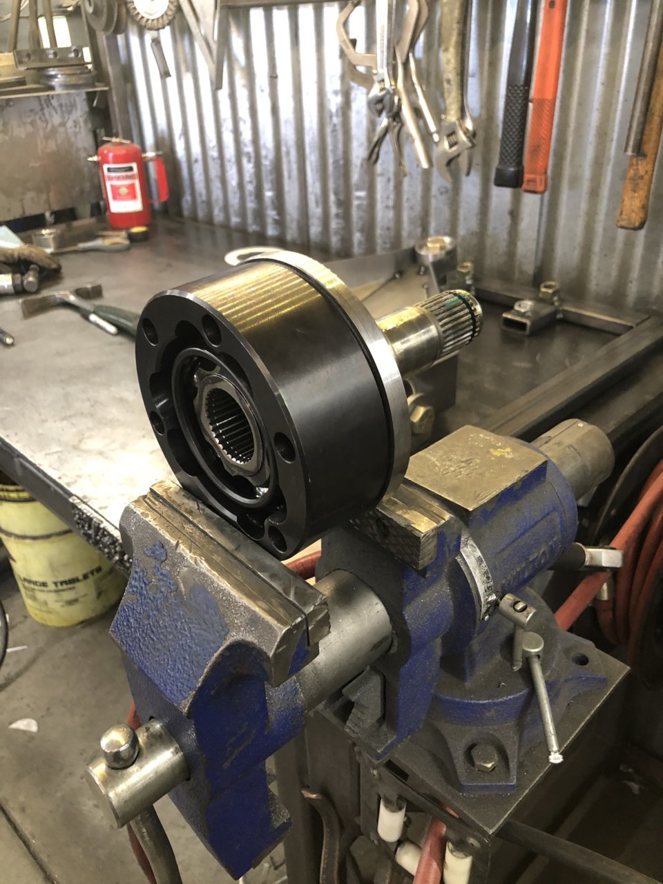

    The new axles will be waaay bigger than OE

    934 vs OE
    There is no comparison!!!

    These will hold up just fine with 300m axles, hydro steering and an ARB locker :)

    We may need to talk. I’m confident in some diy if it can be done without too many special shop tools. Is that front diff in the oem location still? That’s a tight fit, and I’d fear of clearances at the lca with that 934 cv on the outer with a stock spindle. But even taking this idea to some 33 spline 930 cv’s and 300m axles will be way stronger than what I’ve got currently.

    The front diff is in the stock location in the pics and the CV easily clears the arm because the CV is way more in board than the stock CV. This is not a diy job, a lathe and laser/water jet is needed along with some skill :)
