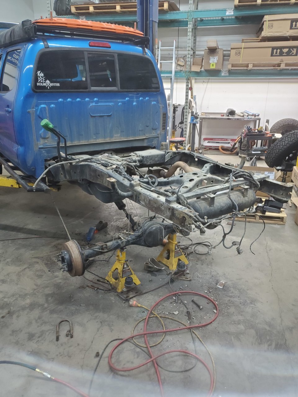

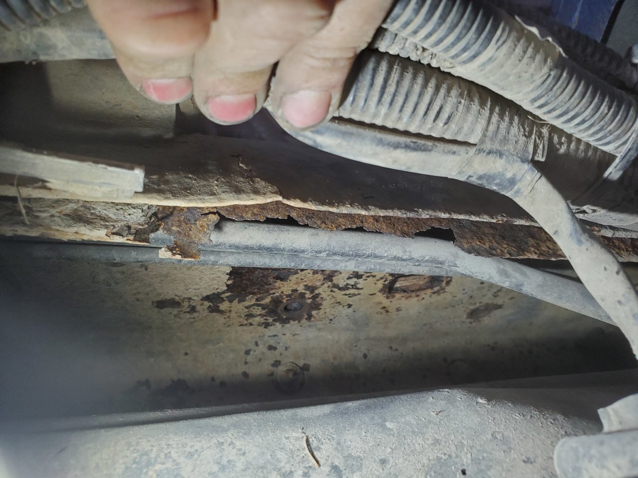

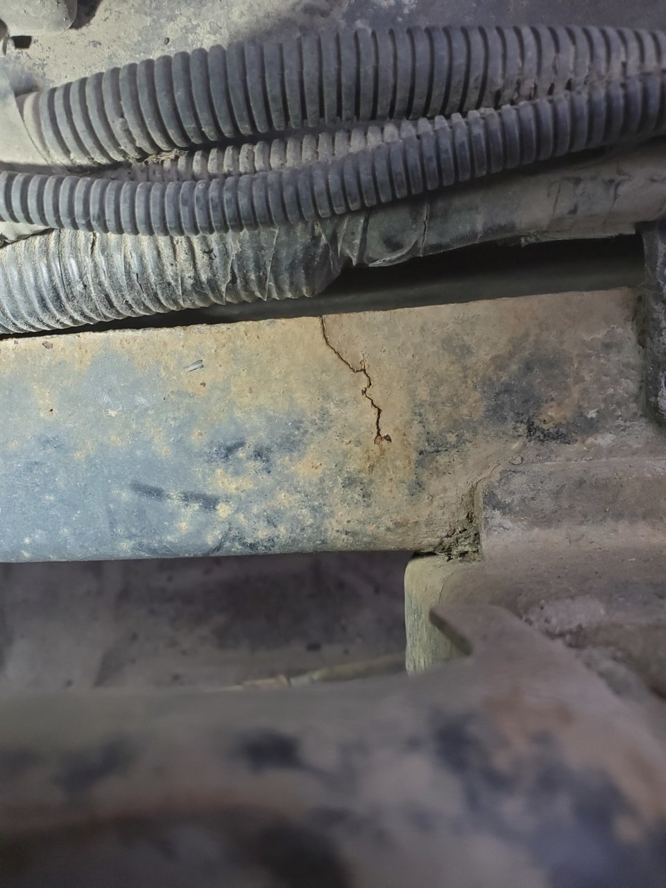

  20. Oct 24, 2021 at 3:21 PM
    WormSquirts
    WormSquirts Armageddon
    Dec 18, 2015
    #172583
    2,871
    Braeden
    BC
    Well I'm finally doing the Sua. Took 2 of us 3 hours to pull the bed, cut off and smooth out all my welded on 63 swap crap, and get the rivets out.
    Unfortunately also found this...
