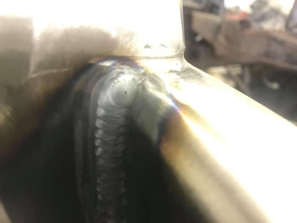

    I've been welding on an amateur level for a long time and part of what's holding me back is my old Lincoln MIG welder and its inconsistent wire feed speed. I'm not brand loyal to Lincoln but a PowerMig 260 or a Miller 252/255 are high on my list. The ESAB Rebel multiprocess line has caught my interest for a while now, too, as it'd be great to learn to TIG. I've got access to 220V and land/farm/heavy machinery so the welder would see 1/2" from time to time. What are y'alls thoughts? You can PM me to keep things sano here if necessary. Thanks!

    255’s are complete junk as they are inverter based and the 252 is probably the best mig welder ever made. For tig I like the dynasty 280 but be prepared to spend $10k with it all set up

    I've heard that about the 255 from you before and Jesse mentioned his dislike for it in a JD video as well. Really good to know. Thanks.
    There's a well used 252 for sale near me that I've been eyeing and your response will push me to enquire. Thanks for the heads-up, Harry.

    I strongly dislike any Miller inverter mig welder for that matter, the only good mig welder they make anymore is the 252. I’m also very picky and have spent thousands and thousands of hours welding so I notice subtle differences most people probably won’t

    I've seen your welds and your work which is precisely why I'm thankful you responded. :bowdown:
