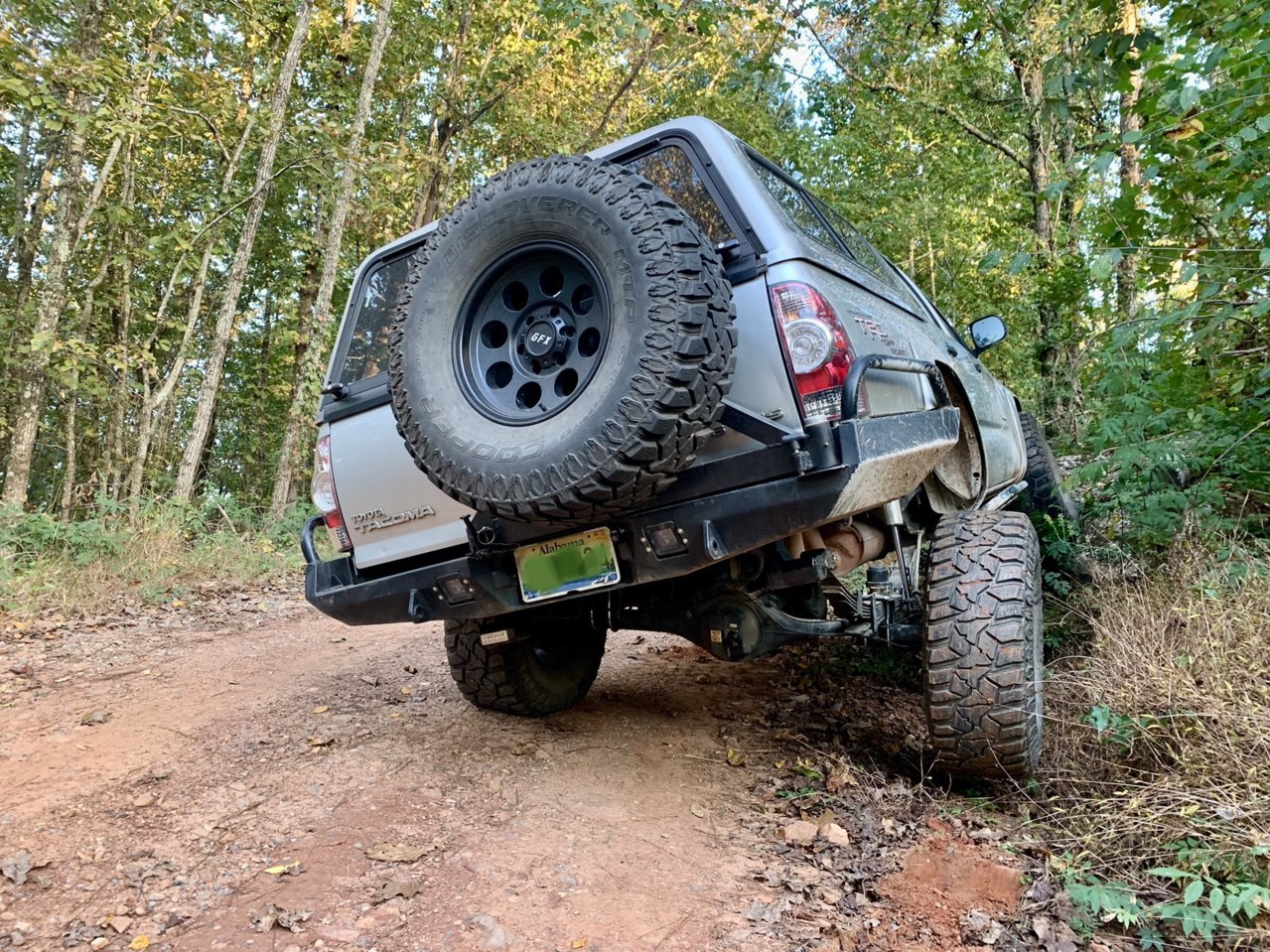

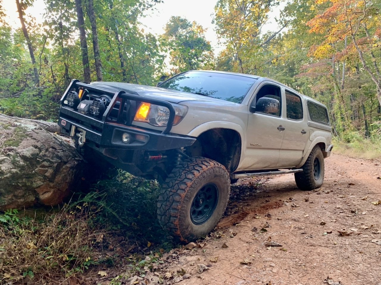

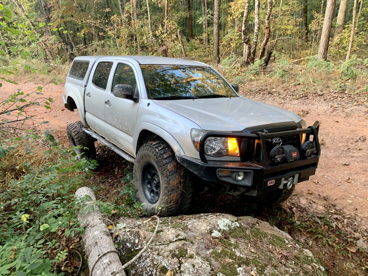

    The JD Fab driveway killer. Thought I would flex it out after work so I found the biggest boulder I have and double locked and drove until I thought I’d flip. Finally got the limit strap taut. Also, really starting to look like fall at the homestead.
    3B537CB0-7555-45D7-B228-1A55B6F14433.jpg B5F49945-A568-420B-A247-F32437E8A883.jpg AEB8F471-2E30-41B1-855A-51F930898AB8.jpg 15EA229D-9CE3-4364-A5D9-A5F18CBF32CA.jpg
    DoulosXP, T.Barn, Slashaar and 2 others like this.
