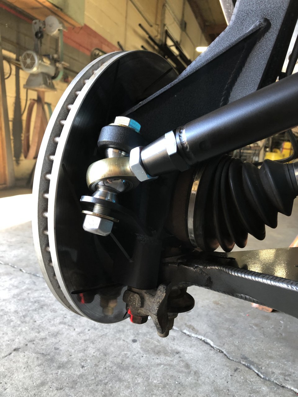

    Just did a full over haul on this thing with custom delrin bushings for the lowers, lower pivots, custom double shear, custom cromoly tie rods, slide rack and TC pump

    What do you think about that camburg spindle?

    Huge waste of money and in order to double shear you have to grind powder coat off and then make custom tabs. I’d much rather gusset a stock spindle for $100
