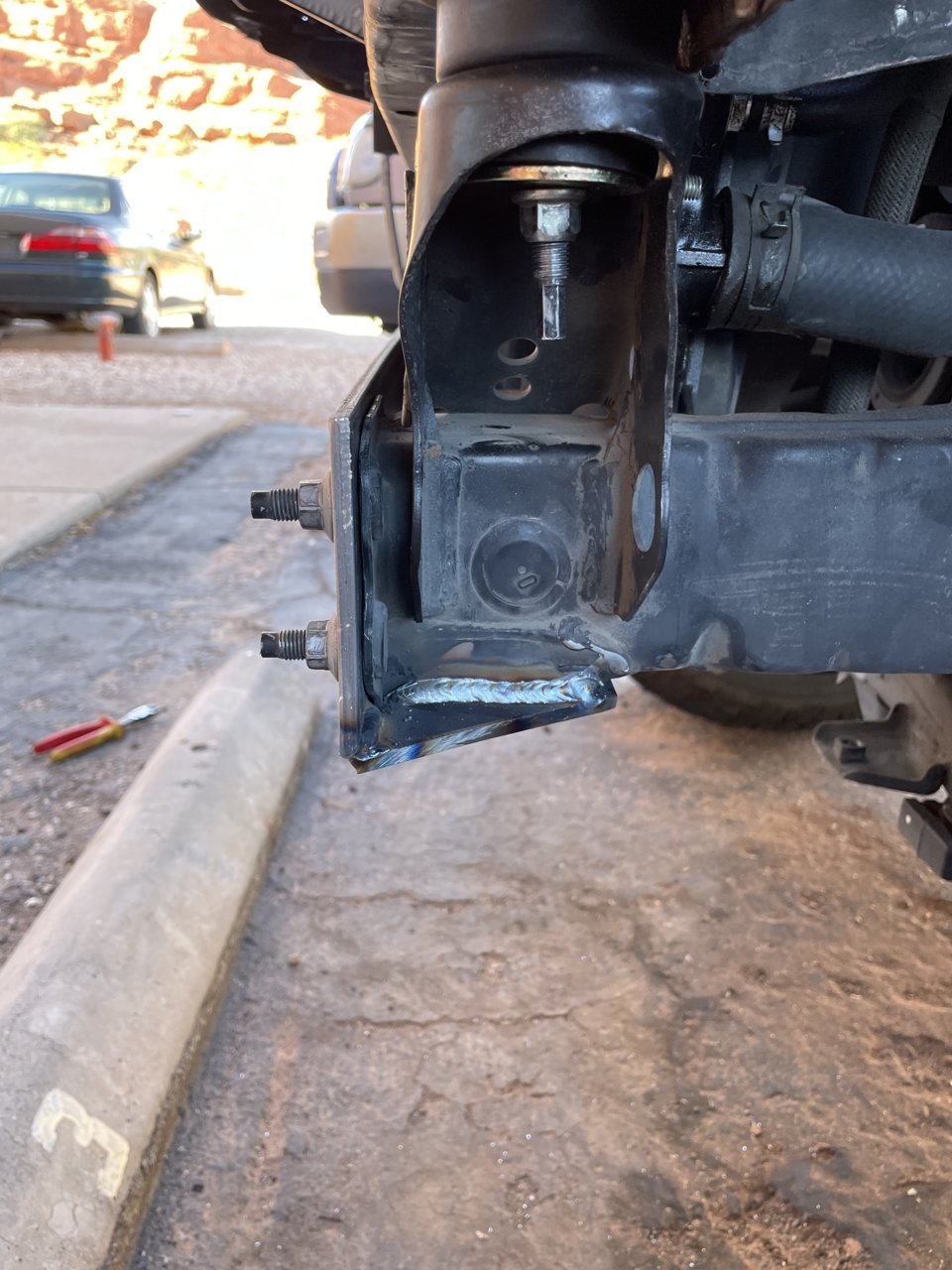

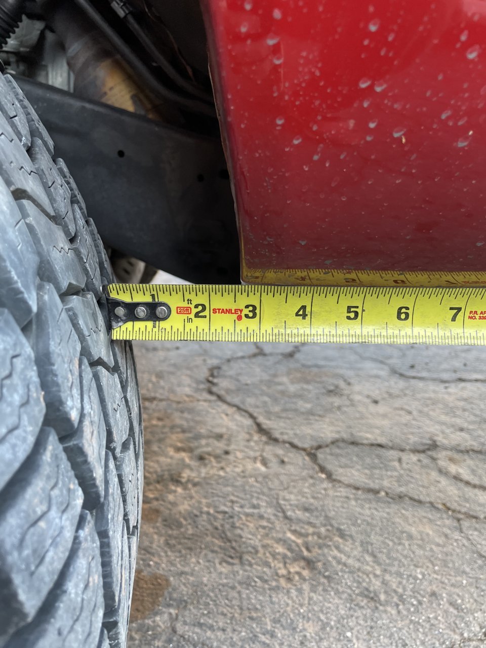

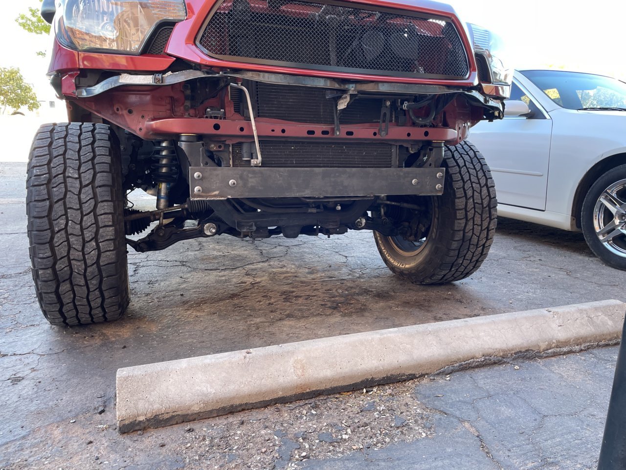

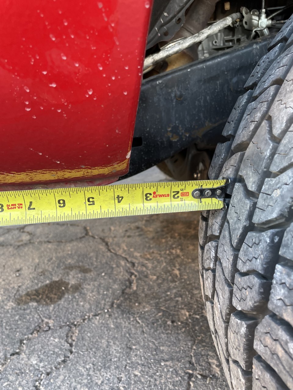

    So I did a 1/4 inch plate across and took out the lower crossmember thing. Added some reinforcement plates to weld to the frame for a little extra strength. I am going to go off this to make my new front cab mounts I think. Then when I get lower pivots and a skid I can work form it into my new bumper. On a side note something that I noticed as I realized some stuffs tweaked from the accident. My driver front tire has an inch less gap to the fender. Just got it aligned. I’m starting the wonder if the bucket or something else is tweaked. All the new suspension went on fine but not sure if this is normal tolerances? I measured points on the frame and both buckets seem to be even.. ideas or advice?
