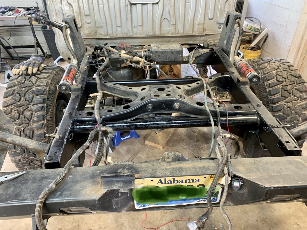

    Dayman Karate
    Dayman Karate Well-Known Member
    Dec 18, 2017
    #238838
    4,720
    Clay
    Central Alabama
    JKU Rubicon
    https://www.tacomaworld.com/threads/daymans-karate-class-but-you-wont-learn-nothin-4-link-lt-and-previous-iterations.755134/
    Just finished up and took it for a test drive. Much more solid. I have less than half the movement between the cab and bed and I’m not sure how to confirm this, but I could tell it was the cab mount bushings doing their job and not the frame. The ride inside was smooth and I could see my toolbox vibrating which it didn’t do before. I was unable to recreate the bounce/vibration at 40 mph. There was no reverb after hitting bumps either. So far it’s a success but I want to drive it for a while and get the full picture.
