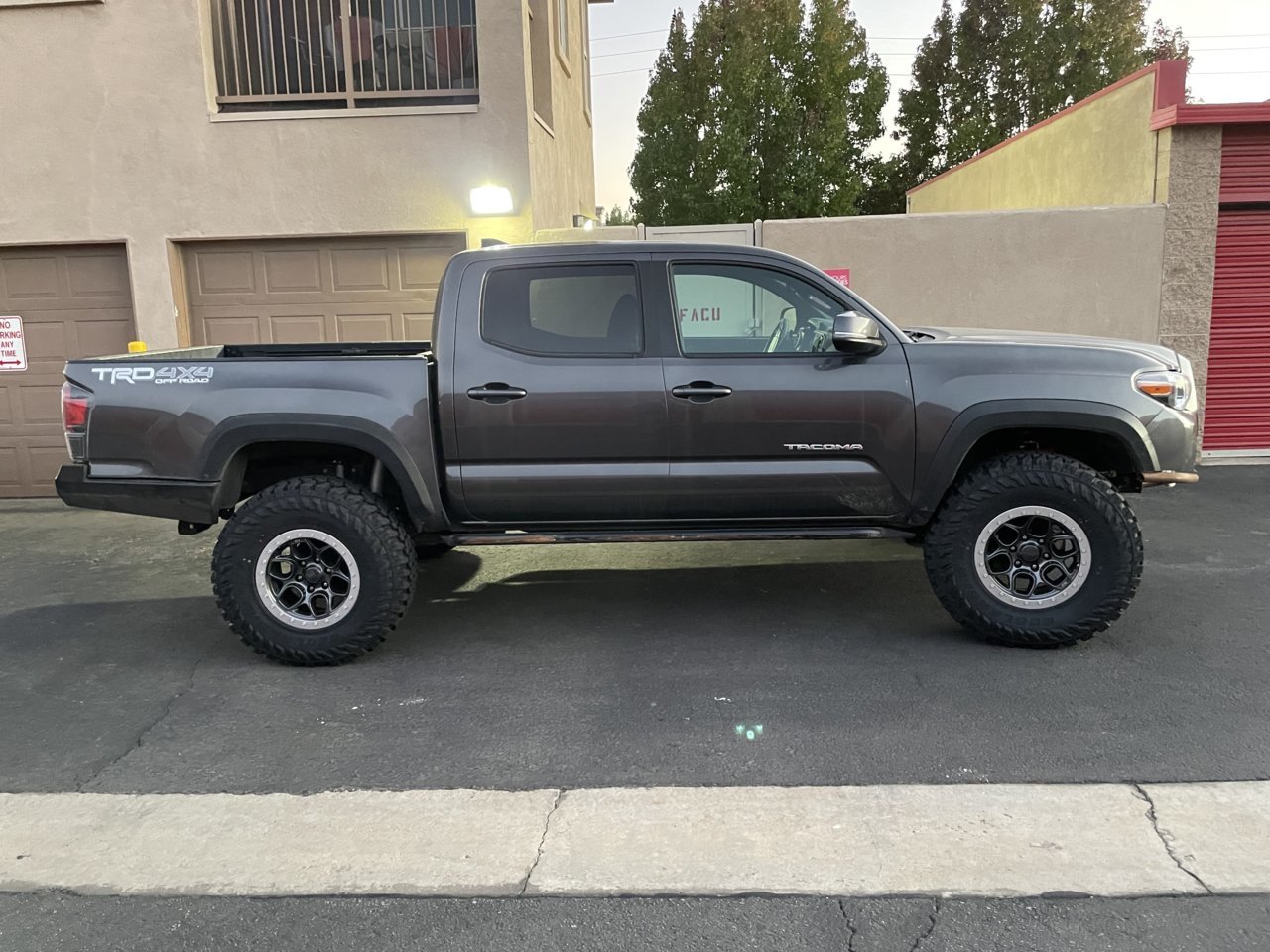

    Ordered the lower pivots for my 3rd gen. Anyone have clearance issues pushing it out to the full 1”? I’m Running fox dsc in the front, wondering if I’ll have tie rod to shock interference? Looks close now in the factory location. Also has anyone run the pivots with JBA upper control arms with success? Running 35s so trying to get the most castor and clearance at the cab mount.

    You will definitely run into clearance issues with the inner fenders pushing them forward the full 1” But realistically, you’re going to have clearance issues no matter what with 35’s and untouched inners. Tie rod clearance should not be any issue.

    The JBAs should work with the pivots as long as they are the standard, non-high caster arms. As I recall, using caster arms messes up alignment with the pivots when you push them forward.

    Damn that blows, mine are high caster arms. Guess I’ll be ordering JD arms. Going to 35s is not cheap. Sh*t I’m like 5k into it now.
