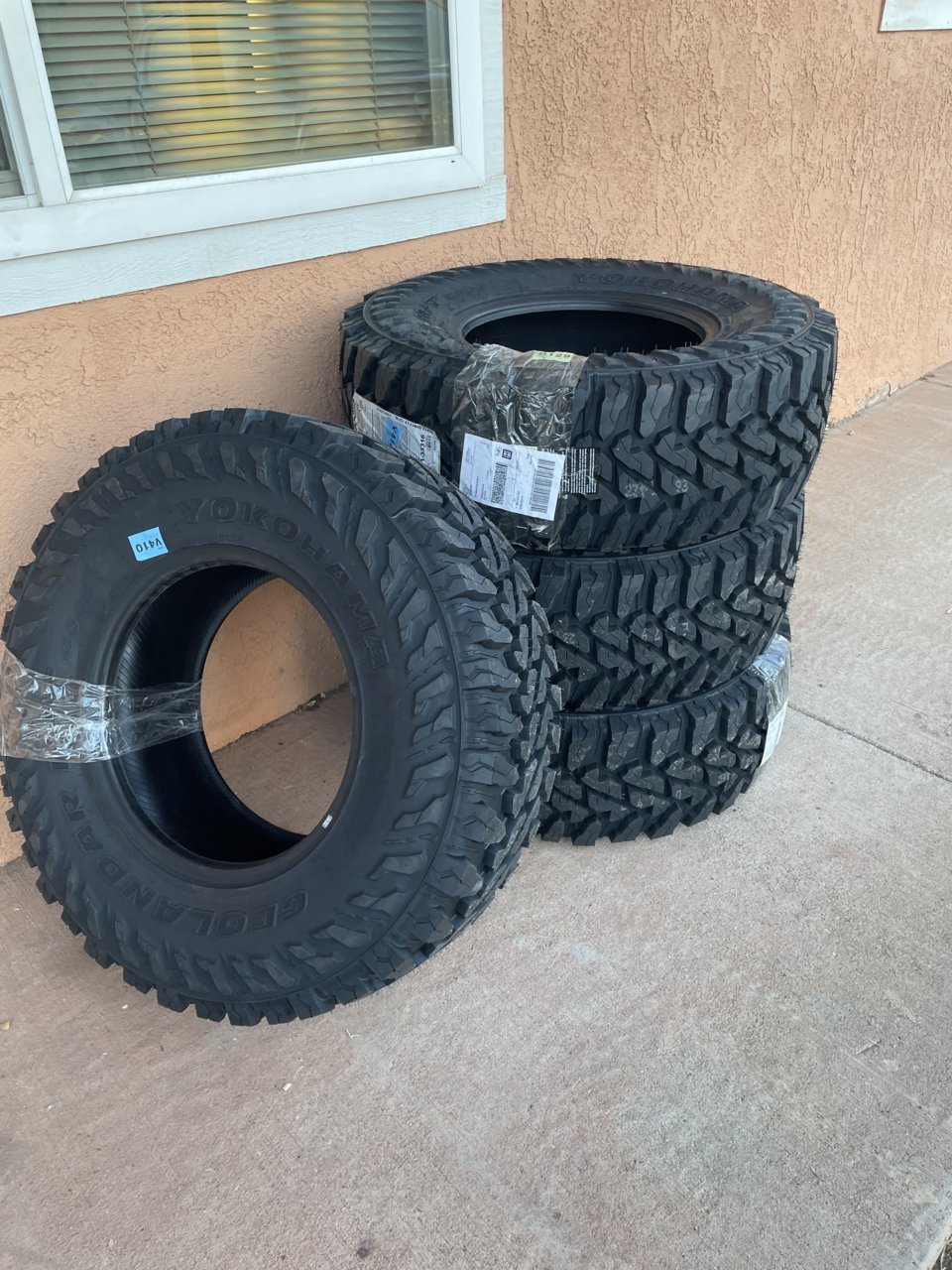

    It’s crazy how much bigger they look than my 33’s. I’ll post a comparison pic when I get them installed this weekend.
