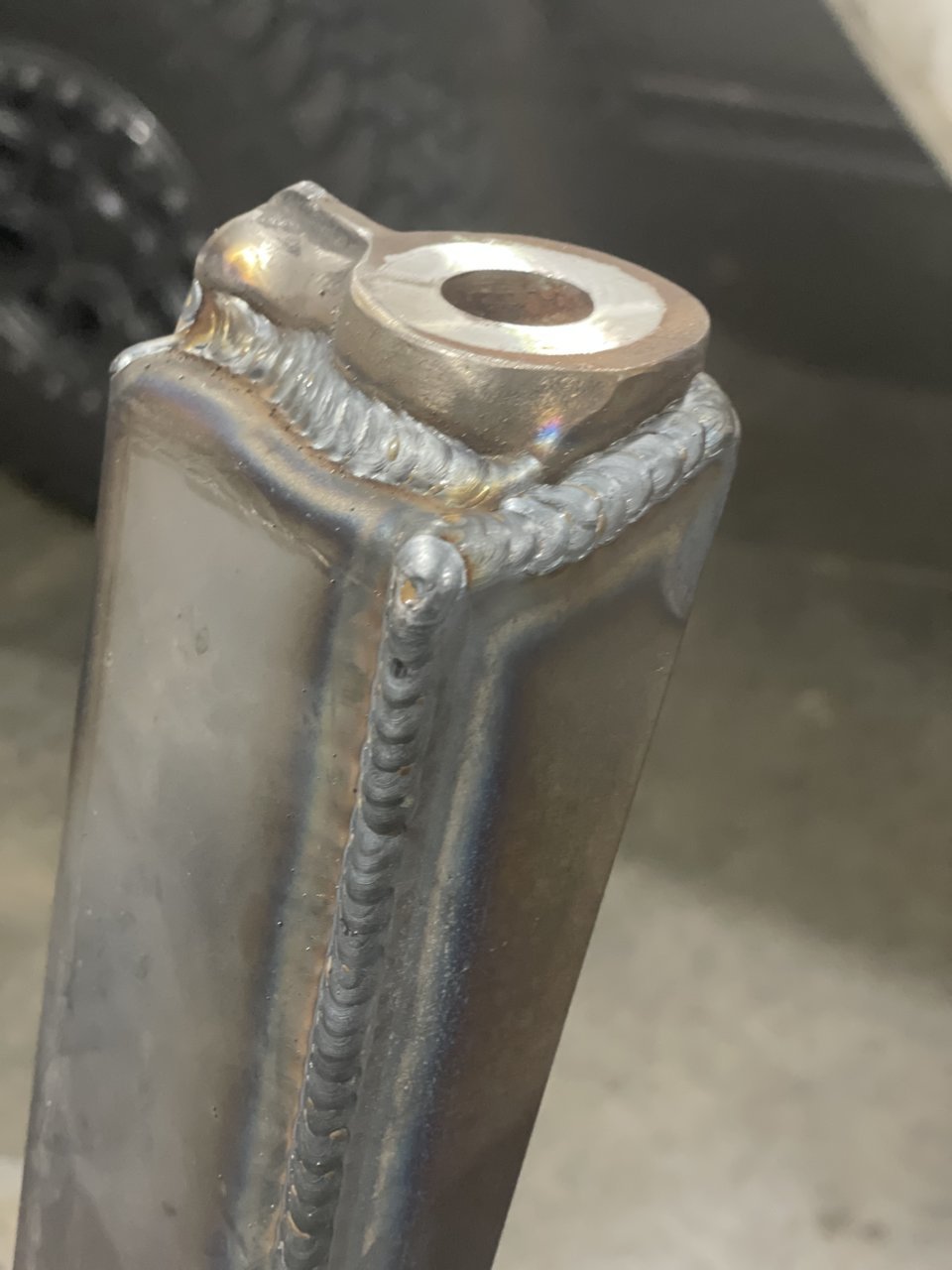

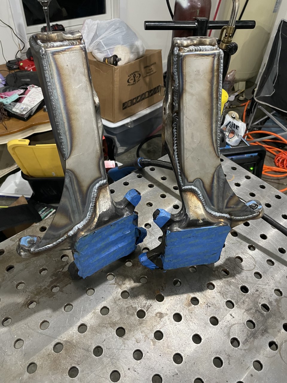

    I don’t know what it was, but that was my favorite piece of the puzzle to weld. Probably because I could sit it on the table and get comfortable and have plenty of light.

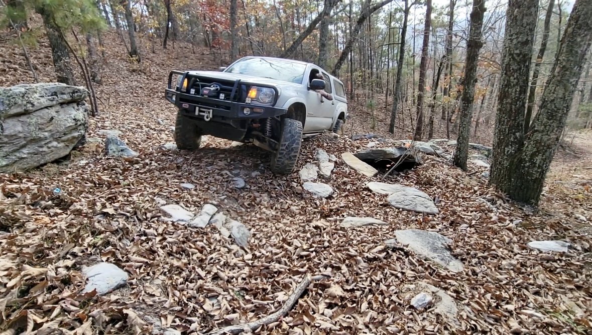

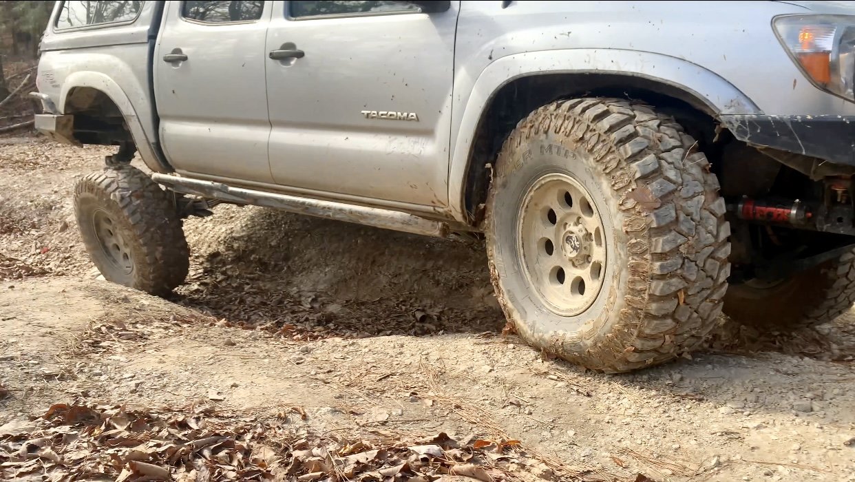

    Played around a bit today. Finally found something to drag a slider on. Still haven’t taken it to a park after LT. Dying to stretch it out.

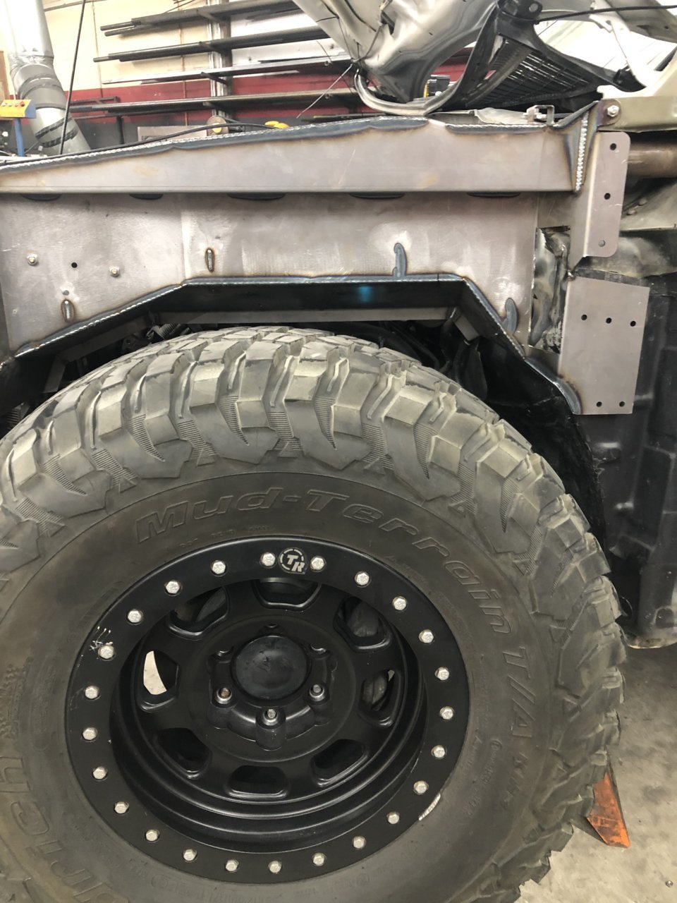

    I’m going to take a leap and say there’s nothing bolt on for the Tacoma that will allow you to fully stuff and lock a 33 and maintain stock suspension travel without trimming something. I’ve never seen anything at least. JDs pivot kit is probably the least messy way to fit larger tires. I suppose you could do their LT kit and maybe not trim since it moves the wheel forward 7/8” by means of the lower arm. Something tells me you might not be interested in that route though.

    If you're getting full bump travel (metal to metal LCA-Bumpstop) from an otherwise stock geometry front end your 33s will hit the fender flares. This only happens when you go to an aftermarket LCA and get rid of the OEM LCA bushings; which greatly limit travel, until they wear out and break...

    People who think lift has anything to do with tire clearance just don’t wheel. If you can’t run a certain size tire at stock ride height you’re not going to wheel without rubbing. So while a 2.5” lift will let you run 33’s down the highway, you still won’t use all of the travel off road without rubbing unless you clearance.

    I can’t believe we still have to listen to the ”how much lift do I need to fit tires” argument still. Lift doesn’t matter. 255/85R16 (33’s) fits with little to no rub if you stick with stock wheels. If you increase the offset at all, you’ll rub. If you go any wider, you’ll rub. CMC isn’t voiding any warranties and alignment will be critical when trying to fit larger tires.

    Solo claims 19” with the LT kit they sell but if you have these JD aftermarket inner fenders with 15” of travel with the plus 4 kit, and almost bumps out on them I have no idea how the hell you’d get 19 with stock inners, without just tearing it all out.
