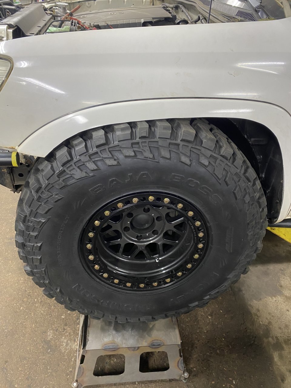

    Any pictures floating around of the +2.25 kit bumped out at the factory fenders? Im in a debate with myself that +3 fenders wont be enough for the 2.25 kit and my -38 wheels.

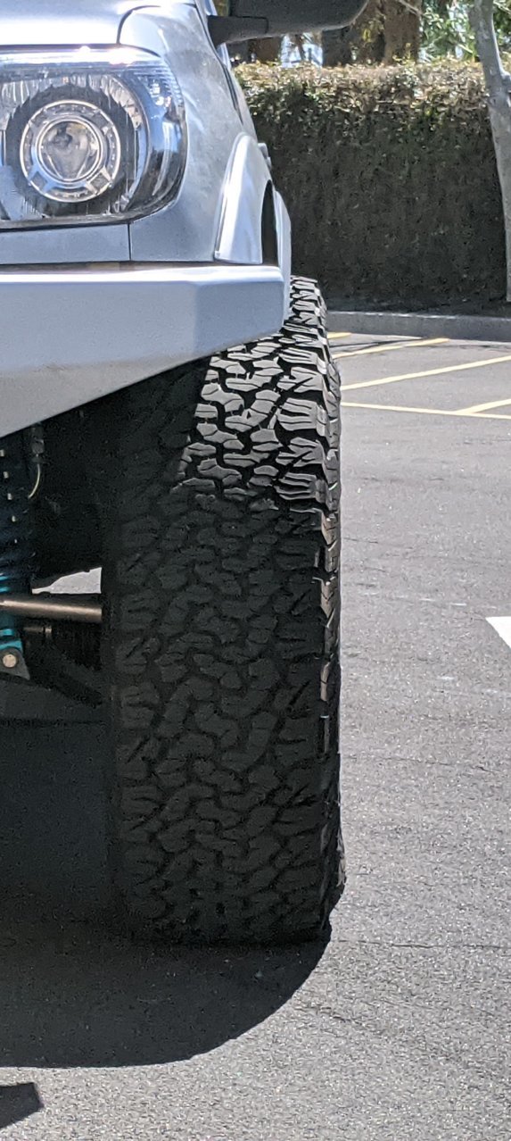

    Bumped out and looking head on to see how much they stick past the fenders? I may have one like that.

    That would be of some help. This is all I’ve got. Stock width at bump.

    I looked and I don’t have anything good either. This is all I’ve got but it’s taken on a fish eye lens so it’s a little distorted.

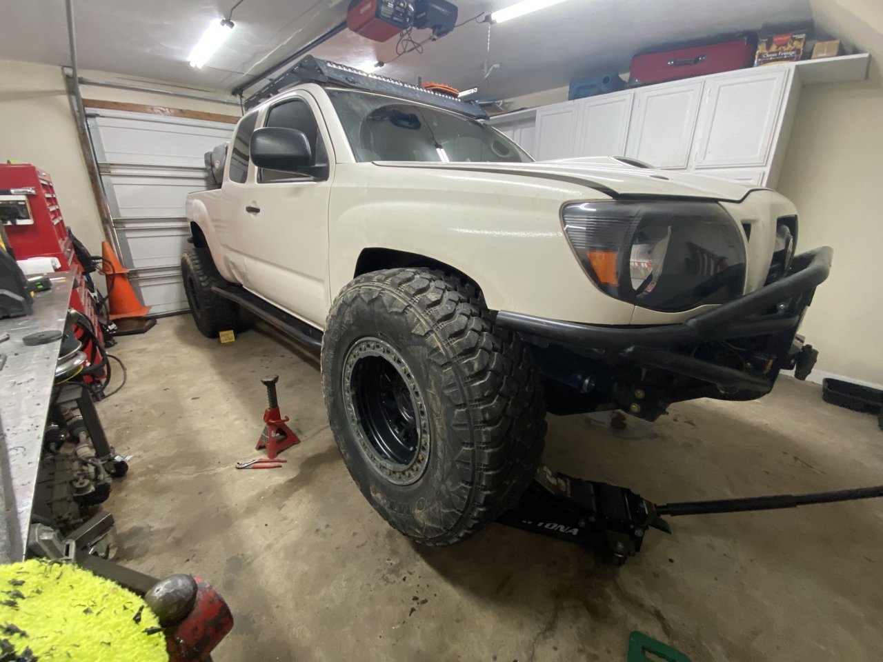

    Liners and flaps? here's a pic in the right direction at ride height.
