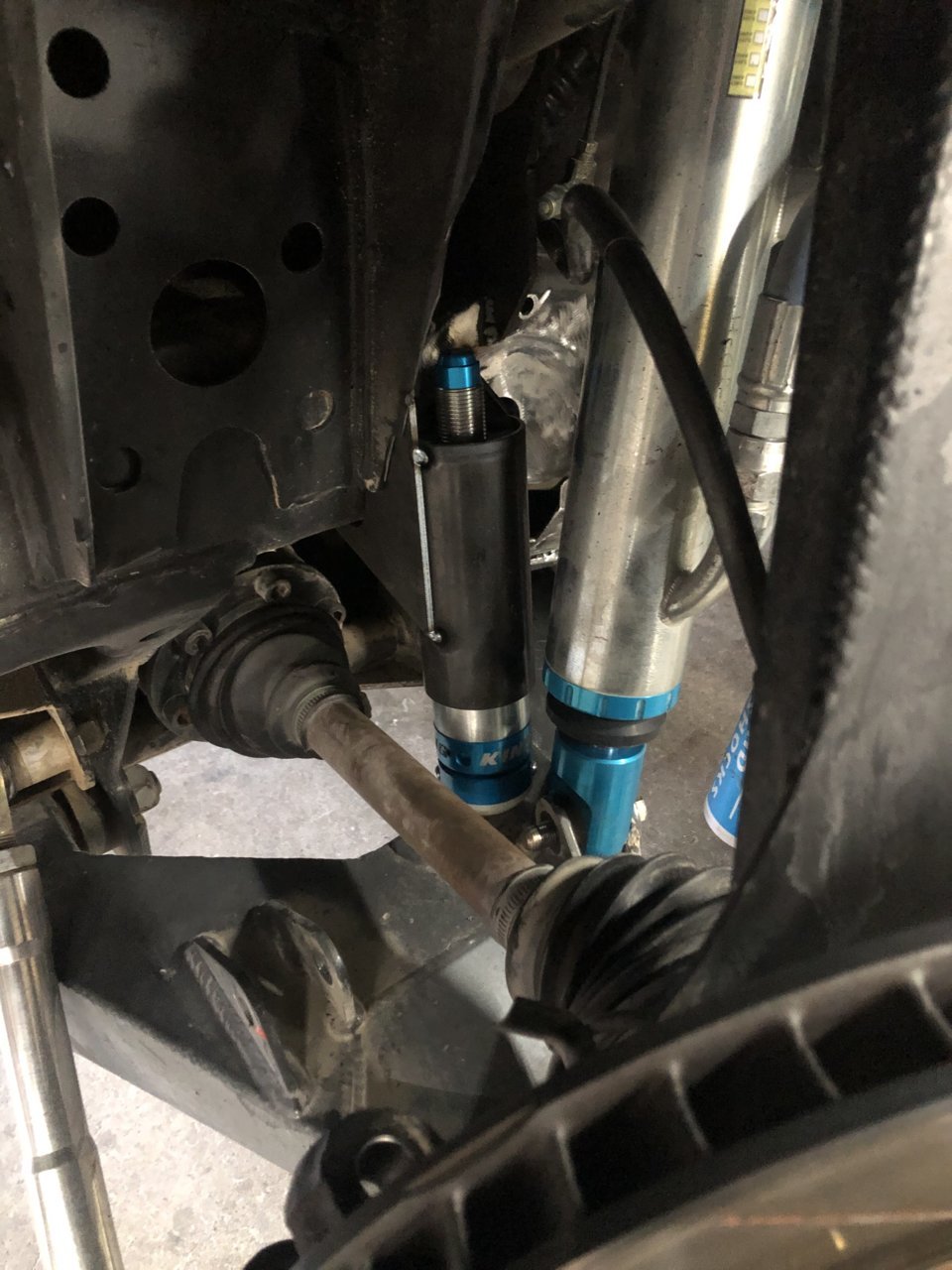

    20min in, gotta get this done so I can get home to help my wife get ready for thanksgiving... or not :)

  4. Nov 22, 2021 at 4:43 PM
    Suicyco
    Suicyco Well-Known Member
    Feb 8, 2017
    #210044
    421
    14 ac 4x4
    Thats nuts it only took about 30 mins to cut off that factory bump blob thing and mock up a bump and can!?

    I'm guessing Harry knew full and well it would be coming back for bumps at some point and like all of us even @kasnerd has a budget

    I asked about it initially and we decided no hydro bumps to get all the travel as possible with the free bleeds opened up.
    Had icon hydros on the rear with the last setup and didn't like it...now it's not a choice. haha either slow down or hydro bumps. Well you know the answer seeing tacked in bumps.

    I was blowing through travel with mine opened up. I had to close it up almost all the way to help stay off the inner fenders.

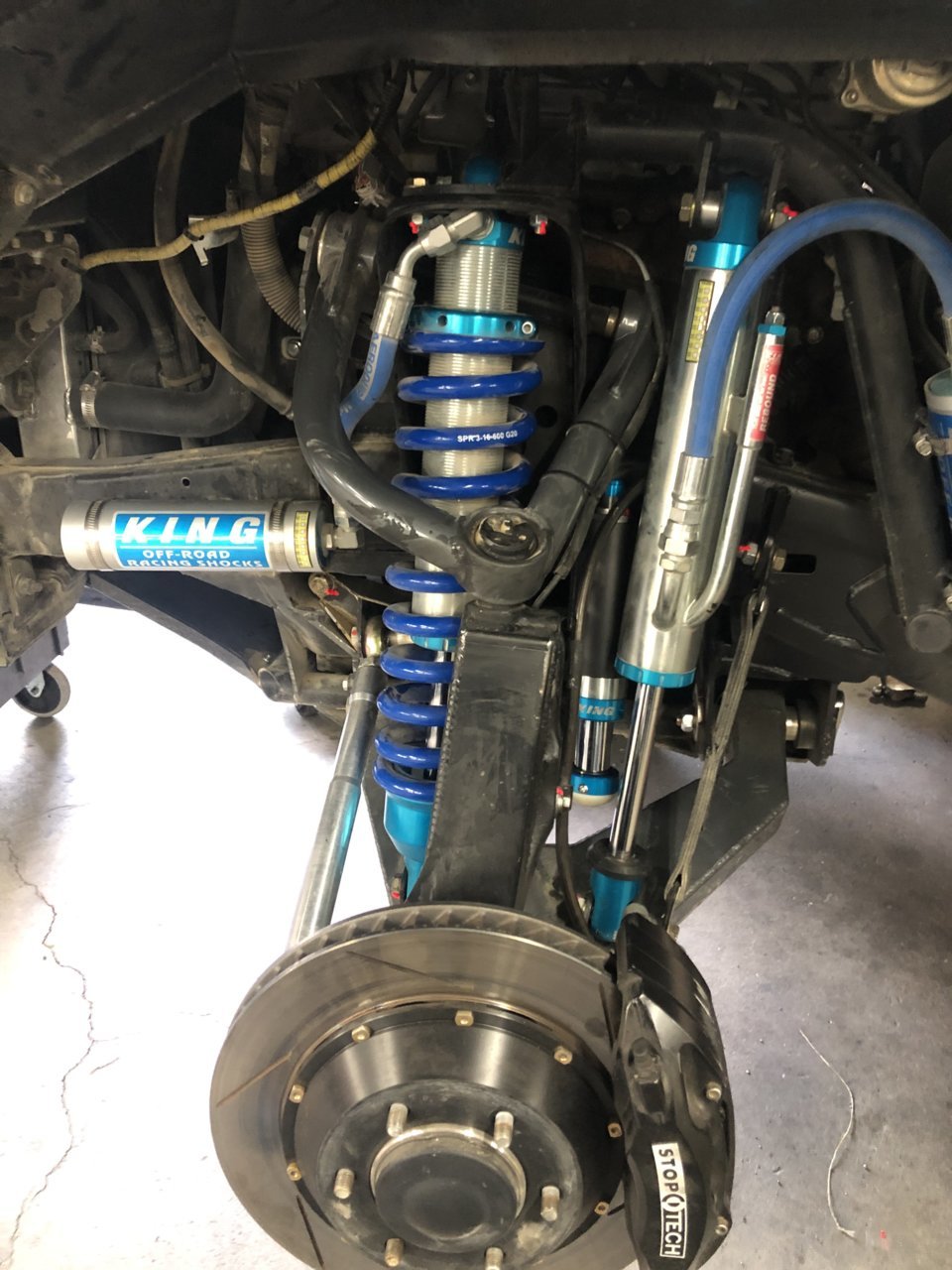

    Bumps are mounted, paint is drying... passenger cam bolts were bent inside the tabs. Put new ones in and back for alignment tomorrow

    So the bent lower cams were bent enough to push it back 1/2 an inch? Guess we will find out after the alignment but if so..

    I mean, that’s about the best possible weak link. Cheap and easy fix. I’d bet that hit would have folded the factory lower pivots.
