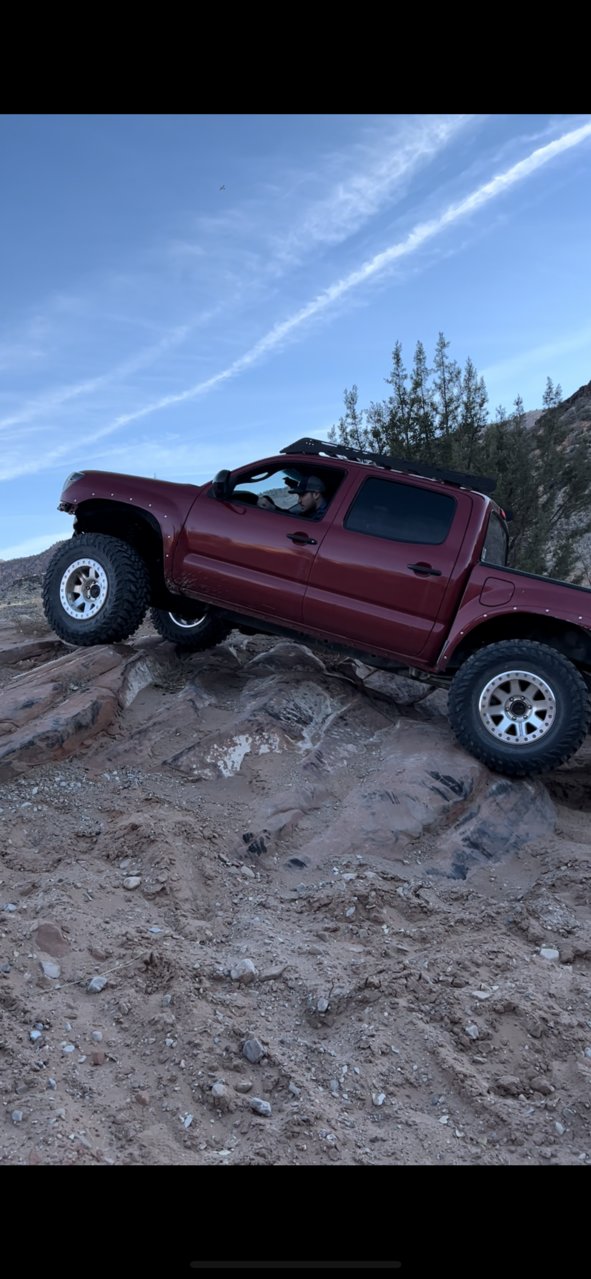

    I like a mixture of dunes and crawling obstacles. We have sand hollow and some dune/desert spots that are really fun but I like changing it up and doing some crawling trails. I don’t do anything crazy though just some fun stuff with the wife to get the blood flowing and get better at taking lines. Think she likes the desert fast stuff a little more though. I really enjoy both though just want something capable that can do both but I understand I can’t have the best of both worlds. Especially with a truck that’s not really designed for this stuff. Just trying to build the best fun truck I can and be smart about it.

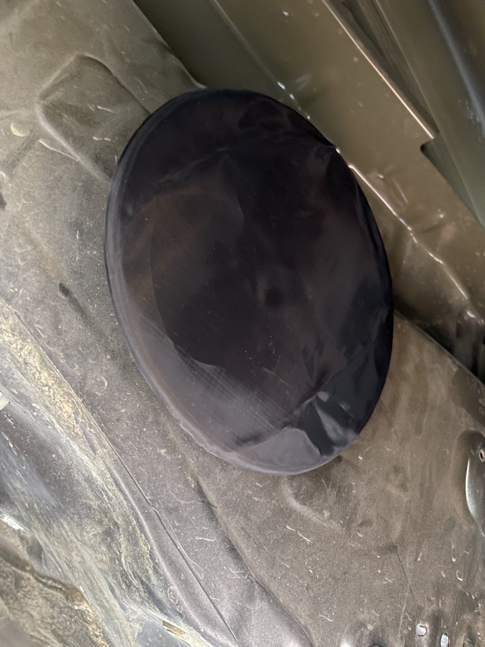

    I capped it off and rerouted my intake to the cowl. No more destroyed air filters and maf codes lol

    Same here. Mine’s been in the cowl for over a year and no issues.

    Nice, just figured it’s a cheap easy mod. $13 shipped and takes 2 seconds to install. I’ll reroute mine when I do the inner fender kit.

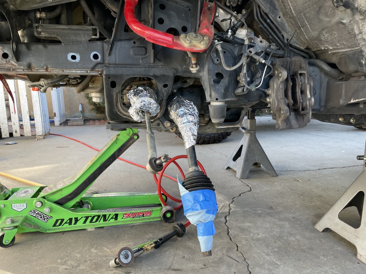

    This shit is not too bad to cut off. No turning back now.

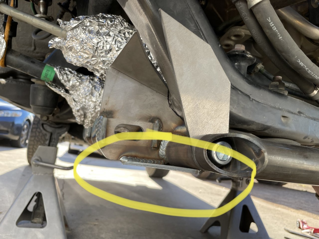

    Should the angle of this front lower mount be the same angle as the frame and front crossmember?
  16. Nov 29, 2021 at 3:15 PM
    81Trekker
    81Trekker [OP] Well-Known Member
    Aug 25, 2019
    #303299
    3,750
    La Jolla SD
    81 Trekker and 2015 CCSB Tacoma
    Too many to remember
    No, they kick up slightly
