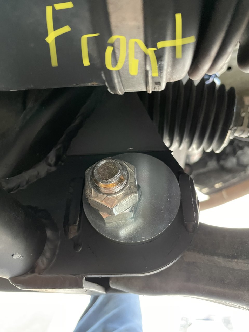

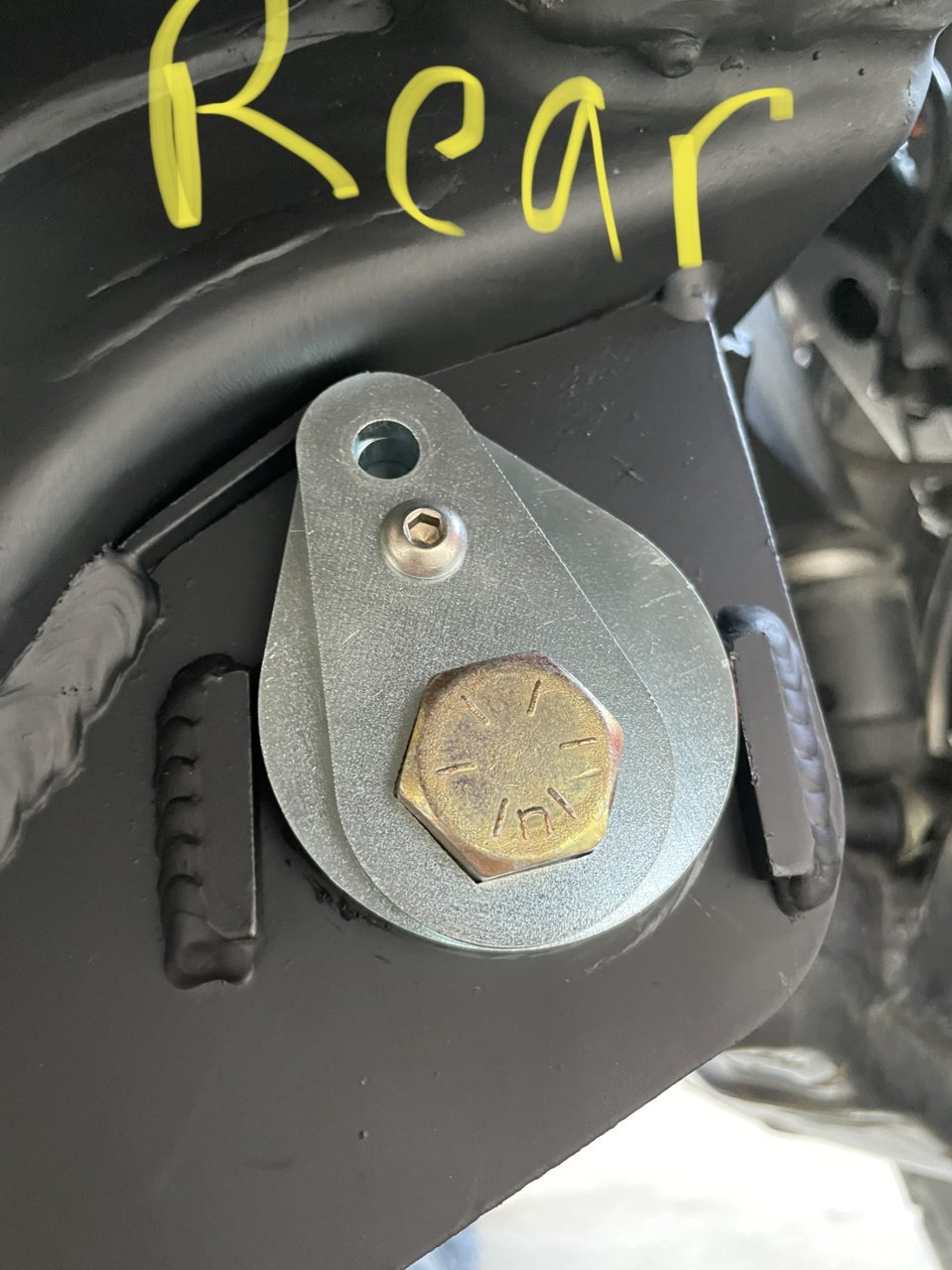

  3. Nov 30, 2021 at 4:12 PM
    Anderson5290
    Anderson5290 Well-Known Member
    May 30, 2018
    #254979
    758
    Brandon
    Corona, Ca
    2018 Tacoma TRD OR 4x4
    Tuned Fox 2.5 resi with dsc, JBA HD UCA, total chaos knuckle gussets, rear trd pro fox shocks, Deaver U402 stage 1 rear leafs, archive garage u bolt flip with fox 2.0 air bumps, White knuckle off road rock sliders, BAMF 1/4” steel skids, Magnaflow exhaust, Archive Garage Hammer Hangers, Cbi high clearance rear bumper, 285/75/16 tires.

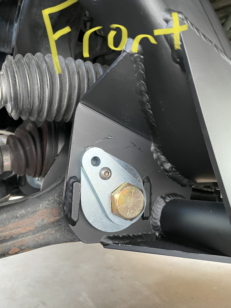

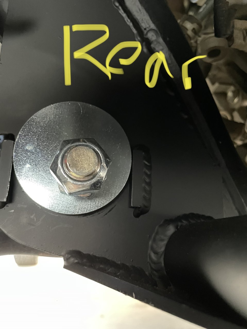

    Do these cam bolts look installed correctly? They seem like they would work even if switched from side to side.
  4. Nov 30, 2021 at 4:29 PM
    Airdog
    Airdog did your Mom
    Dec 26, 2012
    #93790
    4,895
    Tom
    SoCal
    https://www.tacomaworld.com/threads/airdogs-2012-prerunner-access-cab-slow-build.264263/
    It looks correct to me
  5. Nov 30, 2021 at 4:42 PM
    RonRon23
    RonRon23 Well-Known Member
    Aug 25, 2013
    #111135
    1,303
    Ronnie
    Buena Park
    2013 MGM DCLB 4x4
    Front suspension: Work in progress JD Fab +4 LT, LCA pivot kit, steering slide rack, 934CVs Rear suspension: Archive Garage shock relocation and SUA Conversion,King 14x2.5 shocks, King 2x2 hydro bumps, FN wheels 5 stars, sliders
    If they were installed wrong, you’ll know. They bind up or you won’t get full motion out of the cams.
  6. Nov 30, 2021 at 4:45 PM
    Anderson5290
    May 30, 2018
    #254979
    758
    Brandon
    Corona, Ca
    My camber is way messed up. Way too much positive camber. The cams move freely front and back.
  7. Nov 30, 2021 at 4:53 PM
    DocME
    DocME Well-Known Member
    Aug 24, 2018
    #263956
    1,583
    California
    '07 FJ Cruiser
    TRD S/C, UCON, 61# inj, 2.5 pulley, 7th inj, Roostfactor Y Pipe, URD exhaust, WAT Nomad Valve body, Dana 60, DK LT, JD FAB LCA mounts, custom roof rack...and way too many others.
    the front cams are all the way in in the pictures, you should be able to adjust them out from there to go more negative/neutral on camber.
  8. Nov 30, 2021 at 5:06 PM
    Anderson5290
    May 30, 2018
    #254979
    758
    Brandon
    Corona, Ca
    I know what I did wrong, the Cam bolts are wrong side to side that’s why I’m not able to get rid of the positive camber. They all need to be swapped from side to side.
  9. Nov 30, 2021 at 5:18 PM
    DocME
    Aug 24, 2018
    #263956
    1,583
    California
    '07 FJ Cruiser
    I think you're saying you're going to flip the teardrop cam 180 degrees to be in phase better with the rear cams? I don't think they are side specific. That's another adjustment feature of the kit.

  10. Nov 30, 2021 at 5:30 PM
    81Trekker
    81Trekker [OP] Well-Known Member
    Aug 25, 2019
    #303299
    3,750
    La Jolla SD
    81 Trekker and 2015 CCSB Tacoma
    Too many to remember
    Correct
  11. Nov 30, 2021 at 5:45 PM
    Anderson5290
    May 30, 2018
    #254979
    758
    Brandon
    Corona, Ca
    They’re for sure side specific. You will end up with way to much positive camber If they’re installed incorrectly side to side. It’s waaay better now.
  12. Nov 30, 2021 at 6:00 PM
    DocME
    Aug 24, 2018
    #263956
    1,583
    California
    '07 FJ Cruiser
    Is the hardware different from the original release? Looks like there’s a nut on the round cams?
  13. Nov 30, 2021 at 6:01 PM
    81Trekker
    Aug 25, 2019
    #303299
    3,750
    La Jolla SD
    We use longer bolts now so you can run a jam nut and then top lock. All the cam hardware is also zinc coated now too

  14. Nov 30, 2021 at 6:03 PM
    DocME
    Aug 24, 2018
    #263956
    1,583
    California
    '07 FJ Cruiser
    Ahh, got it. I zinc and nickeled my cams when I got them. Not cheap but they look great and it’s good to have that level of protection.

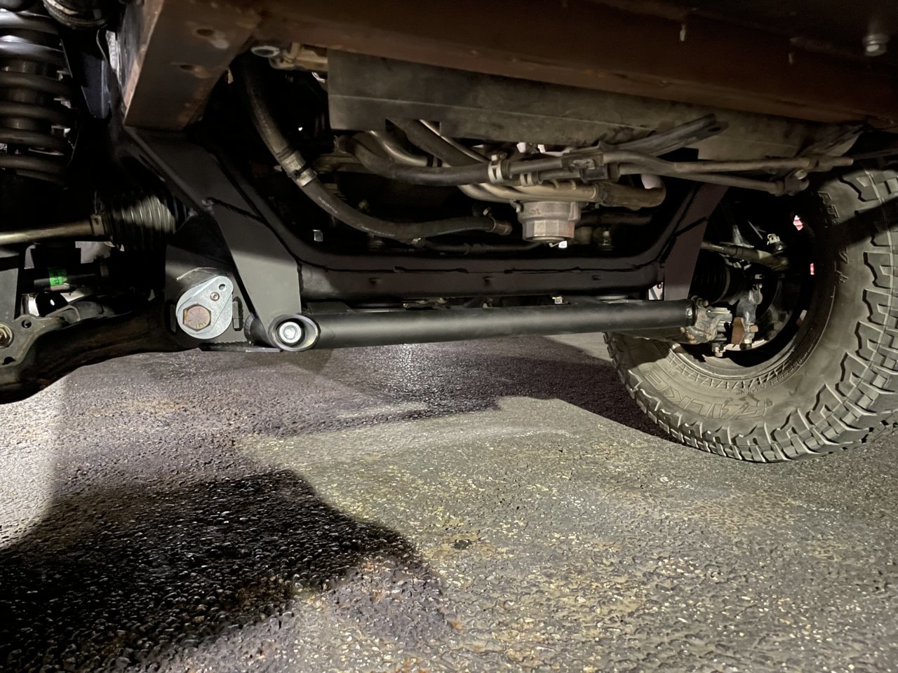

    This shit is sweet, truck drives damn good better than is has before with a driveway alignment.

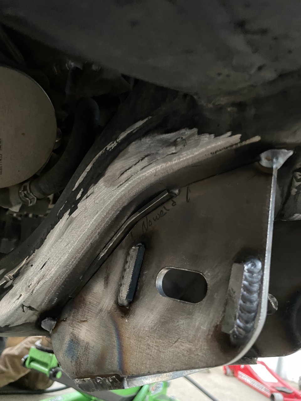

  16. Dec 1, 2021 at 8:09 AM
    Anderson5290
    May 30, 2018
    #254979
    758
    Brandon
    Corona, Ca

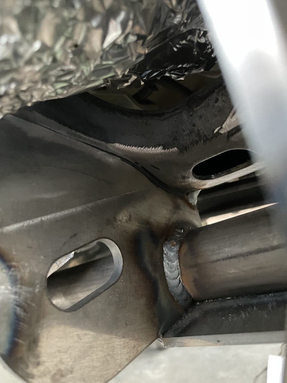

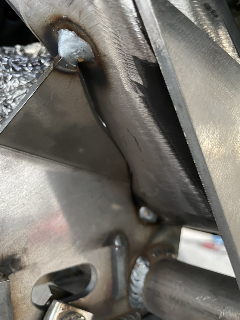

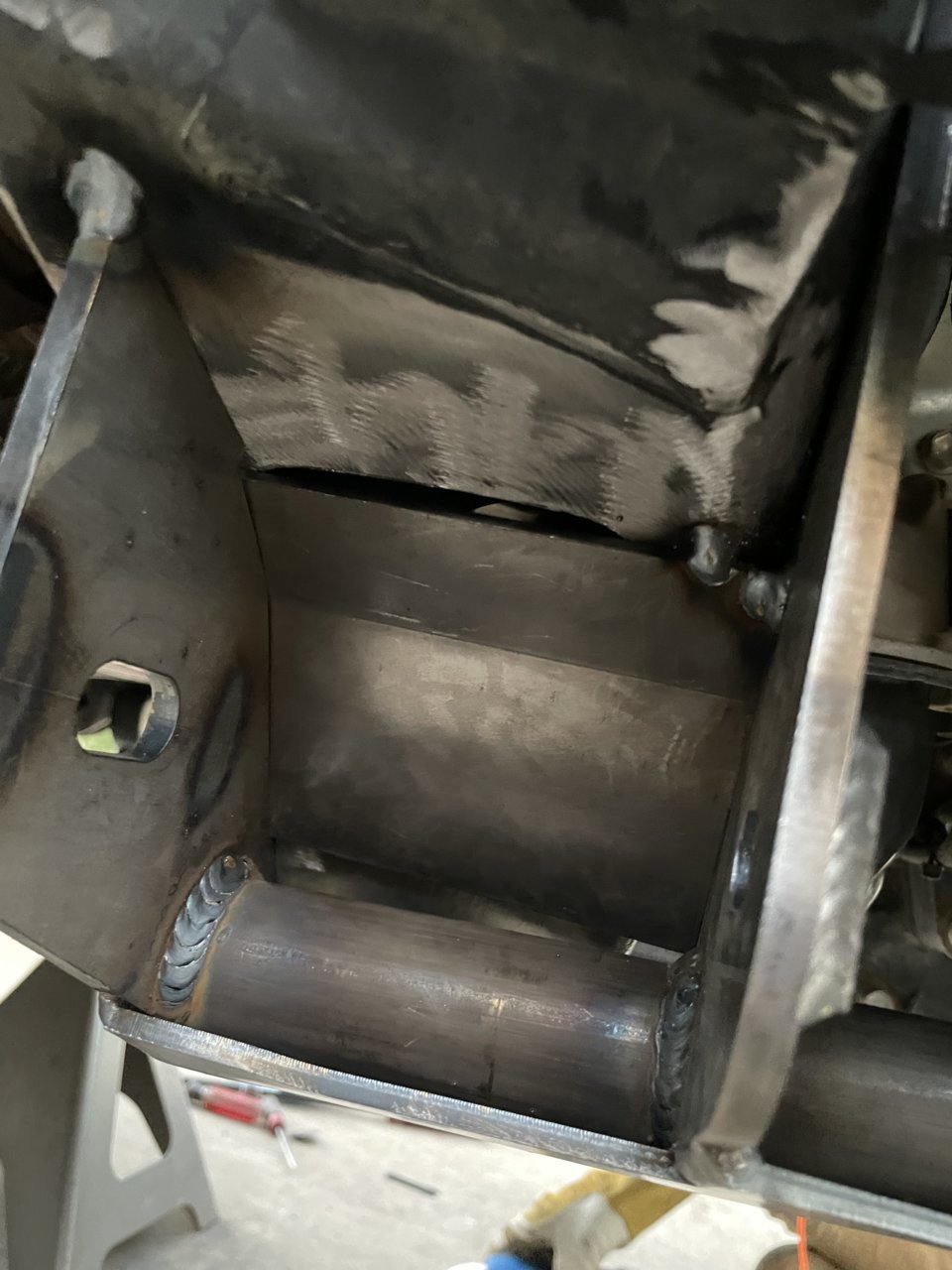

    Here are some shots of the fitment after removing just a little material from a few spots. Pretty impressed with it. Pretty sure Harry would approve. Driver side didn’t fit as well but only a slight gap on one spot. Probably has something to do with the time I slammed my 1/4 steel skid hard enough on a rock to slightly bend the skid and crossmember.
