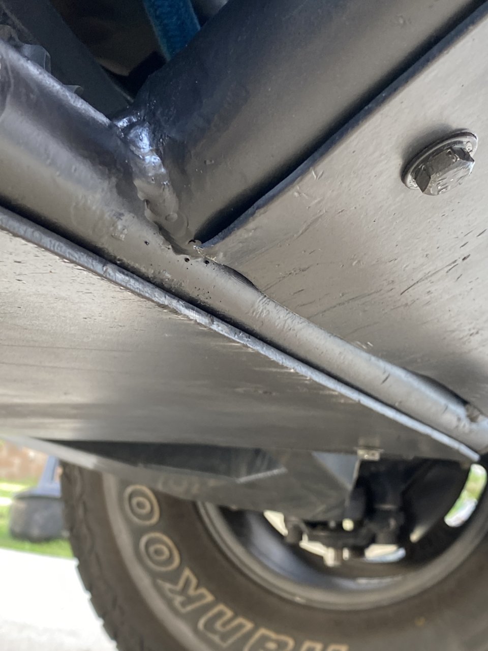

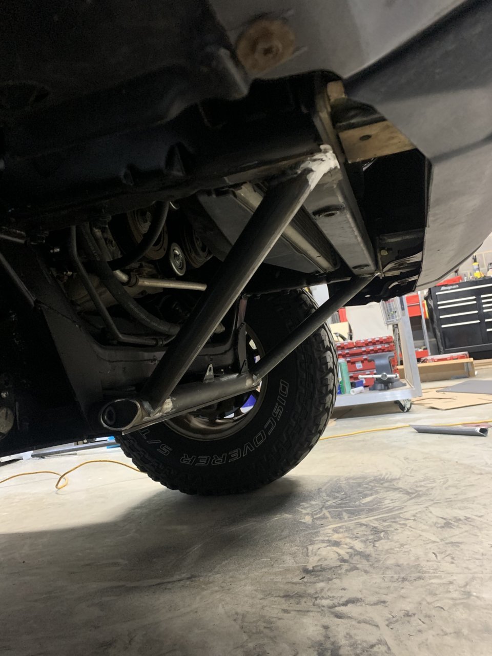

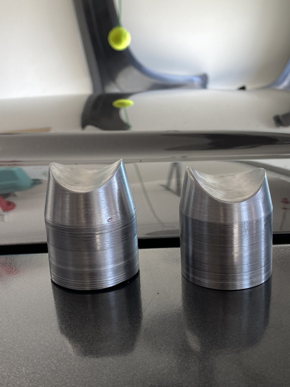

    The bumper I traded for is made out of 2 inch tube. Had to cut some of the lower parts off the bumper because it hit the lower pivot kit cross bar. So I made some adapters that slid into the 2 inch tube and coped it to tie
    into the jdfab cross bar. Had my buddy weld it all up for me. Its a pretty solid setup now.
    I dont have an really good pics of it welded up but heres what I got.

    Nice, I’m sure it’s way more stout like that. Anytime you can spread out mounting points and add triangulation like that is a win IMO. Not sure if that was Harry’s goal with the cross tube or not but I can’t see any downfalls doing it that way.

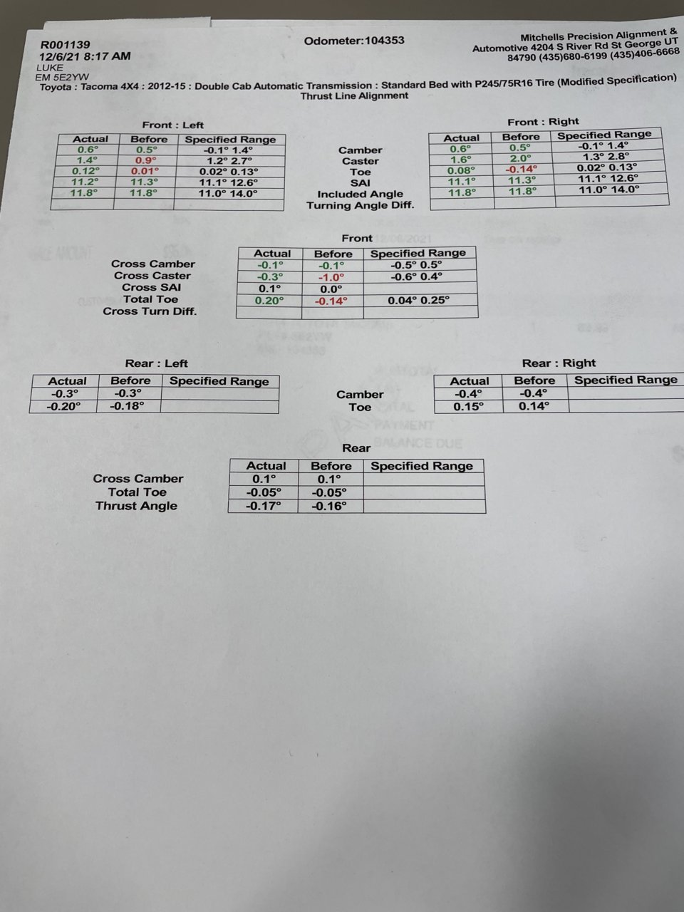

    These were the best numbers I could get with stock upper and lowers and ome 884 coils. Once I get the pivots, slide rack, inner fenders, and uca hoping to be able to get it close to what Harry said.

    That's pushed forward the full 1"? That cant be right. You should gain at least 3-4 degrees of caster going the full 1". I know I did...

    No this is without the pivots. I’m picking them up with my inner fenders. Just posting a before with stock max adjustments then when I get the alignment after I’ll post another.

    I cant read lol. Them numbers aren't horrible in that case.

    Yeah, just wanted to post a stock adjustment to reference how much more adjustment you get with the pivots and uca without LT.

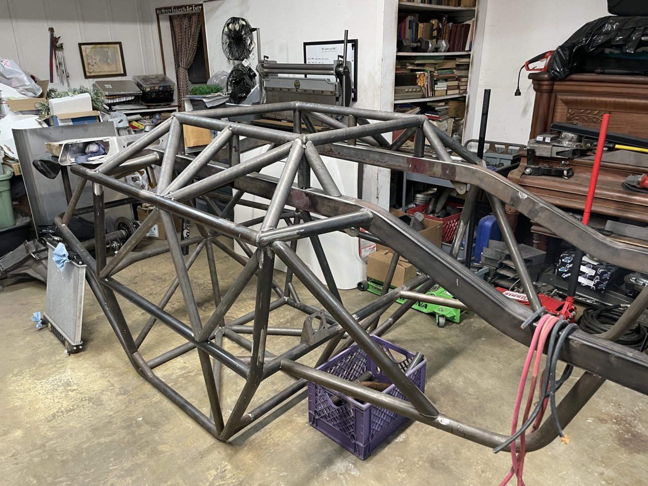

    I wasted so much tube trying to get those compound angles right. Not even gonna lie. Took waaay too long.

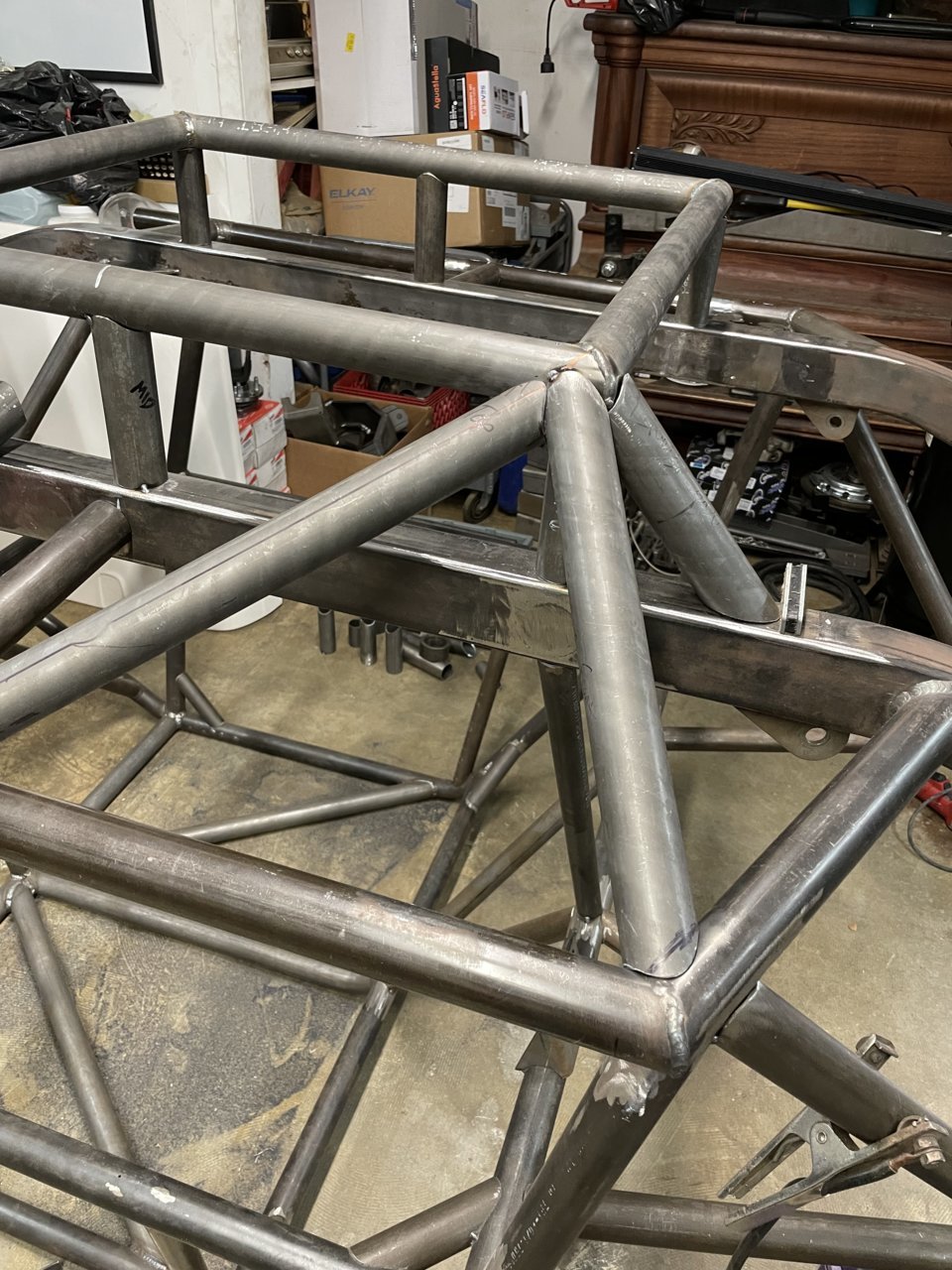

    You have to cut the tubes a little long and sneak up on it. I wasted about 3 feet trying to get these all to fit really good. Not bad considering it was a total of 24 separate tubes to do the subframe.

    you're building a "tube" chassis in a garage with a piano? That's grass roots there...

    Haha yep, gotta work with what you got. The plan was to race KOH coming up, but that got put on back burner. My brother is funding it, I’m just the, hey can you make this guy?

    Holy shit these things are beefy AF. Can’t wait for the other stuff. Thanks Harry!
