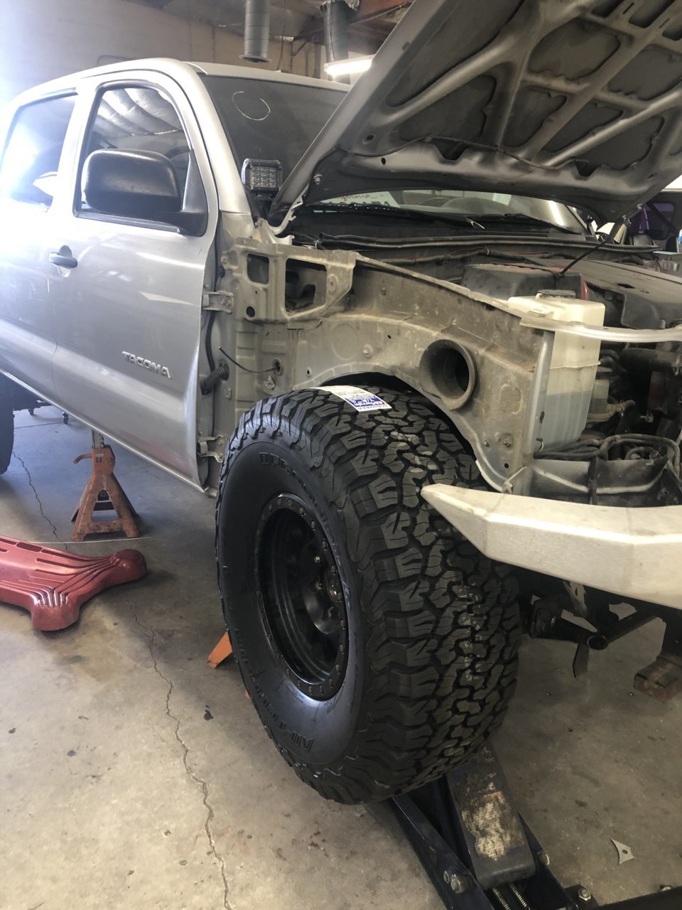

    35” tire at full bump

    That will only need a little trimming.

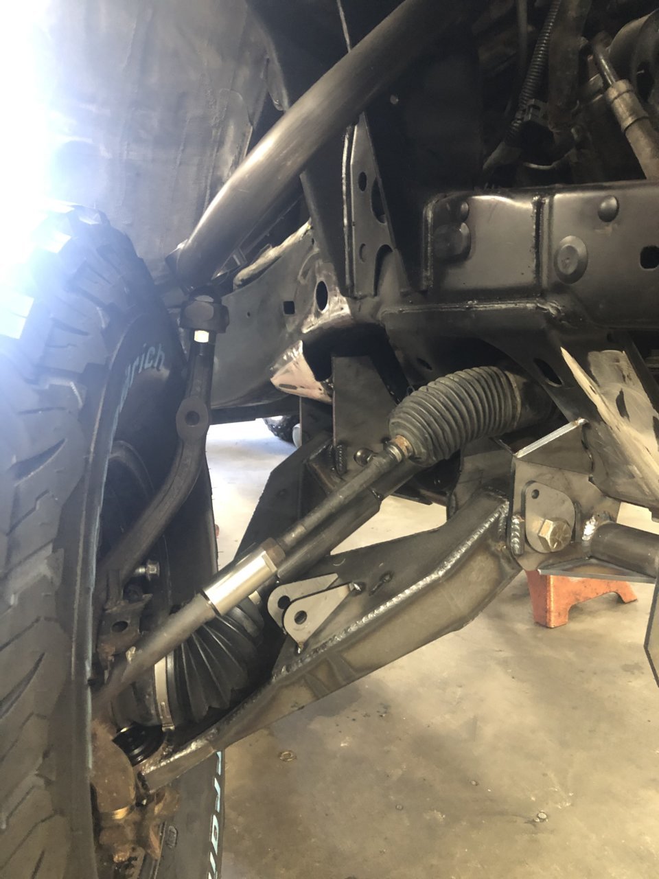

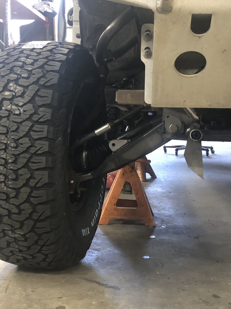

    cycles 12.5 and almost clears lock to lock :)

    That's +2" wider?

    Yes sir, running inset wheels so the track width puts the tires about flush with the stock fenders

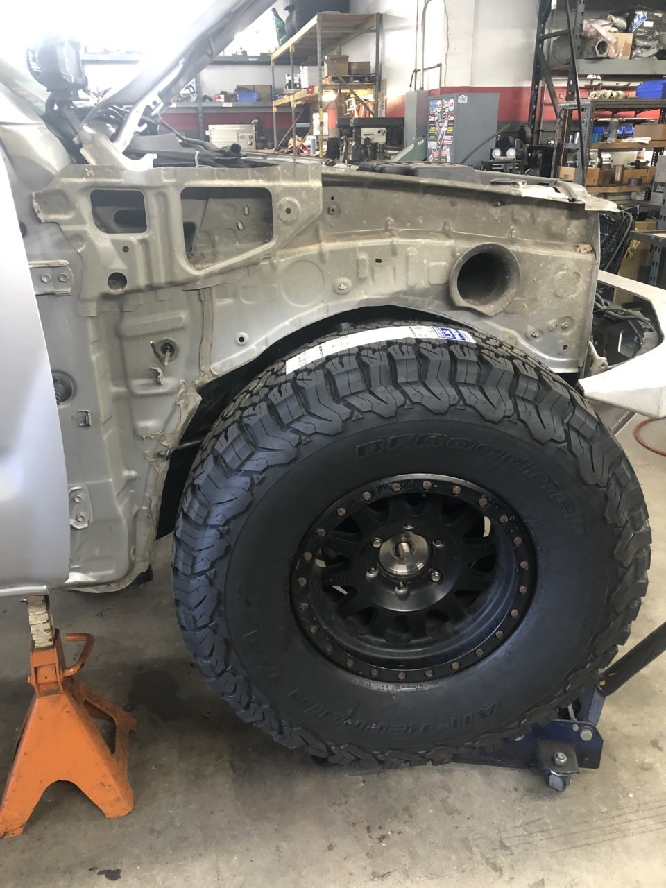

    I thought you were selling his old fenders? So why not get wheels with a little less backspace for a wider track width and to fill the fiberglass?

    We are still doing offset wheels and glass but wanted to cycle it with this setup so you have the option of running stock fenders
