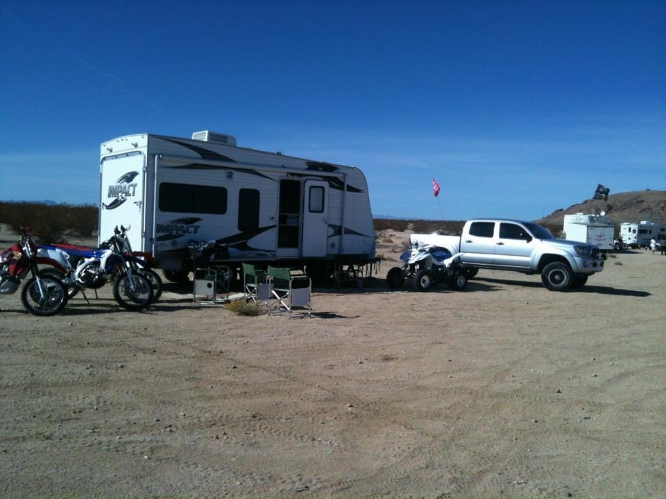

    Have any pics of that? Lol

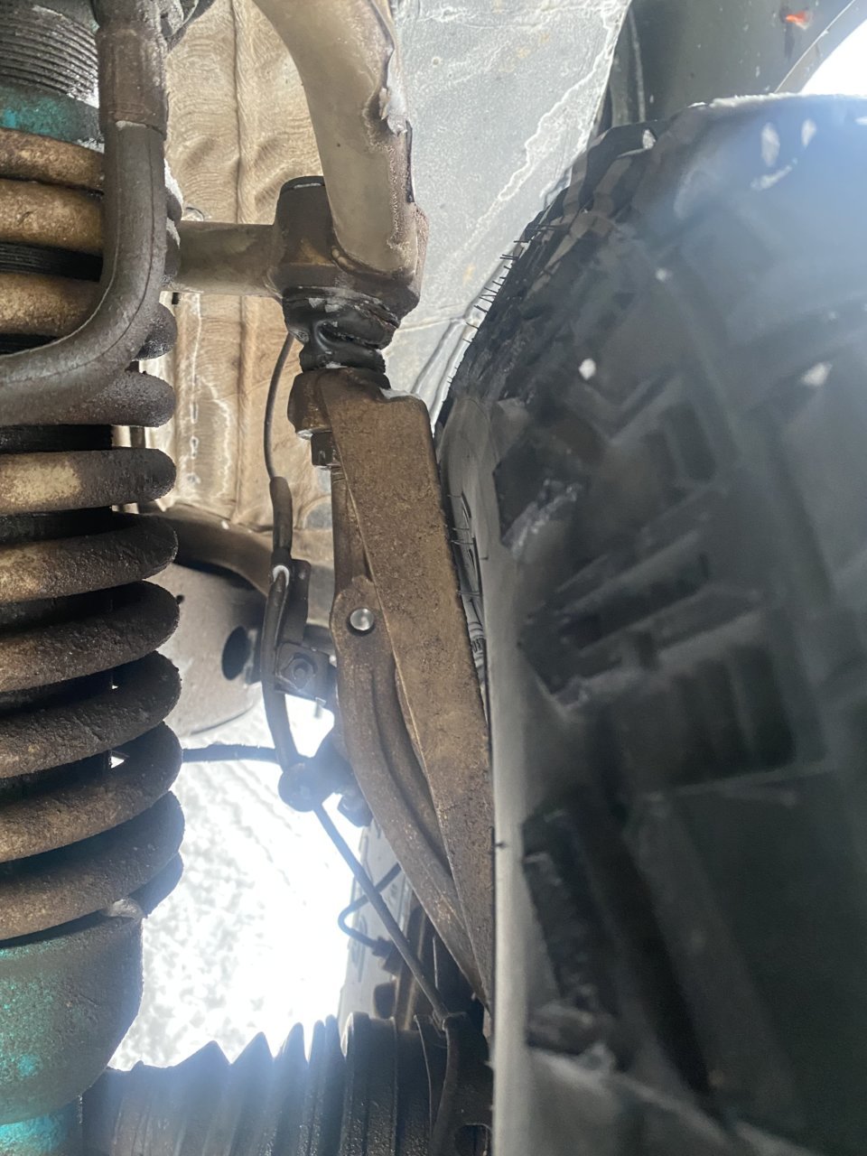

    So, hopefully these hold up a little better than the TCs, much better distribution of forces on the JD ones where the crack is, cracked in the same spot on both sides. I found the old ones to be bent ~3/8” from the hub mounting surface to the UCA bolt hole compared to the new ones.

    Only one I can find. Not hooked up. But towed this one for 3 years with the taco.
