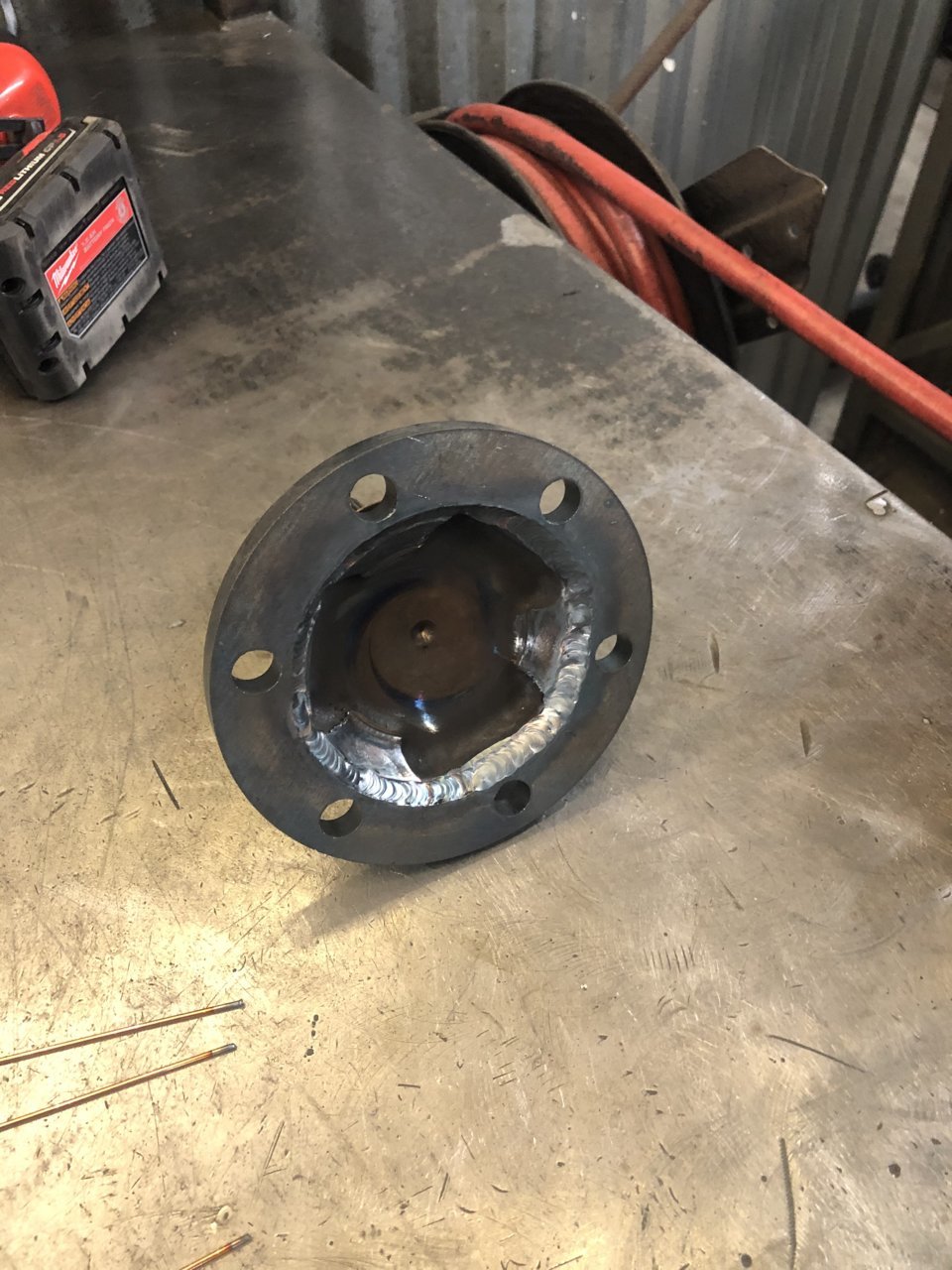

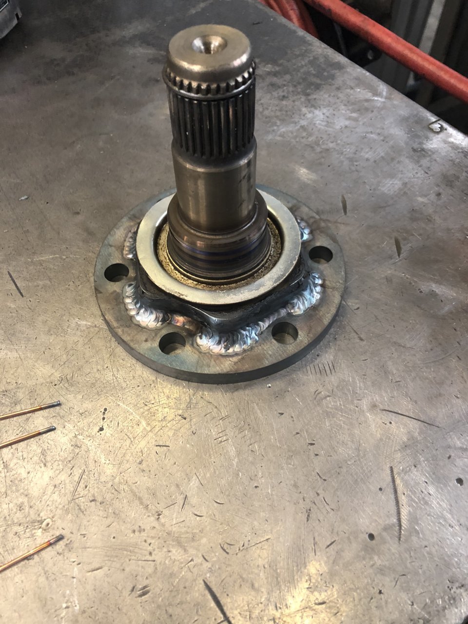

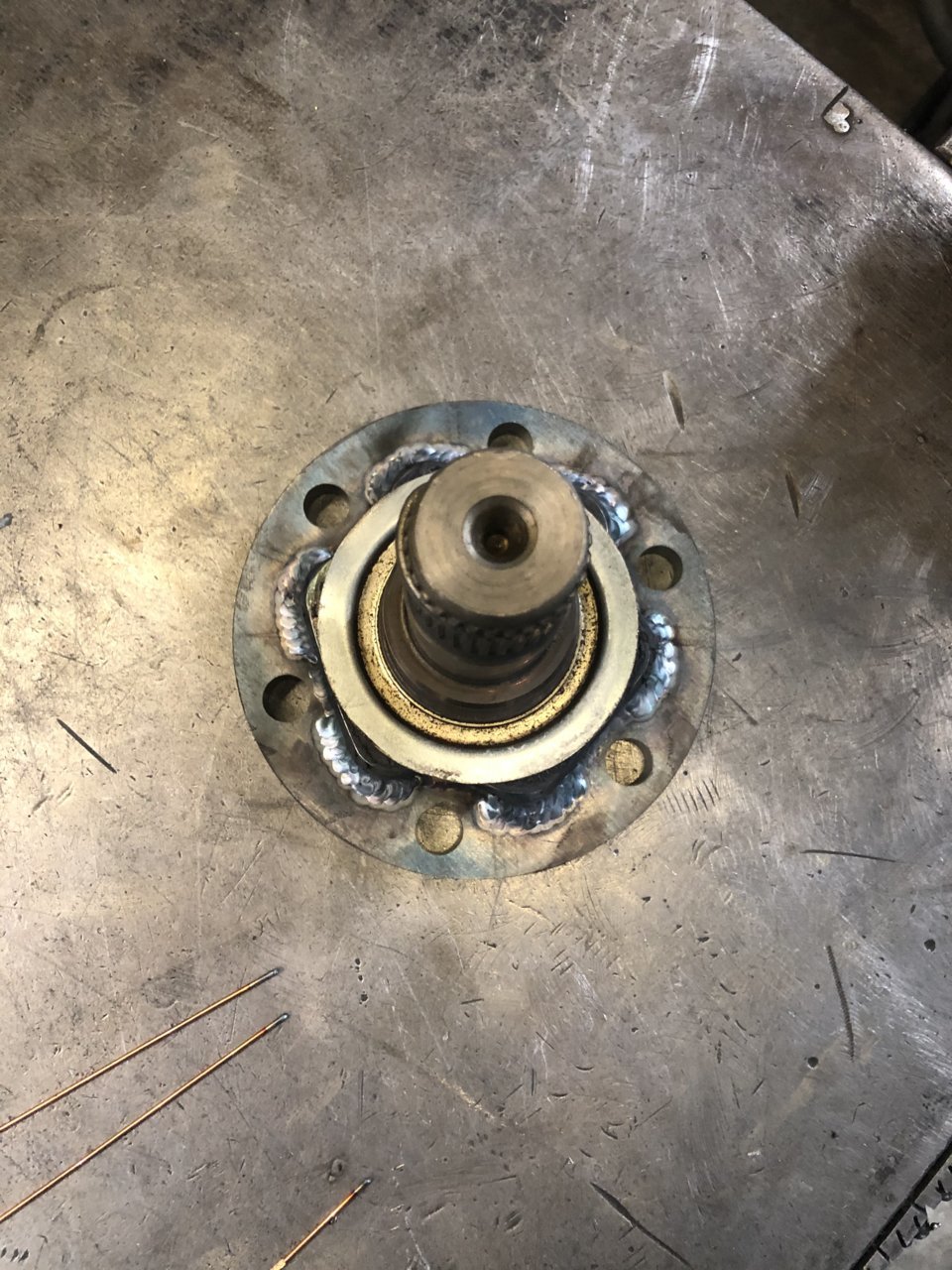

    934 flanges stitched on...
    3pooches, la0d0g, old55guy and 5 others like this.

    Lots of trial and error to make it just right :)
    CMScheid, Jpiskura, 3pooches and 9 others like this.

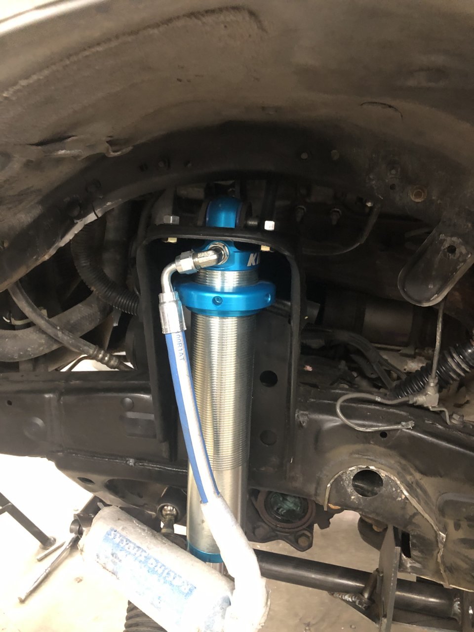

    Made some custom upper shock mounts in order to get all the uptravel in the shock

    I would want to include a cross engine brace between the coil buckets too I think. I find that at max compression I don't rub the fender well currently, but when I hit a good G-Out, I do. I think it's mostly from the coil buckets flexing inwards, among other things flexing.

    I’m gonna do a cross bar and double shear the upper arm... that will keep the bucket from flexing

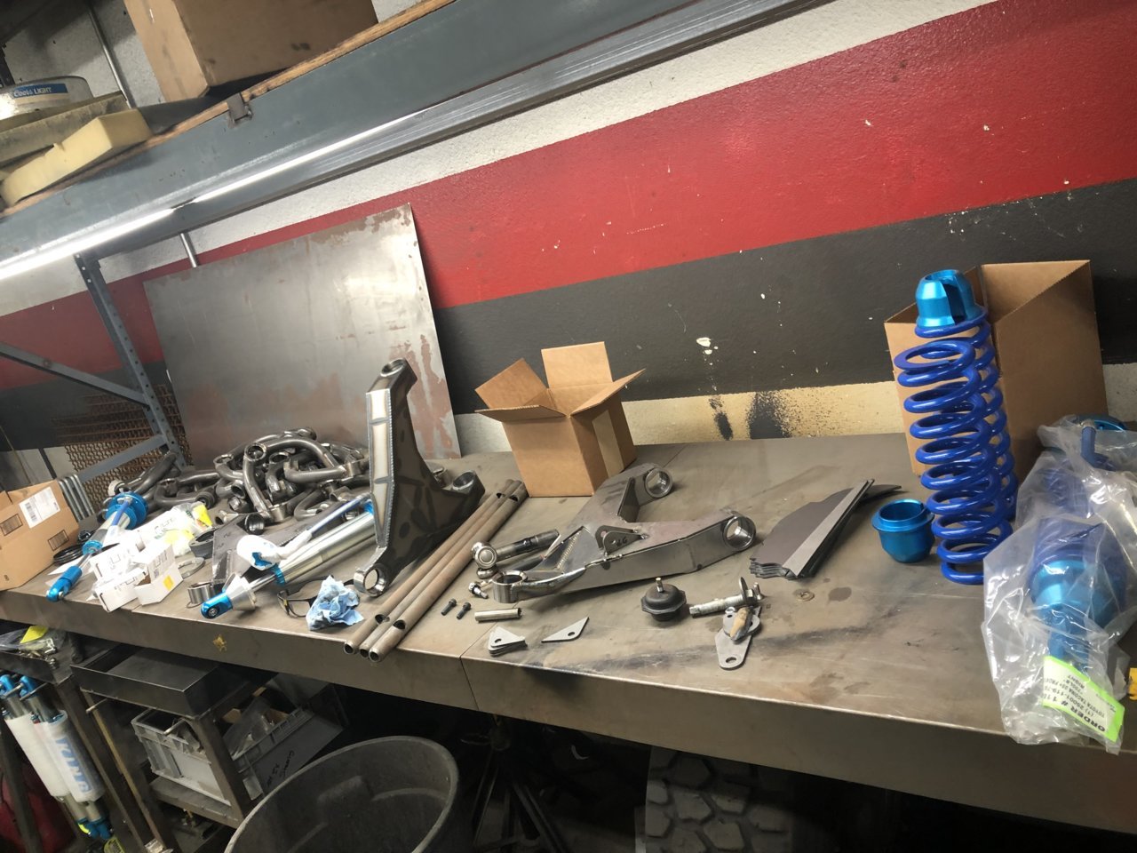

    Material just showed up for the slide rack! Still waiting on the TC pump and quickner :)
