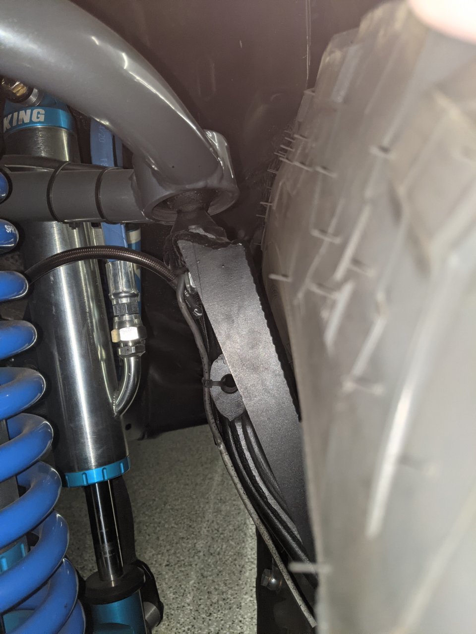

    Looks like 17's make a pretty big difference over a 16". I know if I had a bearing go, my tire will be on the gusset. I don't know if I have a full 1/8" at my tightest spot. In fact, I have rubber marks on my gussets as it is with good bearings.

    I can get any tire I want next day so that's not a problem. These are my winter set. I like a nice fat tire for around here because of snow and soft ground. Been on that skinny wagon before and they just don't get it done around here. I really don't care that it's a tight fit, but I thought it was important to note as 16's with 315's are common. And you can run the best quality bearing out there and still blow one out and have a problem in this situation.

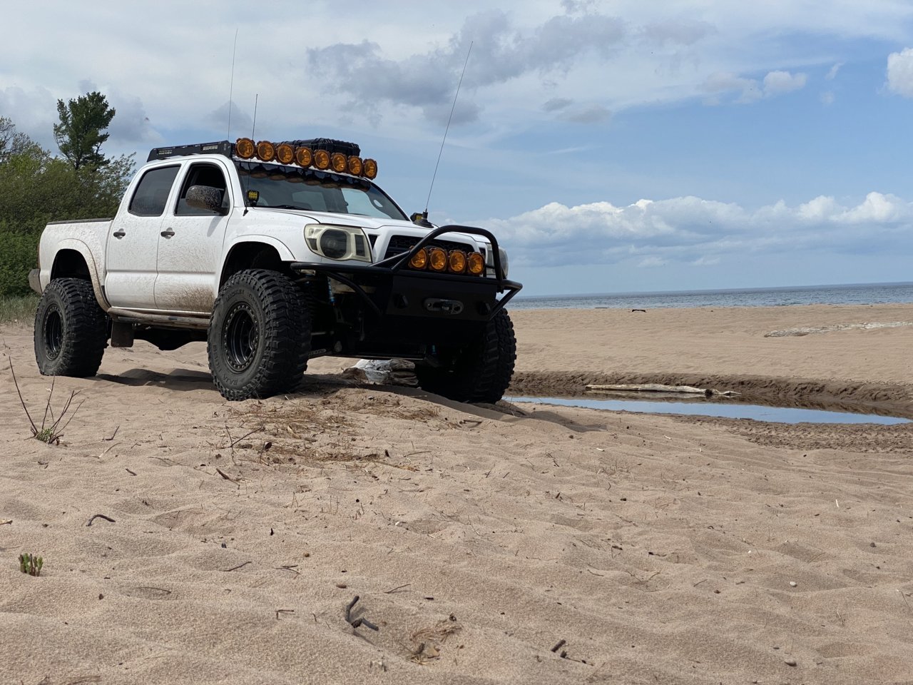

    I've ran so many different tires it's ridiculous, I have the luxury of buying tires at cost so I buy and sell tires for myself all the time. Honestly the Baja Boss's that I have on my bead locks now are hands down the best tire I have ever had the pleasure of running. I'll probably be stuck with them for a while.

    MT's. But the AT's are pretty aggressive too.

    Often. I can run in soft sand 2wd not aired down. The tight center in my opinion is what makes this happen.

    Was probably me. I'm running 17" with 4.75" bs and the wheel and tire easily clear the spindle. Only issue I had was the inside of the wheel rubbed on the lower limit strap bolt. Moved the bolt in and no more worries

    It’s interesting how some of you are able to run 4.75. Obviously it boils down to tire section width, or what spindle gussets you’re running. At 4.5 I get enough deflection that the tire kisses the gusset. Not really harmful. But I’d never get a 4.75 on mine. At least in a 16”
