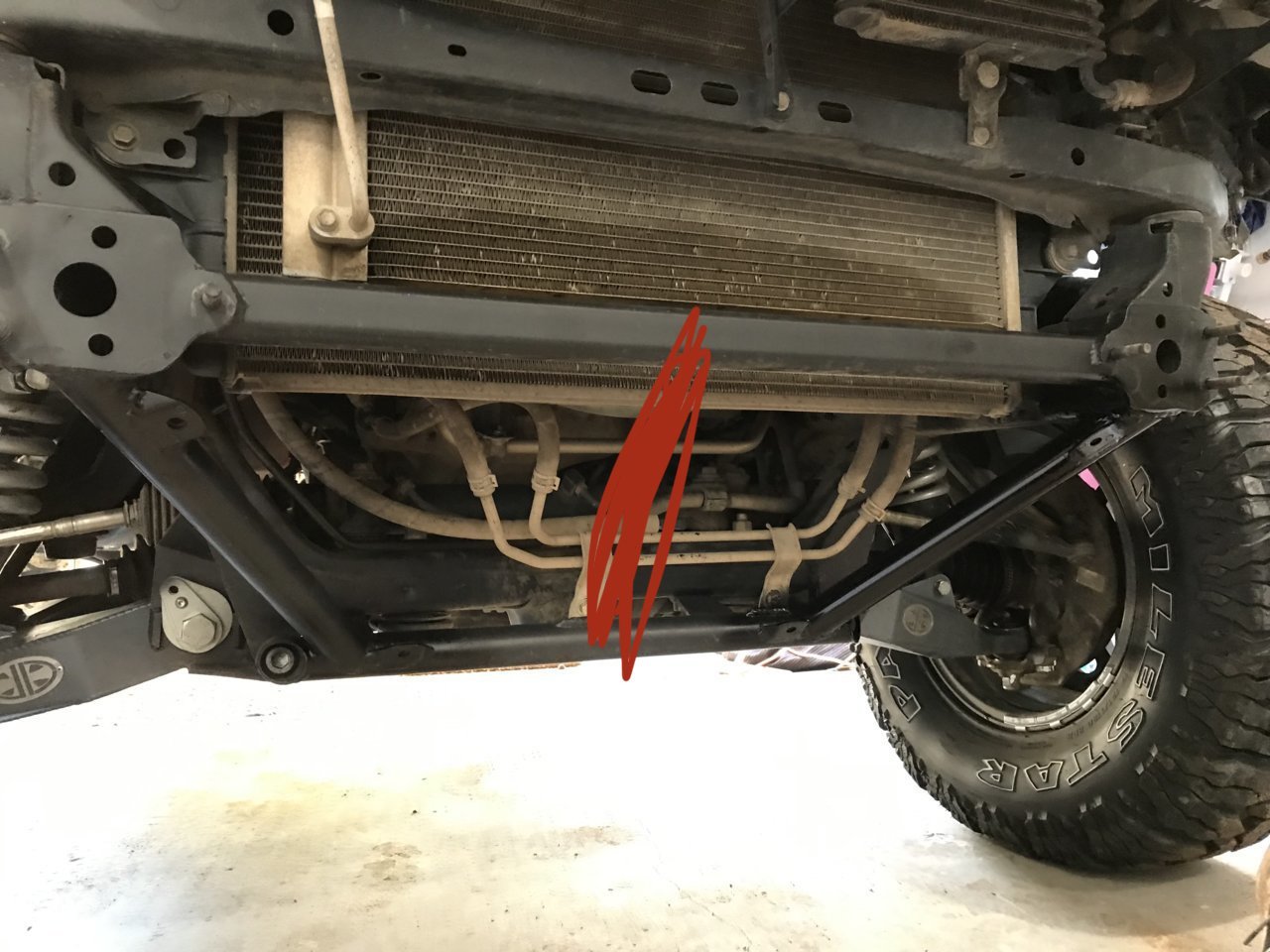

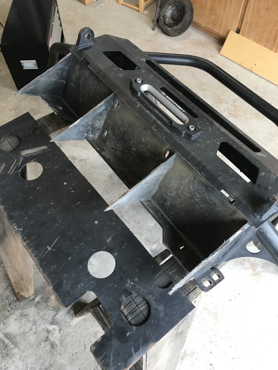

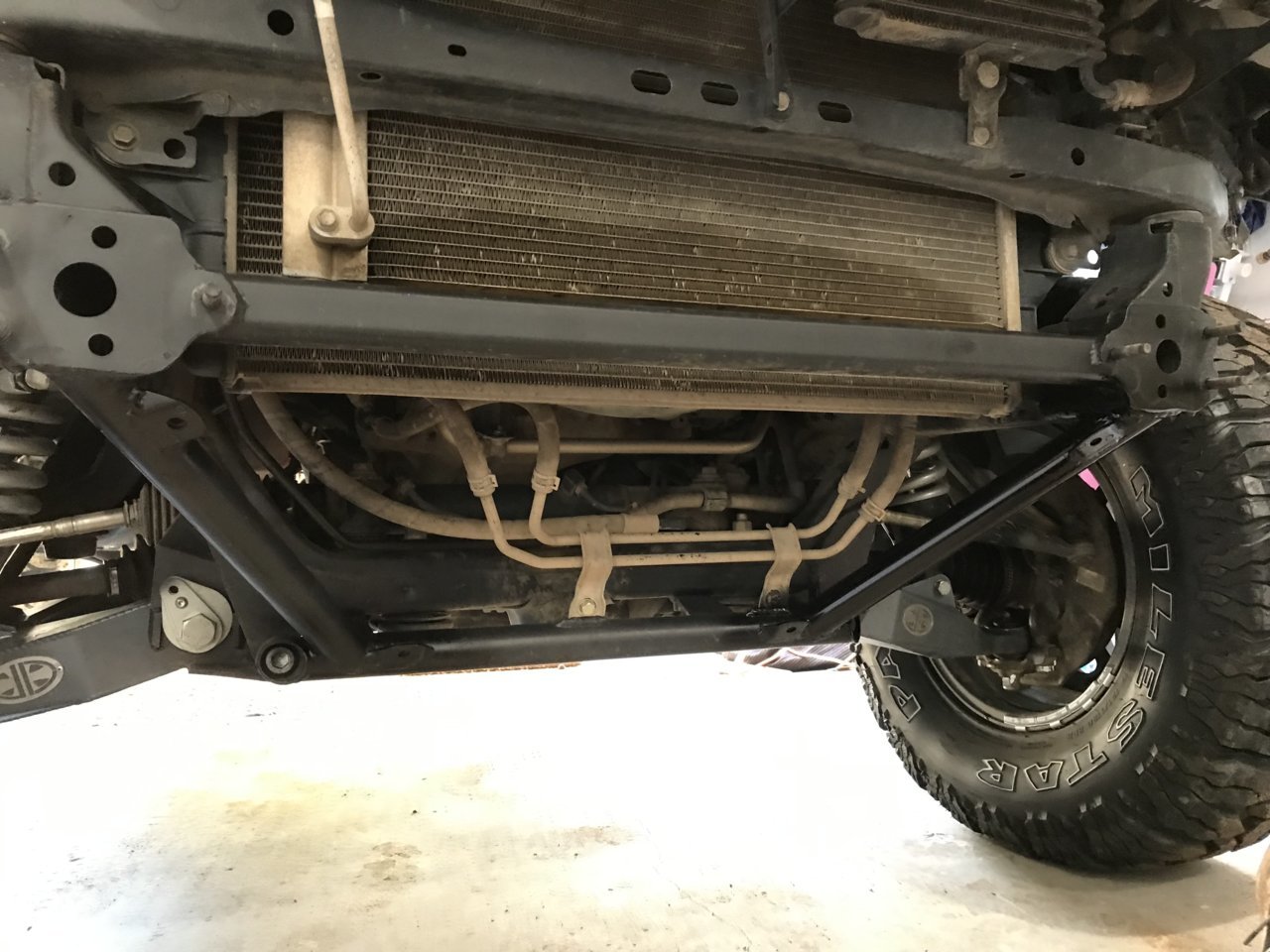

    Been awhile. Life got busy so I haven’t been on the forums for months.
    Finally took some time to start modifying the Pelfrey bumper and finish making a skid plate after doing the JD Fab relocation. Basically coping what Harry and the guys at JD have been doing for extra ground clearance.
    Hoping to have this wrapped up by tomorrow and I’ll grab a piece of aluminum early next week to make the skid.

    Will you be adding any more bars to the lower section perhaps one in the center?

    Not following what you mean by “the lower section.” As of right now, I’m not planning on adding any more tube but may in the future. Kind of just want to get it back together and see how everything works out.

    The skid plate area below the bumper mounts in front of the trans cooler lines. You have two already extending from the frame ends down to the corners of the LCA mount cross bar. I was thinking halfway between those two.

    Or maybe an "X" tying into the two that already exist at the frame and corners of the LCA mount cross bar.

    I thought about adding something there but it wouldn’t be structural so I’ll probably use smaller diameter tubing. The only real purpose would be to provide some back support for the skid plate. I’d prefer not to add a ton of extra weight.
    The two “V” tubes currently in place give the frame support and there’s already a cross bar for lateral movement.

    Plus serviceability, so you’d want to make it removable which is another level of complexity. Me, I would just leave it and have extra skids on standby and just replace as needed.
