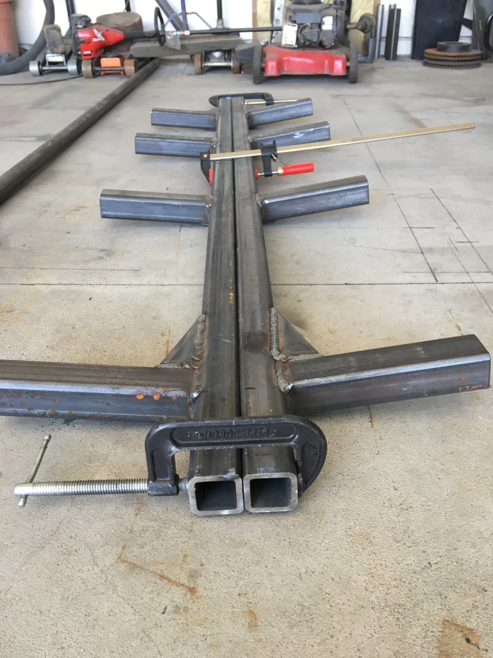

    Do you guys have any of the LCA pivot kits available right now? Was hoping to talk to someone about some questions and measurements, called a few times and wasn't able to talk to anyone.
    Could you help me with the measurements, maybe it will benefit others also:
    What is the center to center spacing of the main tubes that hold the tabs? Need to see if my existing skid plate will clear where it turns up at the sides.
    Will the kit fit with stock bump stop mounts on the frame? All the pics I've seen have that cut off already, and I know the rear tabs would come close for sure. I'm interested in keeping the stock bump stop mounts.
    Is the front tube an integral part of the kit once it is welded? I know it locates everything for welding, but I also see it unbolts, can it be removed after kit is welded?
    Does the kit come with the plates to weld the large holes in the frame? You mentioned the rear crossmember hole was welded closed. Is that part needed to fit the tabs and fully weld?
