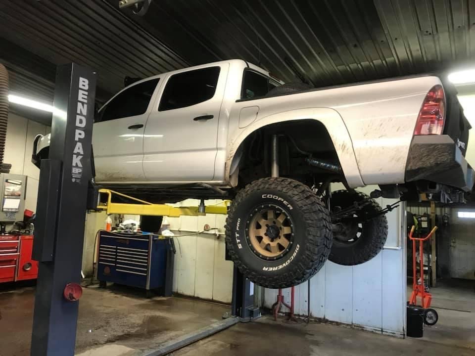

    906taco
    906taco Well-Known Member
    Jun 22, 2021
    #369289
    3,912
    Cory
    08 Taco
    To be 100% honest with you, I think I’m cycling probably 16” +. I’ve never measured it but I am using every bit of the 14” shock with the archive relocate and hammer hangers with Deaver U402’s. The drop out is actually pretty crazy.

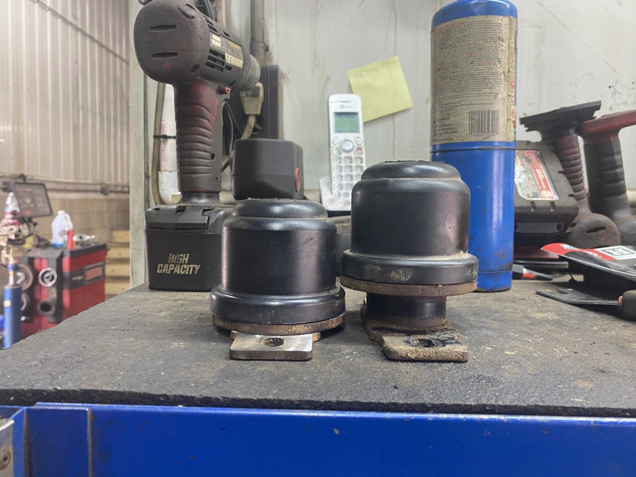

  16. Dec 31, 2021 at 9:01 AM
    906taco
    Jun 22, 2021
    #369289
    3,912
    Cory
    08 Taco
    After I did the lower pivots and slide rack my front was able to handle a whole lot more. That’s when I noticed the rear was starting to lack. I cut my bump mounts down and was able to gain a little over an inch of bump travel. It helped substantially but still isn’t fully keeping up. There are lots of little things one can do to improve SOA. But the bump travel thing just can’t be corrected a whole lot. I guess the biggest perk of SUA is you can keep a low center of gravity which obviously helps with crawling. Downfall is you lose clearance under the axle, but with a little driver mod I think it would be completely fine.
