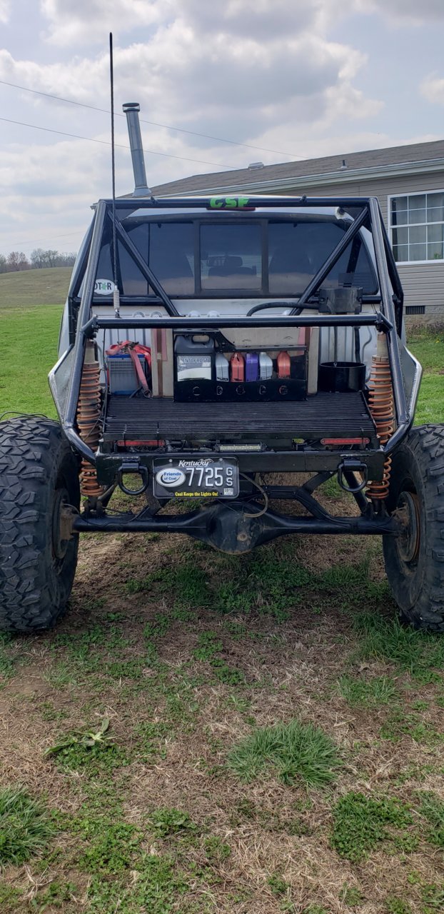

    I hate this is the only question I have for you right now, but what’d you do for taillights? Haha im looking at some 6” ovals they use on big rigs and trailers. Not really sure how three pins equals turn signal, brake light and running light. Unless high gets turn signal and brake input.

    I have a buddy that uses trailer lights. He hooked into the trailer wiring harness as that's the only way to get blinker and brake lights in one bulb that we have found. I used a led light I found on Amazon for mine.

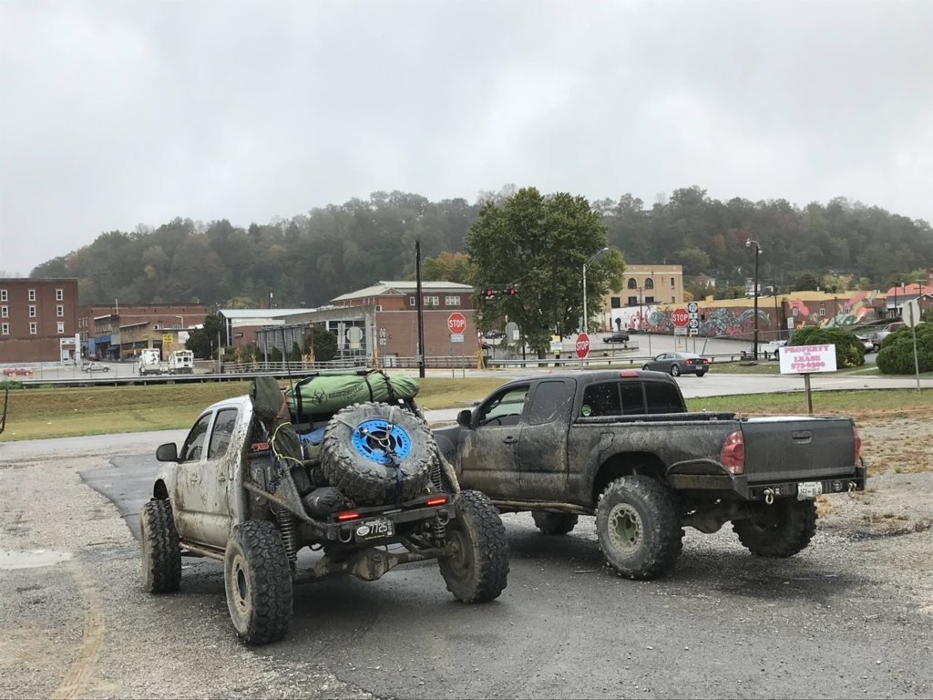

    His is the one on the right. If you zoom in you can kind of see what he did.

    Here is another one haha. Nwitaco was his username.

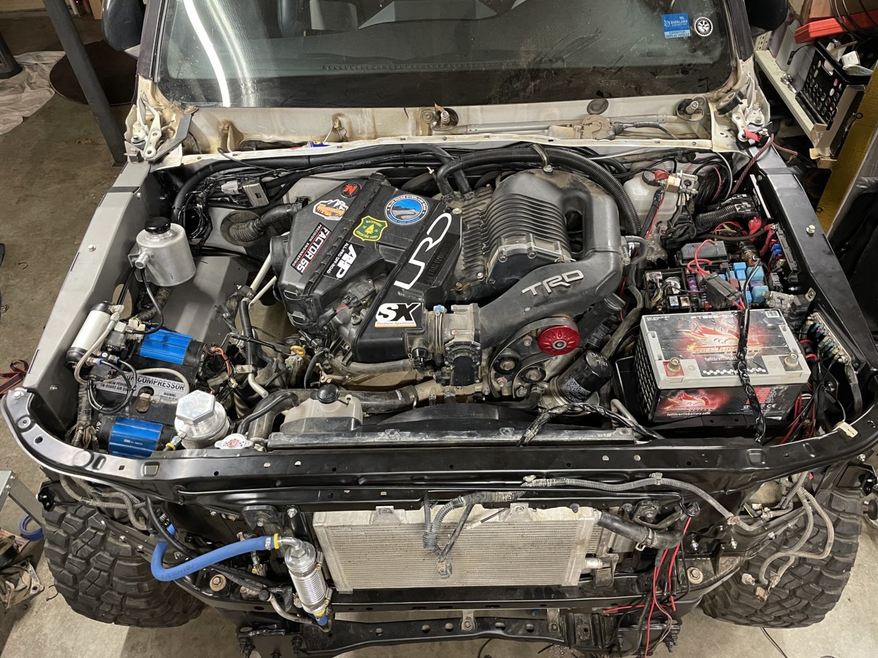

    Just about got all 5lbs of ship in the 1lb bag. I knew I’d have to redo some things with the inner fenders. I never thought I would have to redo everything! But it’s given me the opportunity to refine things even more. Should be firing it off today. It’s been in pieces for about a month and some change now.

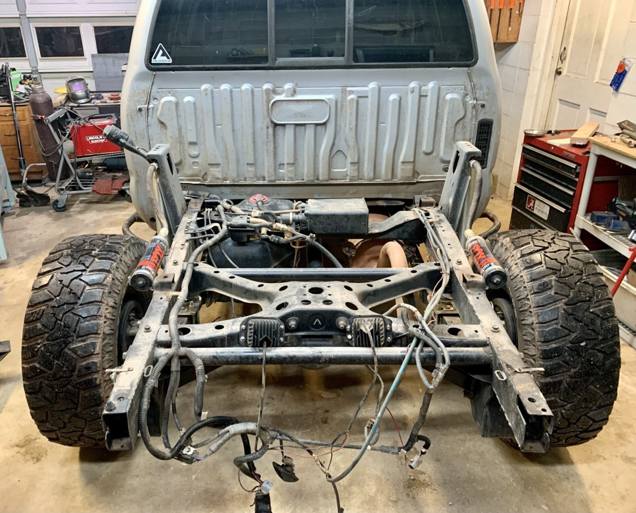

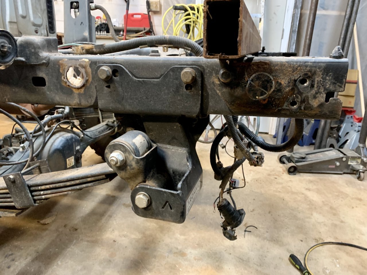

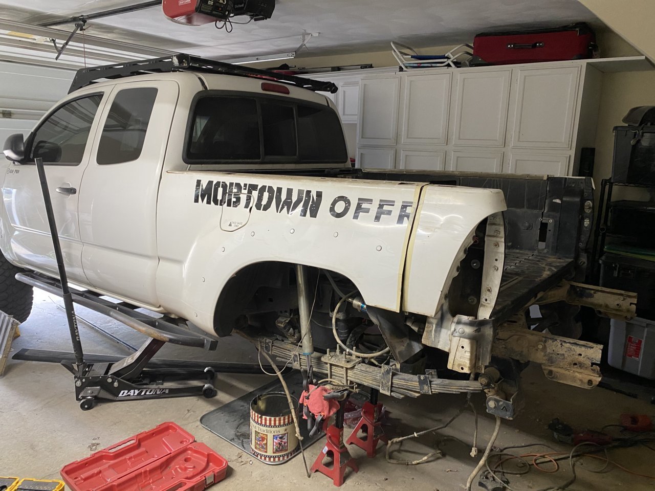

    No time like the present to get started. Any reason I shouldn’t chop the frame right past the hanger? Don’t think any other leaf suspension is going to mount further back than that. Links obviously don’t matter back there. Any way to shorten the filler neck?

    That’s where my frame is cut for my bob.

    I don’t know why it didn’t cross my mind you probably cut your frame too haha. Off it goes!

    The only consideration is what you’ll do for a rear bumper. Mine ties into my hanger bolts.

    If you end up going 63s or a longer leaf pack it'll be quite a bit further back.
