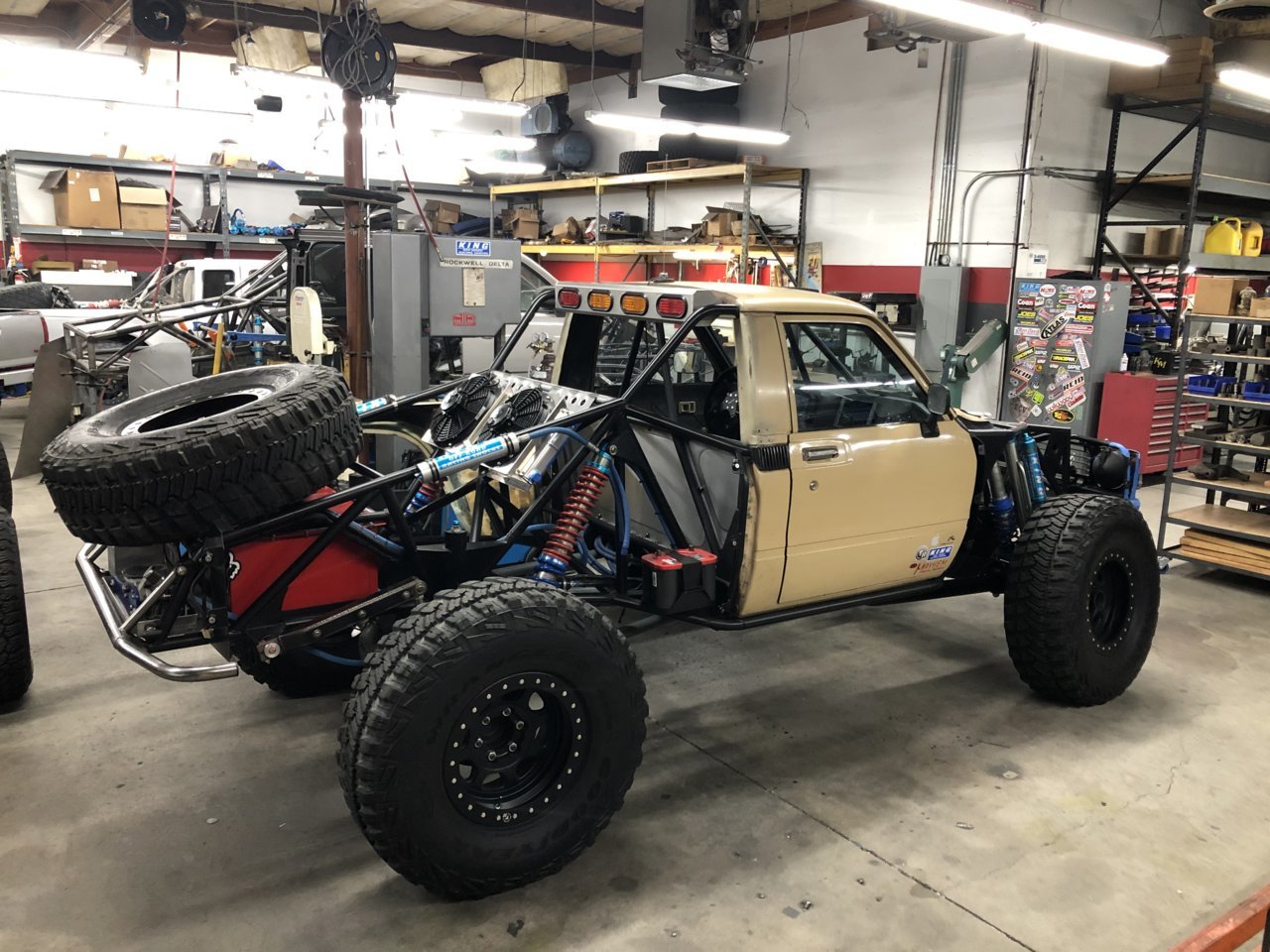

    The spring under kit will cycle 17” metal to metal and can go up another 2” with a frame notch

    My setup will cycle 24.5” metal to metal and I have it strapped at 21”

    Not interested in making a kit because to do it right you have to run a fuel cell and most aren’t willing to do that

    Would a 3-link for crawling (that clears the tank) be less demanding than a 4-link for you high speed guys?

    If you're going to crawl only, double triangulated with higher mounted lower links. Run a cell on top of your flatbed and call it a day.

    I will never do anything with a panhard bar again. The lateral axle plunge is awful with anything more than 10” of travel, there is no way around it

    FWIW, a double triangulated 4 Link really isn't that difficult to nail. It is 100% going to be the best bang for your buck for crawling. Hop over to pirate and start reading up on geometry. We have a wrangler I did double triangulated on, nothing whatsoever hangs below the axle tubes and with a 16" shock mounted to the top of the axle tube and leaned forward its pulling around 23" I had maybe a week of dicking around to get it all right. Might have 3K wrapped up into it with everything including coilovers.

    For crawling it doesn't matter a whole lot. But speaking from experience, getting the geometry right on a panhard can prove to be a bitch. I just don't see a reason to not 4 link in his case when he can just toss a cell up on his flatbed for a relatively low cost for big gains.

    Yes because it causes the axle to shift a lot from side to side. You could end up with a DS hitting the gas tank or exhaust when it shifts. Not to mention the flex "steer" that's induced. Then loose a top link and you destroyed your DS at minimum.

    This discussion caused me to do some digging into replacing the fuel tank with a fuel cell and there's really not any good info on this site regarding it. I found that interesting considering the vast amount of prerunners there are that put a fuel cell in.
