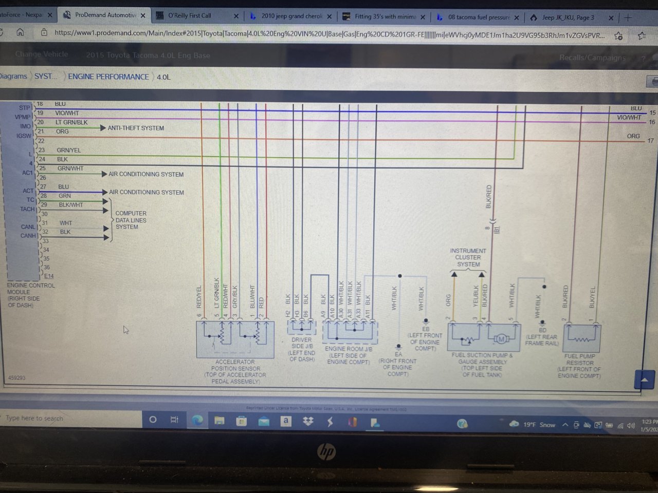

    It doesn’t work like that with a Tacoma, the ECU needs to talk to the fuel pump

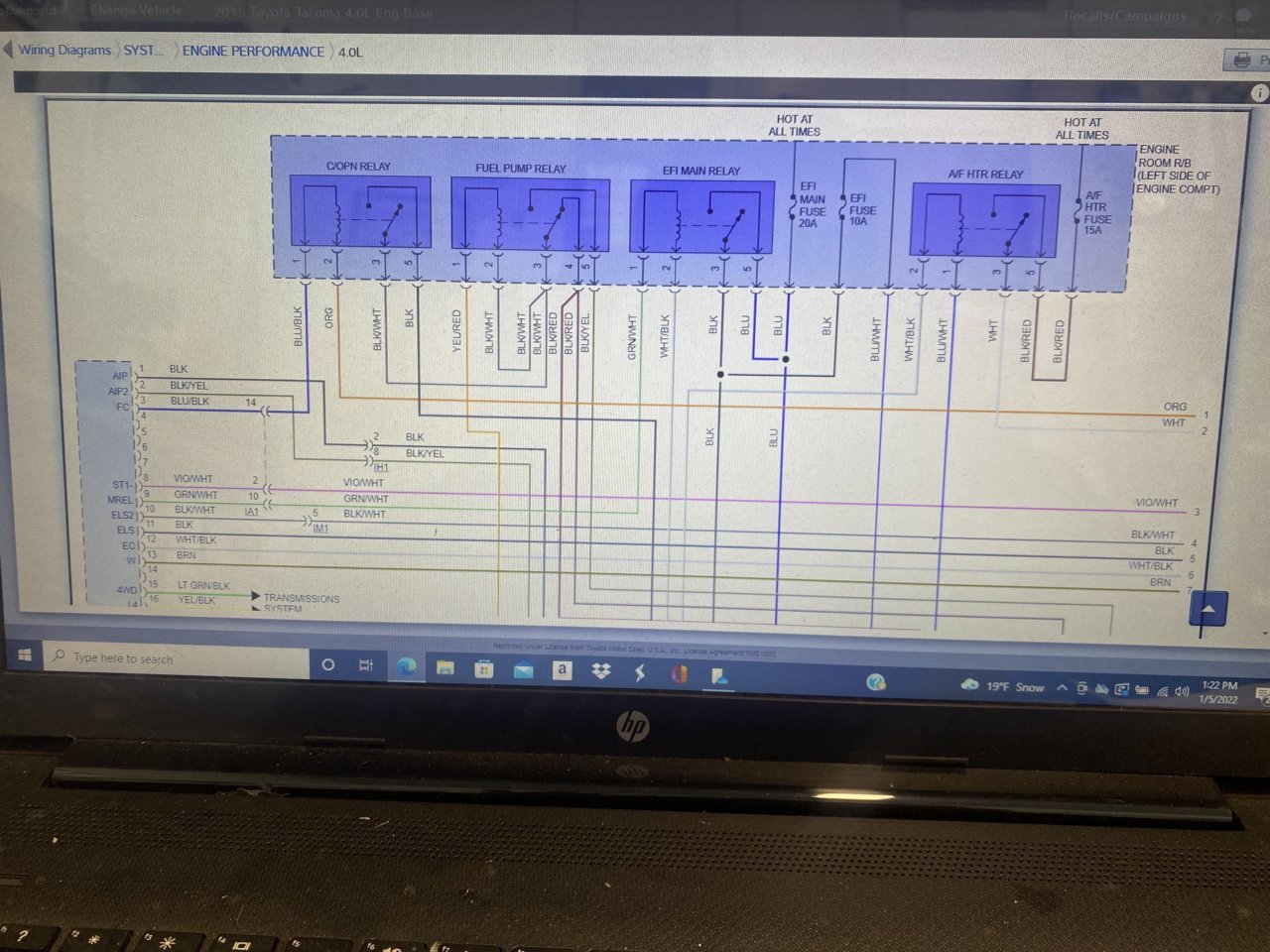

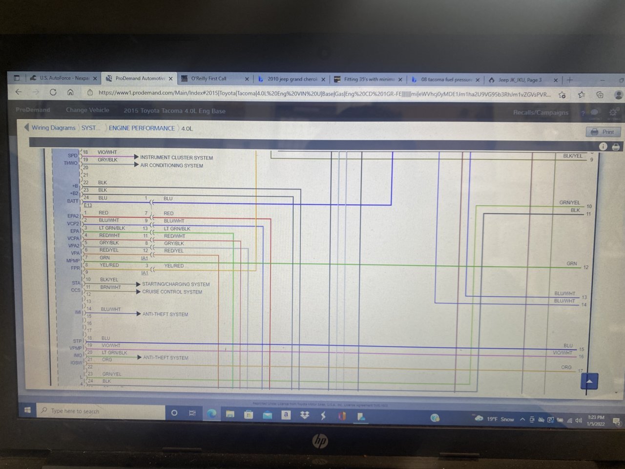

    Are these PCM regulated pumps? I guess I was unaware of that considering it has a FPR.
    Looking at the wiring schematics, I see no reason an inline pump cant be wired up. Unless I'm missing something here. Only thing running to the PCM is the fuel pressure cut off so the pump doesn't run constantly with key on.

    Here’s the schematics, all I see going to the PCM is the yellow wire off of the relay for the pressure cut off. Theoretically you should be able to wire it exactly the same as factory. I know for sure others on here have done it. Maybe ask around on the LT thread?

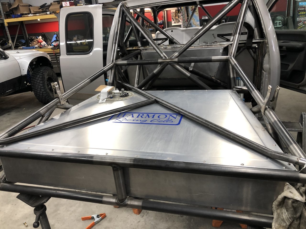

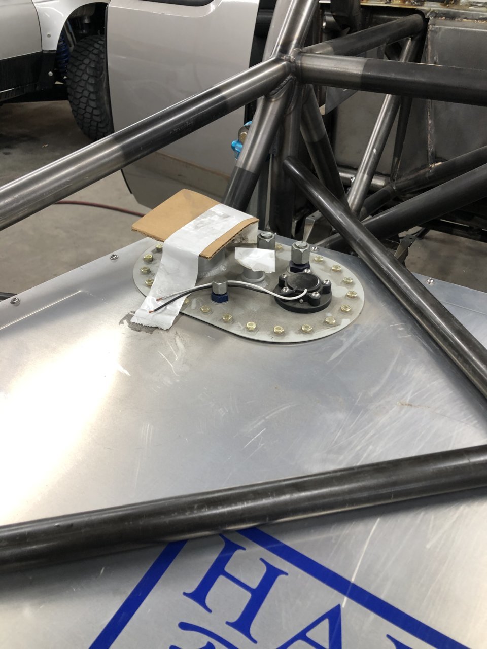

    You can have Harmon make a cell and then use the factory in-tank pump
