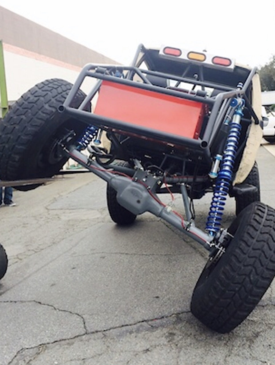

    Ya, I have seen 3 links work well and the lateral movement didn't seem to hinder them. Bmetchos truck worked really well with a 3 link, he beat on it too
    https://www.tacomaworld.com/threads/toyotally-awesome-08-tacoma.328604/page-17#post-10716302

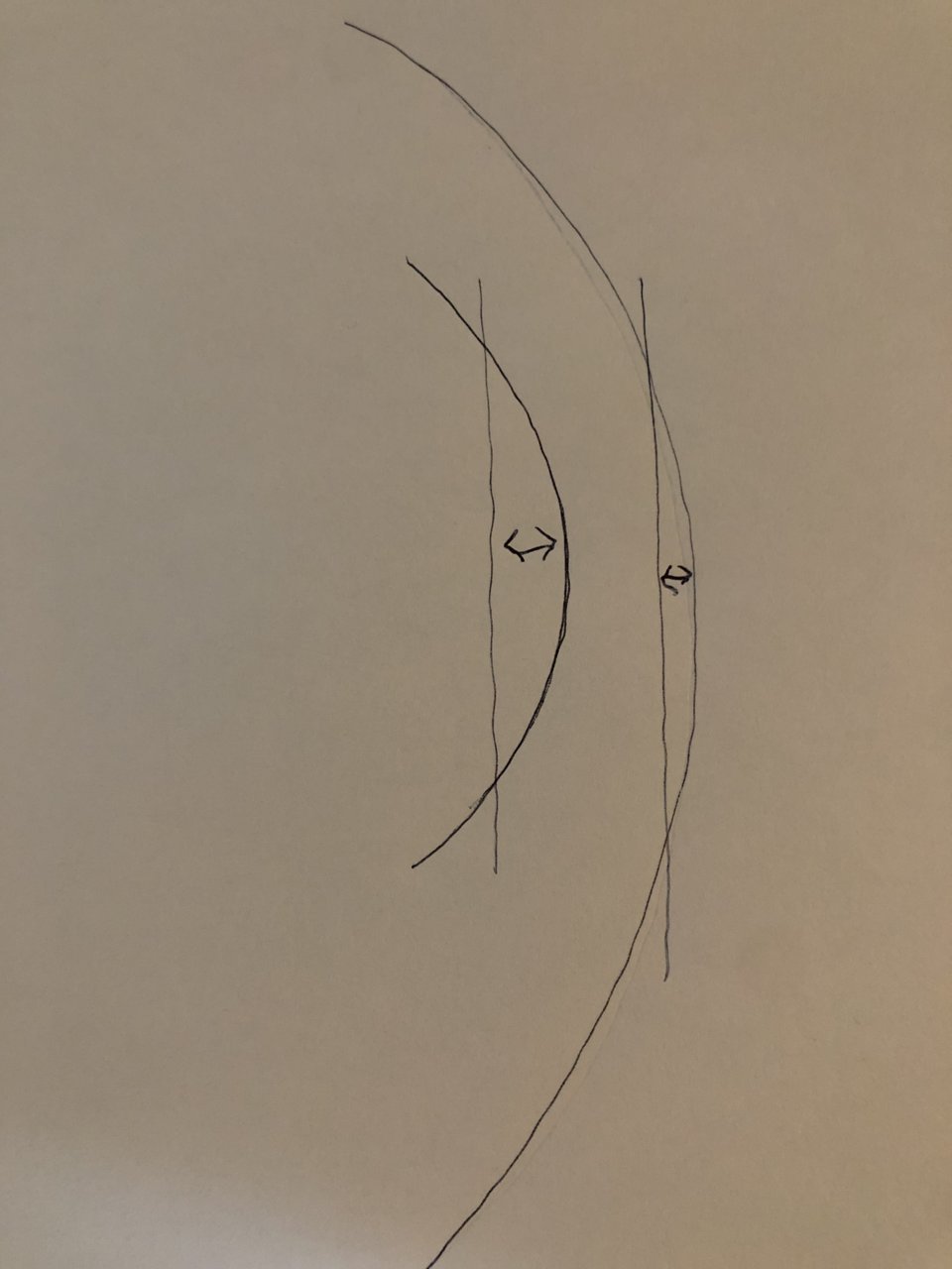

    Brian’s truck is 100% good geo. It super nice, he was a builder for a race team so he knows his stuff. You can’t always get it perfectly flat without sacrificing other clearances though.
    The length of and the level pan hard at ride height both minimize the lateral movement.
    Length of panhard - take a pencil and draw a 4” radius starting from the center then draw an 8” radius. The larger radius equates to less lateral movement.
    Level panhard - When you start from the center of the radius you are traveling in less of the curve = less lateral movement.
