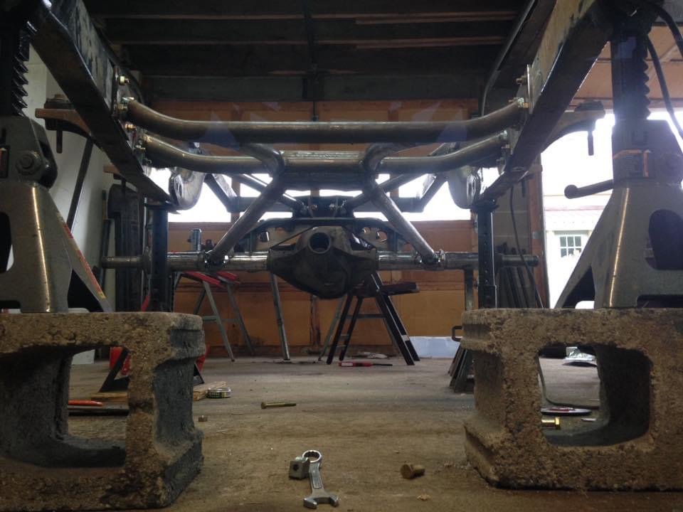

    This is the double triangulated I did on our wrangler years ago. Once you read up on the geometry enough it’ll all make sense. If I recall my upper links are somewhere around 40% shorter than my lowers. You want a longer lower arm. These ones go all the way to the trans crossmember.
    Another cool thing is, you can stretch out your wheel base if you want when you link. On this wrangler I went from 93ish” to 115”. Tires poke out a little beyond the front and rear bumpers. So the approach angle is about as good as it comes.
