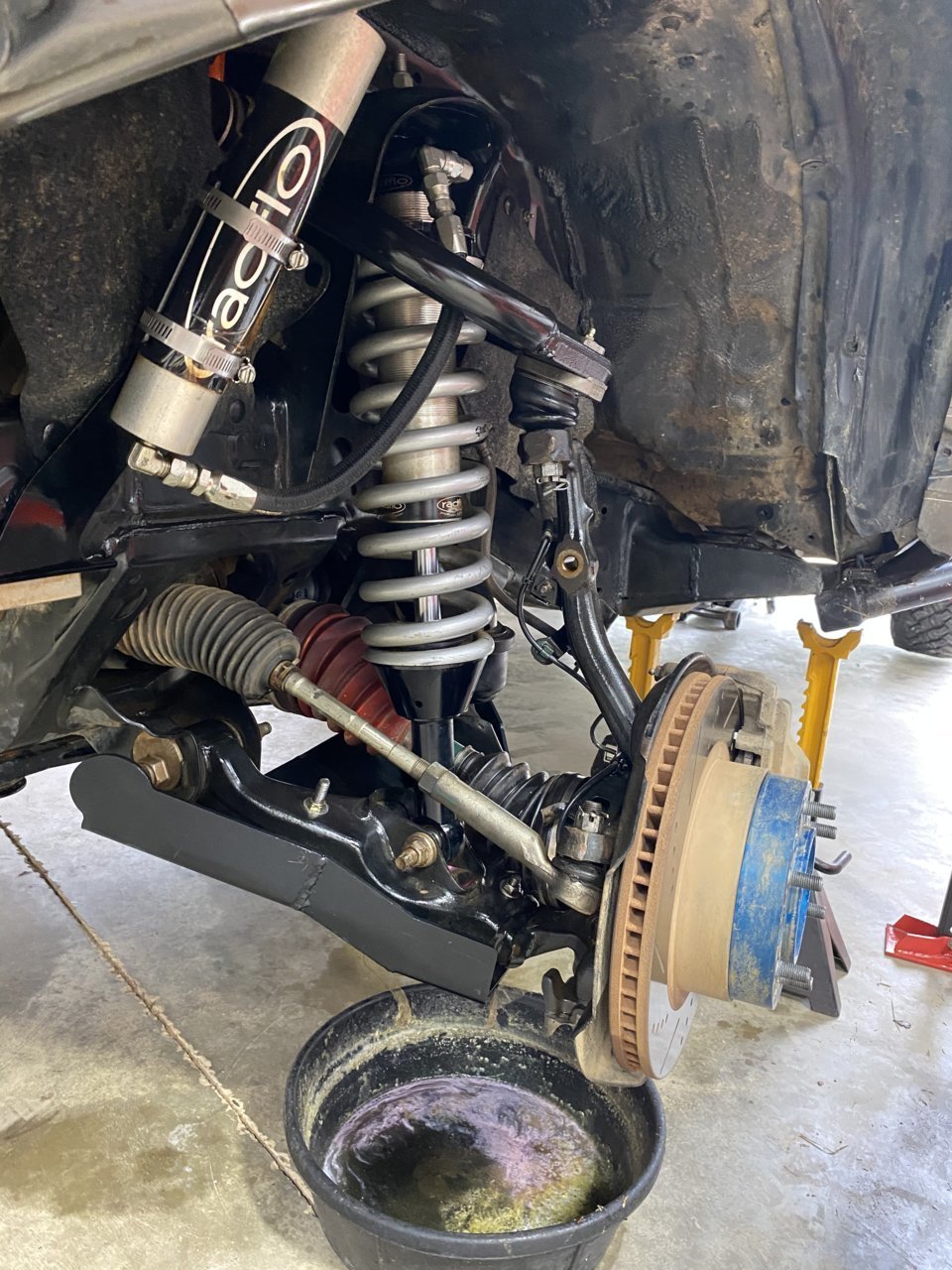

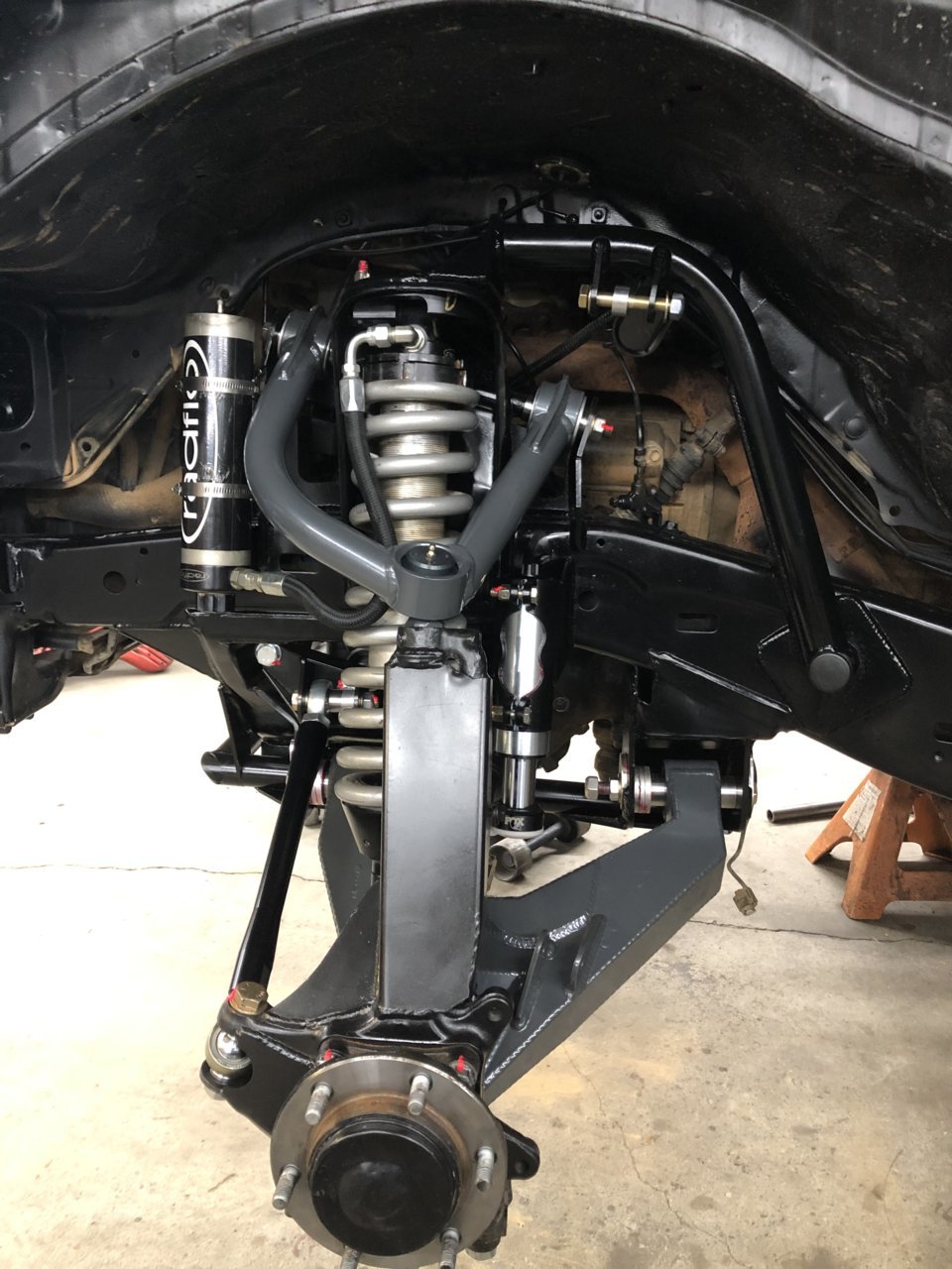

    Im running some radflo coils so id be a test dummy for this to work. Id assume they aren't much different than the other 2 brands as far as fitment.

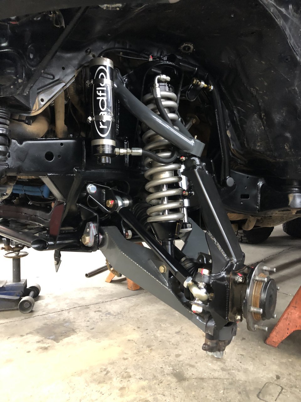

    2.25 LT, LCA pivots, 934 CV’s, slide rack with a second Gen Tacoma rack, TC pump, billet tie rods, bypass mounts, upper arm double shear, spindle double shear and Radflow coilovers, bypass shocks and bumps

    What length are those radflos?

    8” but radflow runs smaller bodies so I mounted them under the bucket with their top hats

    Would this work with my 8inch ones on the Tacoma kit? @81Trekker

    They will work, how much travel you end up with depends on the shock and Radflow is something I know nothing about. You’re going to have to cycle it out and see if a top hat spacer is needed

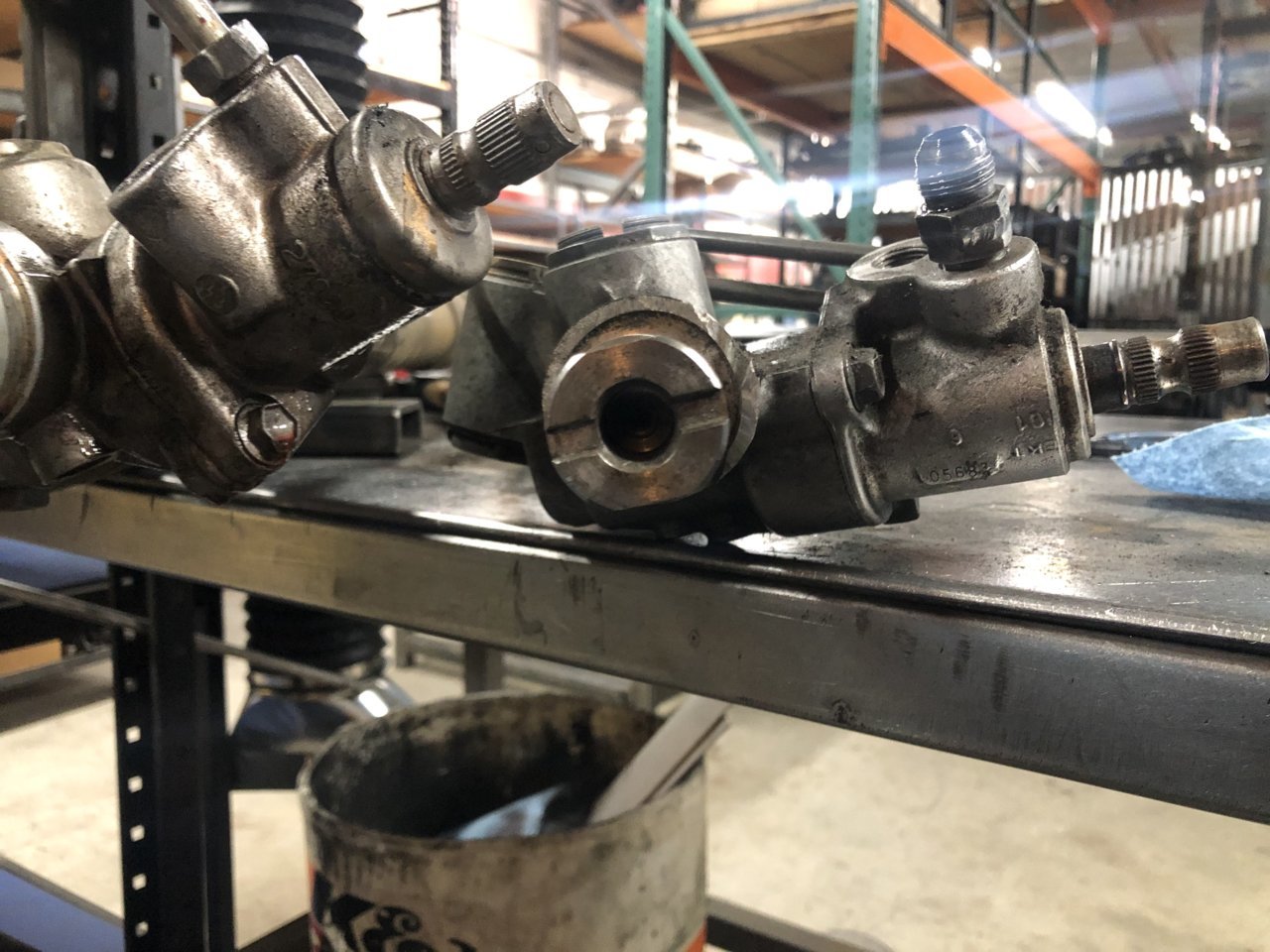

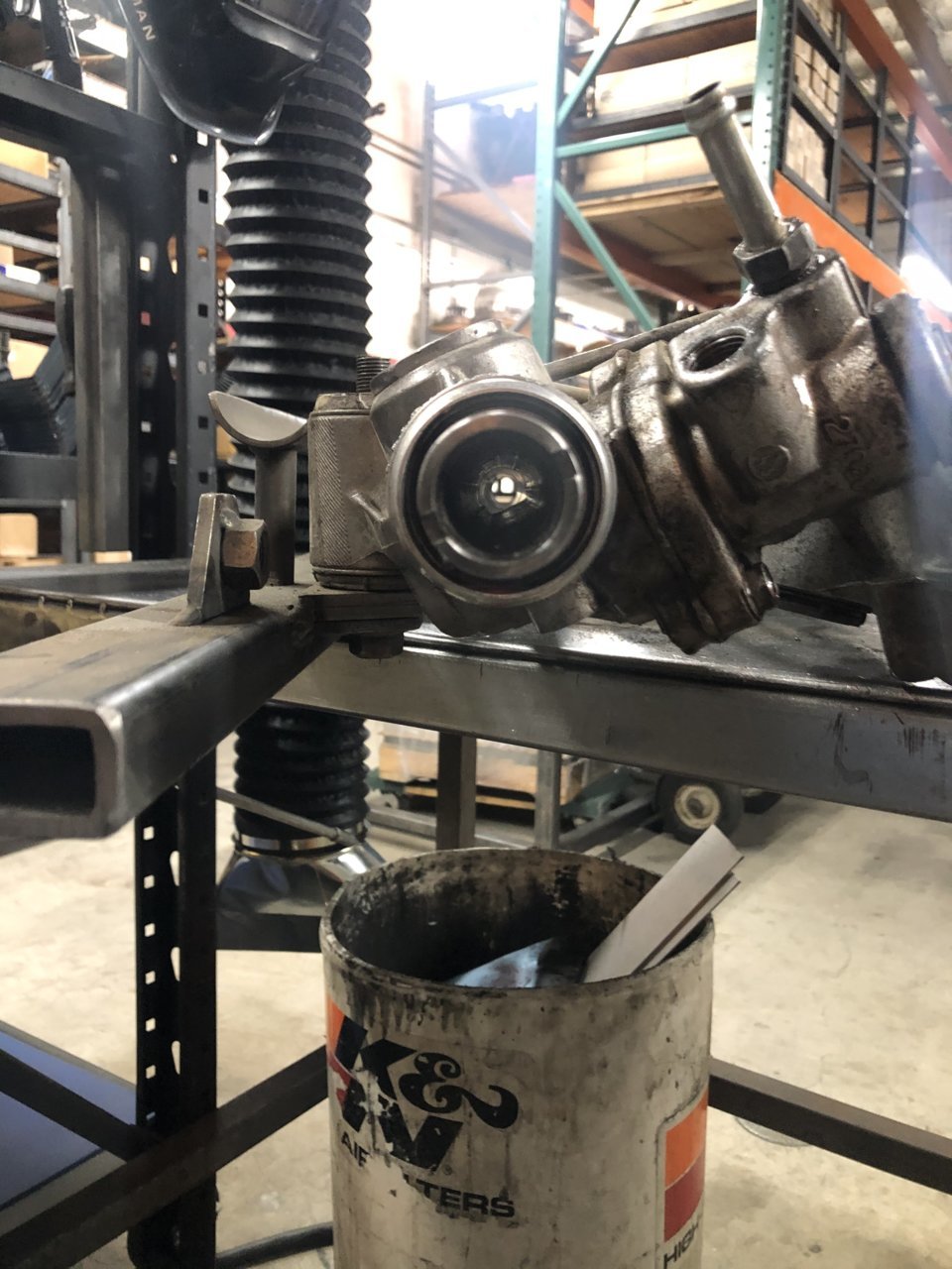

    Did you have to use the taco rack due to the 4Runner ITRE bolt size?

    The 4 runner and Tacoma racks have identical dimensions however the 4Runner rack is hollow where as the Tacoma rack is solid. Also the Tacoma uses o ring pressure fittings instead of flare fittings so our TC pump kit already have the fittings for the o ring style.

    Interesting, so weird they have all these minor differences in the front end between the taco and 4Runner.

    Interestingly enough, the taco rack is also hollow but the ends are solid. Looks like its likely the same rack with different size inner tie rods. I am curious as to why they would be hollow and not solid.

    There has to be some way to vent air back and forth between the boots, as the rack traverses, so that they don't suck in water/mud. The Taco rack has a smaller hole under the rack gears, and vents out the passengers end, as I recall. The Tundra rack does the same thing.

    I like the vent crossover tubes between the boots the best.

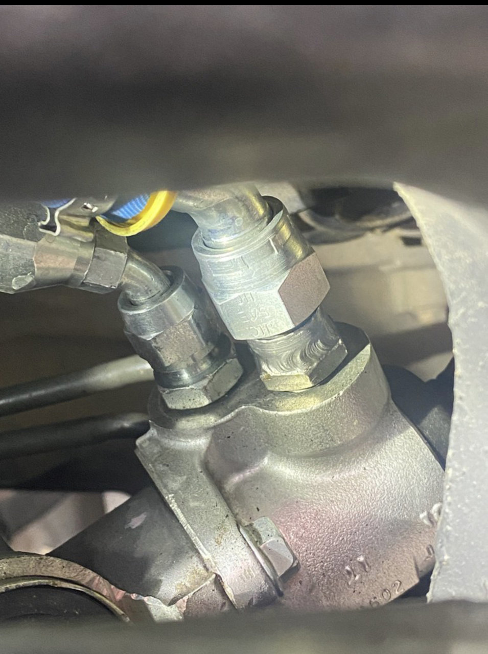

    hey @81Trekker do you have a -an fitting for the return out of the rack? I've only found one place that said they had the right fitting but couldn't find anything to verify that its the 17mm correct threads.

    I make them by machining and tig welding two fittings together
