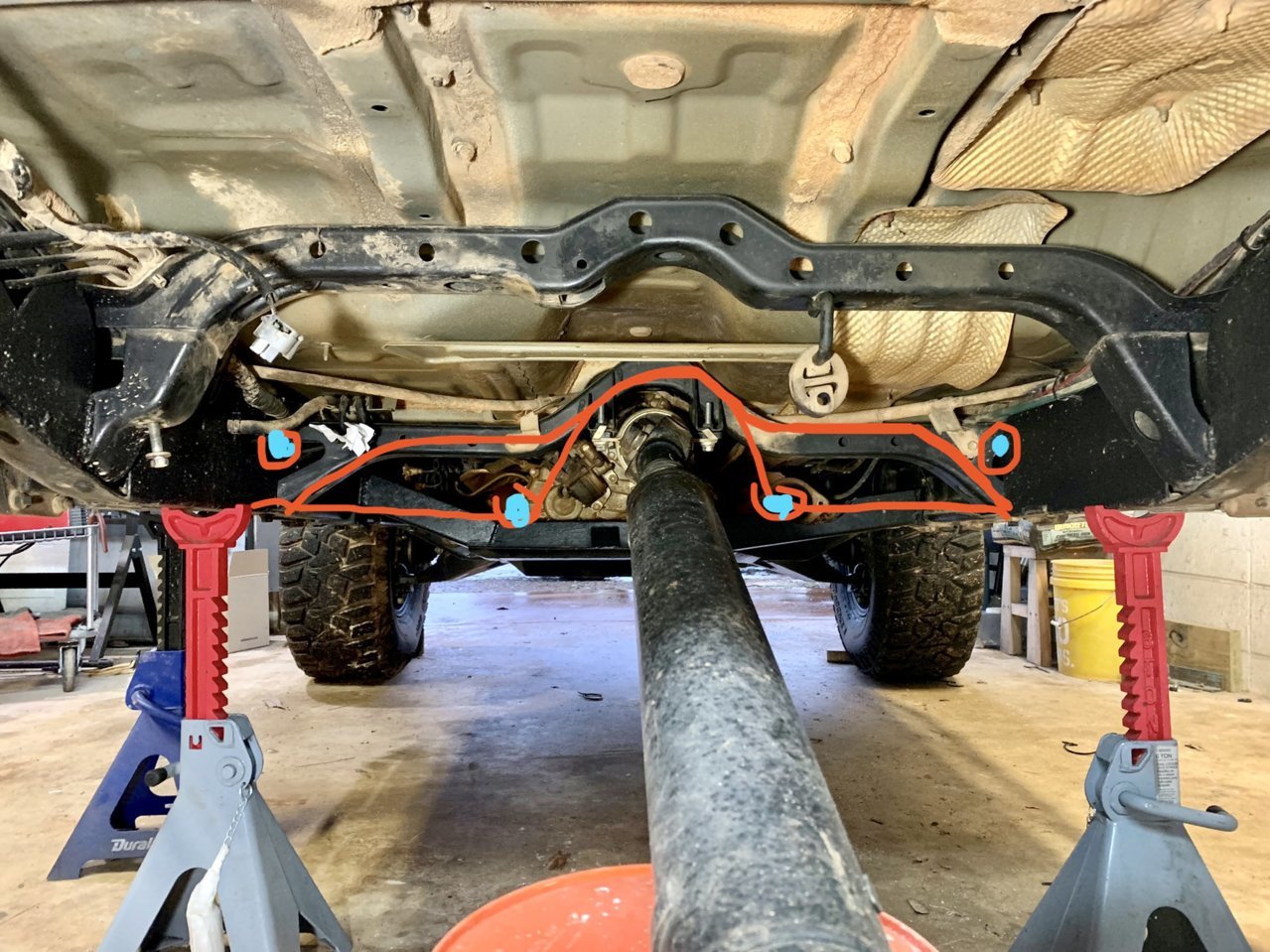

    Now that the tank and exhaust are out of the way it’s much easier to see what’s going on. I haven’t put a tape measure to anything yet, but my first thoughts are mounting the frame side links in the blue spots. I’d bend a tube (red) that follows the carrier bearing crossmember and weld it to that and the frame and come off of that for the lower links. That should put my links and driveshaft almost identical in length. Again, no idea what spacing or separation or degree when at ride height. Just speculating and hoping to get some feedback.

    Do you ever plan on adding a second t-case? Single piece shaft etc? Because if you do now is the time to do it so you can build around everything and not completely bone yourself down the road when you decide to add either or both.
    Before you even start thinking about mounting location etc you need to ask yourself these questions and put some real thought into it. If you plan to build a legit crawler, you will at some point want a second case. That will shorten the driveshaft and at that point it would be time to go single piece. Do you want a longer wheel base? You’re way too early In to be thinking about mounting.

    I don’t see myself ever adding a crawl box or anything like that. It will never be a true crawler. I just want at least 20” out of the rear and the fun/knowledge of building it.
    edit: not seeing how 20” will be possible without doing trailing arms. I’d like to fit 18” coilovers, but am not sure if the springs will be too soft at full droop after doing more research. Looks like 16” coilovers are max for a non trailing arm set up.

    this is the part where you need to stop asking for other peoples advice and start doing the math specifically for your truck. google “offroad link calculator” there are a couple of excel based link calculators that are super easy to understand and as you work through the process of filling in the calc’s & changing dims you’ll learn as you go. those dims will dictate where you need to mount your pivots. there are so many different things to take into consideration and each item interacts or affects the other, lower lengths, upper lengths , spread from uppers to lowers at axle, spread from uppers to lowers at pivots bit if you work through that calculator you’ll learn it all as you go.
    The #1 thing you should be looking at is fulling boxing your frame and moving anything inside the frame rails before you start anything else.

    Yeah I’m just now crunching some of the numbers and starting to see how it will come together. I grabbed the four link calc Jake from Busted Knuckle recommended in one of his videos. Those videos are hugely helpful.
    My only concern is maybe making the links too long? It’s nearly five feet from the axle tube to the carrier bearing. It would put the lowers at approx 7 degrees at ride height mounted to the bottom of the axle which sounds great, but how long is too long? Any reasonable risks in strength going that long?
