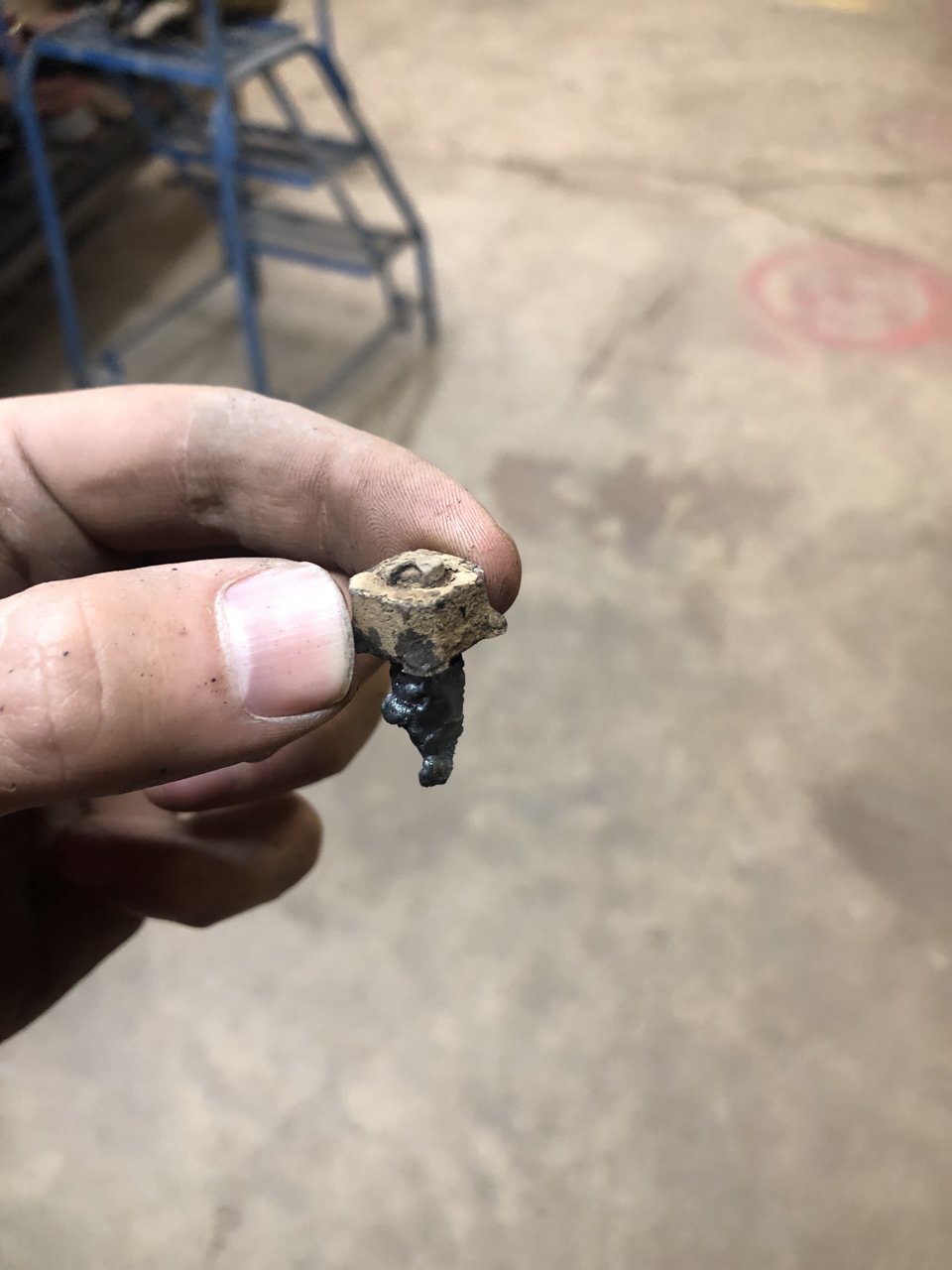

    Only photo I have from repairing the front end with @Skell
    cross member weld nuts were broken and stuck in the gross member. Turned them to liquid to get them out.
    Bent the LCA mounts back before any photos were taken :(

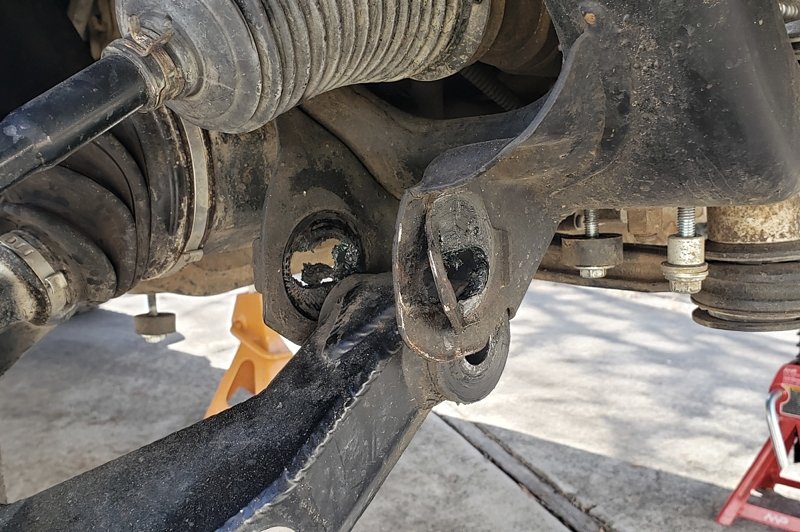

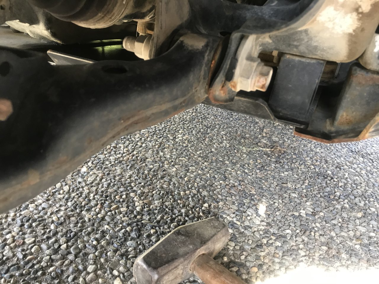

    This is as much as I could hammer mine in without removing lower control arm... still don’t think I’ll win...
    (Seriously didn’t hammer it in, rocks do the work for free)

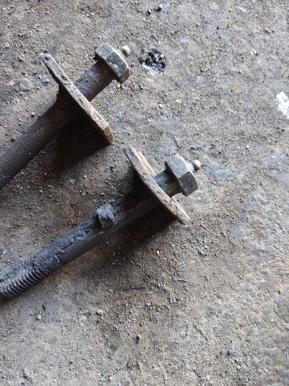

    Here's my alignment plates IMG_20200408_130241976.jpgBent to match the tabs.

    Thanks, apparently 3/16 alignment plates over the Total Chaos gussets wasn't enough.
    I just wish I could point to a single incident or hit that did it.

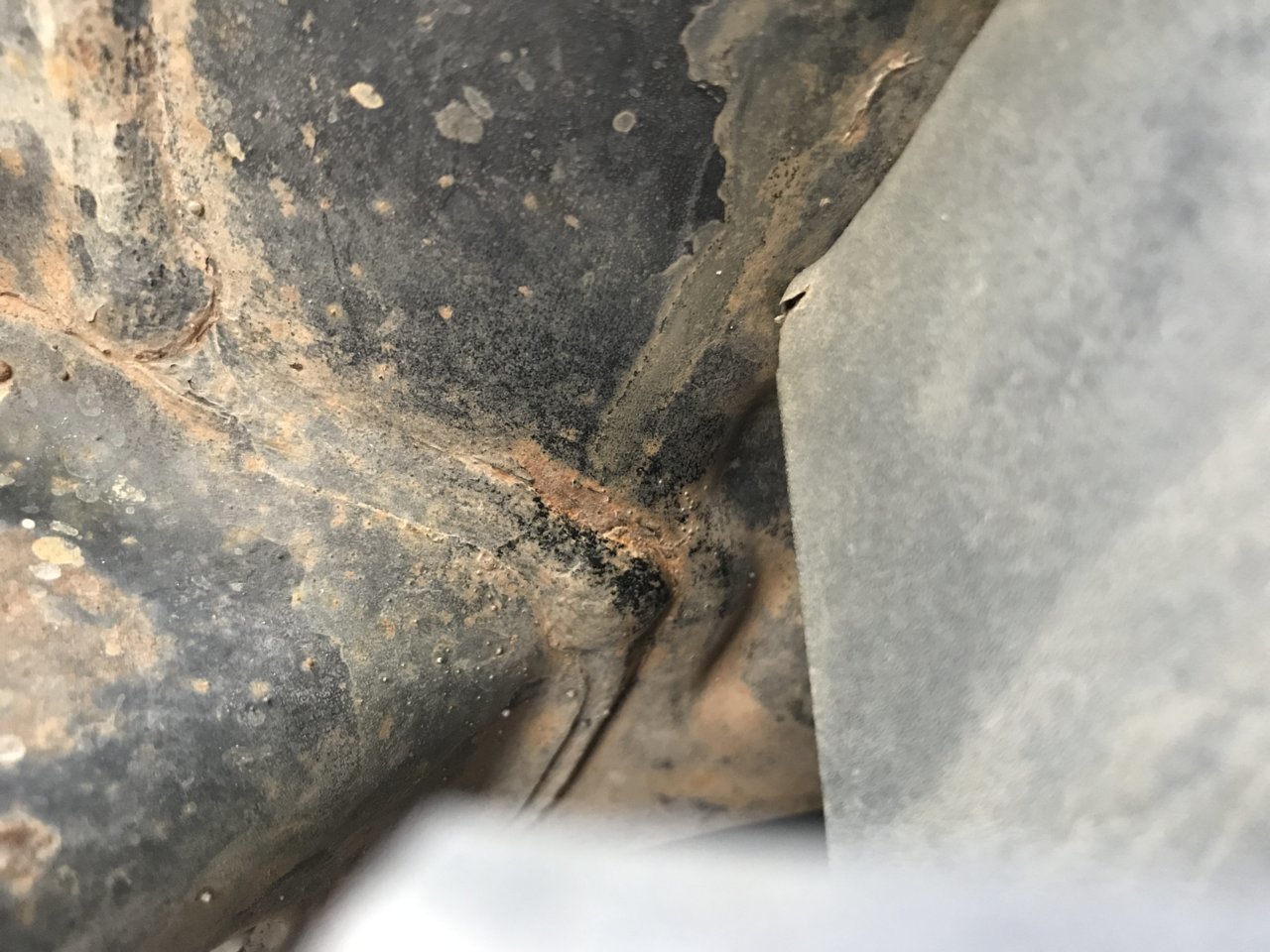

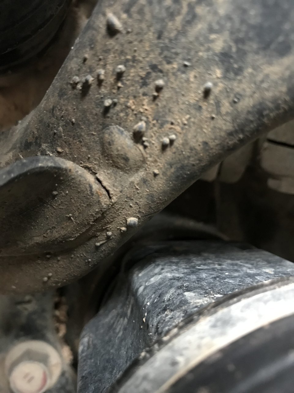

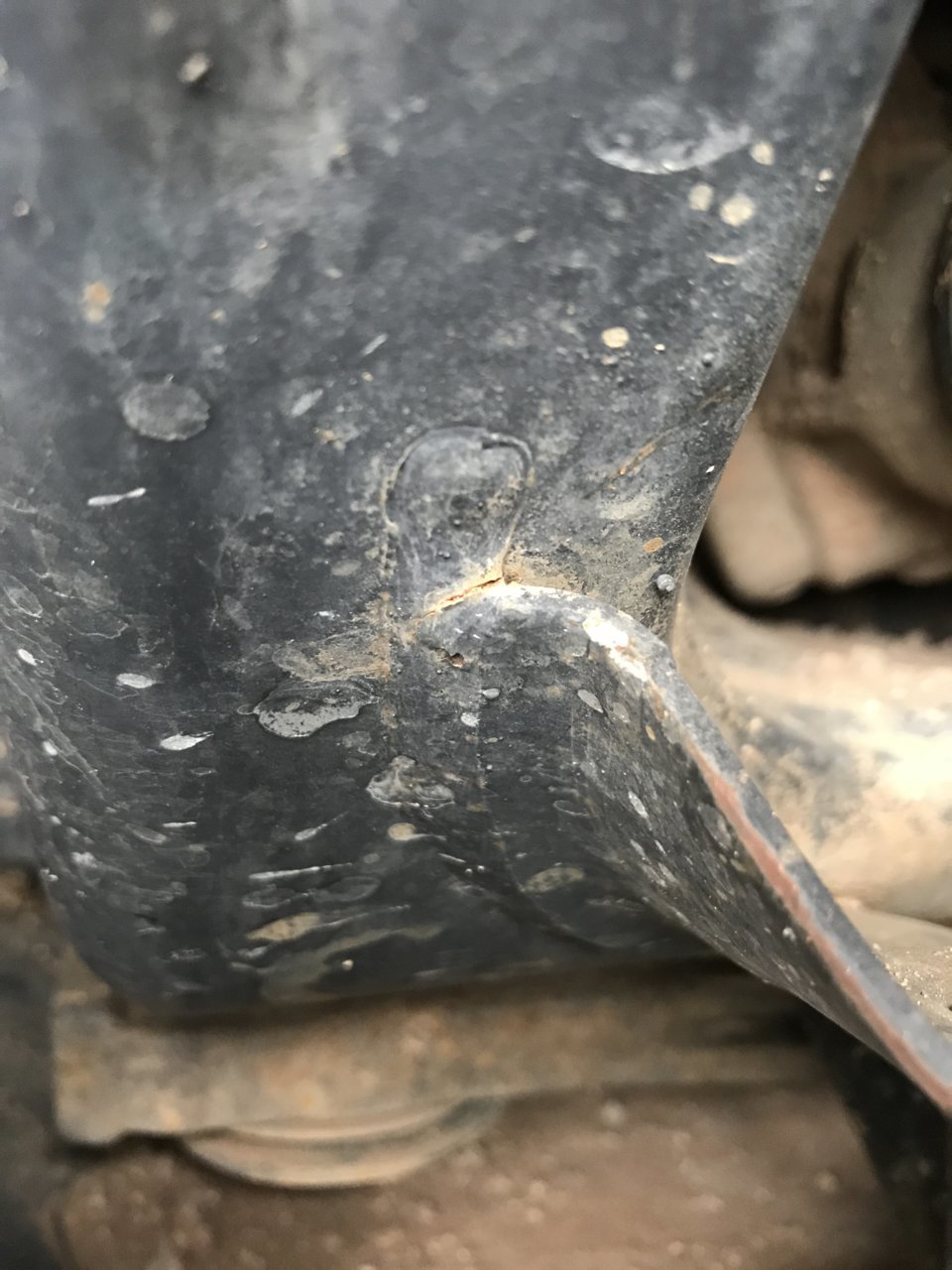

    Not great pictures but they get the point across. These were taken today post the repair. A big hammer, TC gussests, and the frame has been pulled.
    Kind of hard to tell with the LCA in the way and the lighting but the passenger side LCA mount is pushed back a bit.
    The alignment cam doesn't always like to fit and has started to damage the TC gussets. (I did not weld these gussets. These were done years ago by a buddy and welding was not his talent.
    Then the cracks where the LCA mounts meet the frame. Pretty much on all 4.

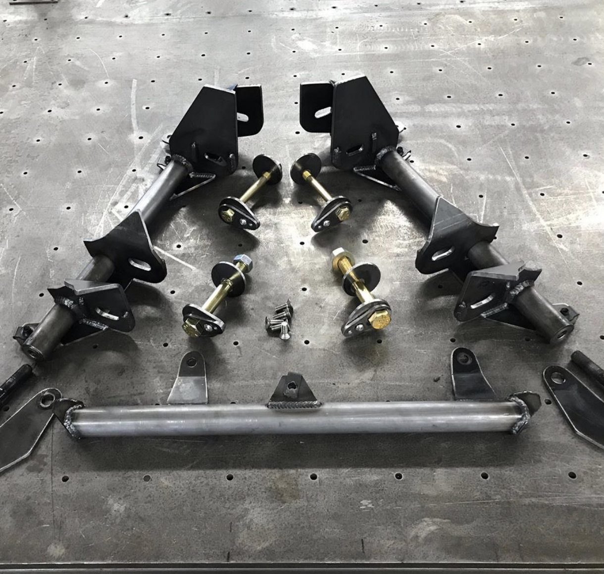

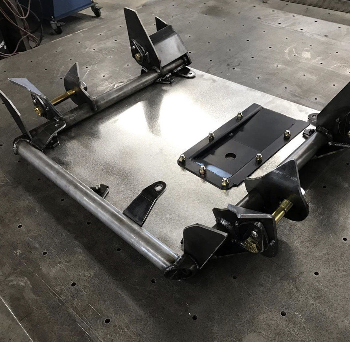

    Just a little reminder of what the winner will be getting!
