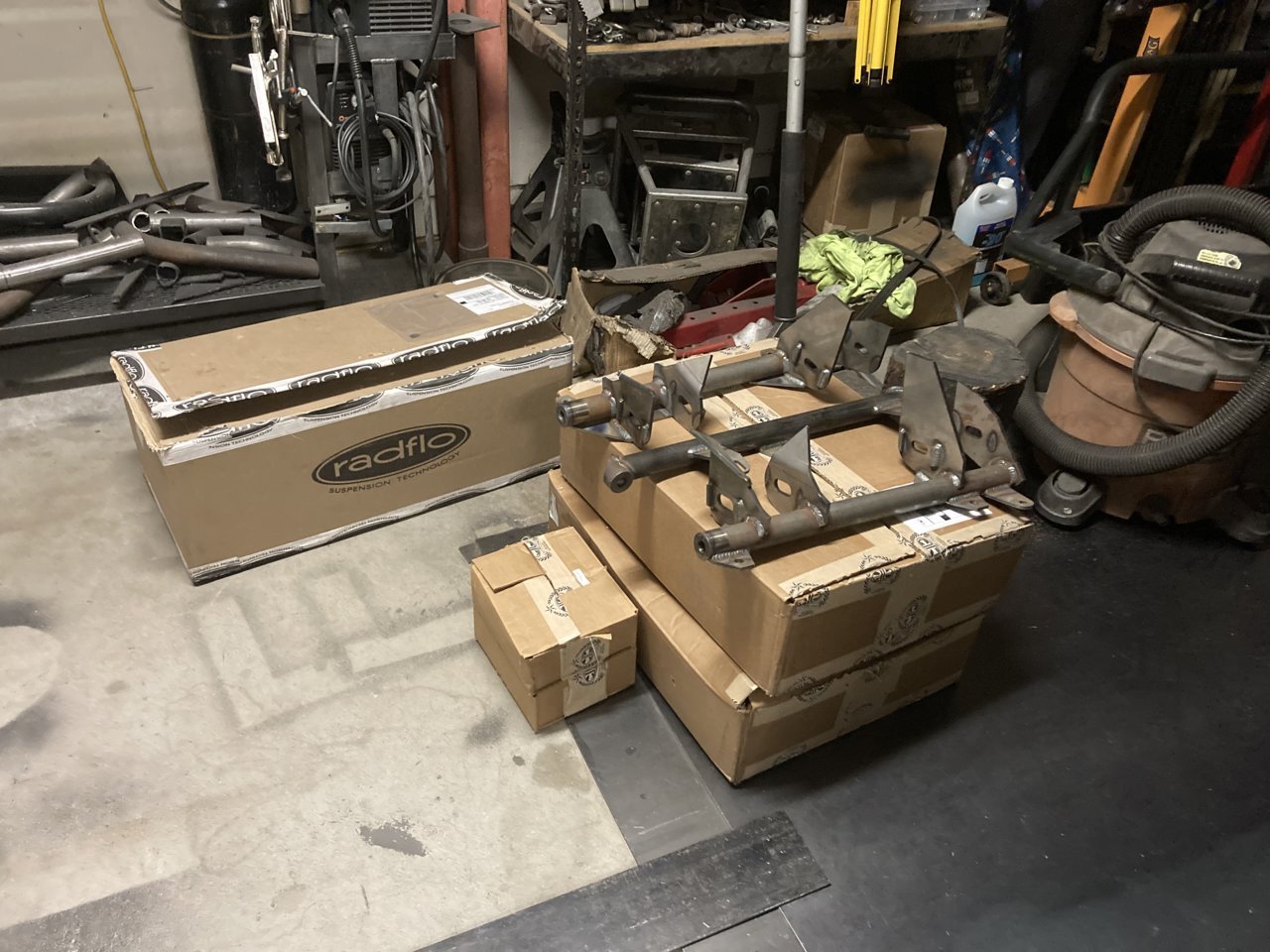

    Mmmmm pile of jdfab parts and new shocks for @Sixthelement truck. Time to start chopping it up in the morning.

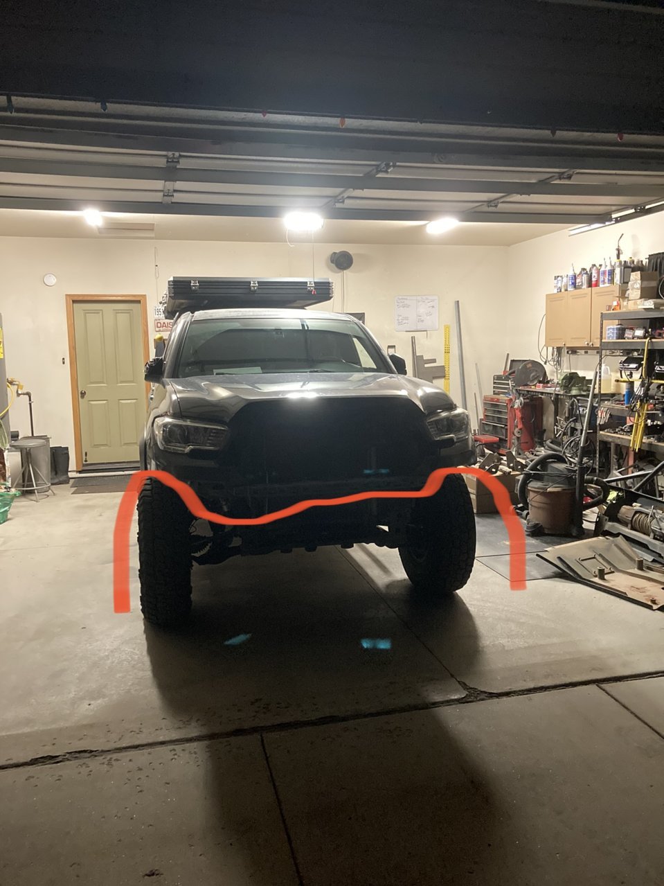

    So I cut here right?

    Yes, then you put tons under it.

    I’m waiting on the jd fab ttb kit for mine

    Yup was on my doorstep when I got home today.
