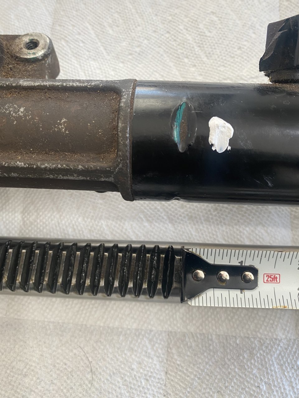

    Exactly. There is a slider internally with a bronze face, there are two bearings on the pinion that are not sealed. These all wear stupid fast with dirt intrusion. It will also pull dirt to the hydraulic seals and cause leaks. Currently, I have about an inch of slop in my wheel because my rack is absolutely spanked.
    I’m not going to sit here and toot my own horn, but from what I’ve seen in this group I’ve probably been the one that’s put this setup through it’s paces the most. There’s nothing mine hasn’t seen. The lack of boots is in fact the ONLY weak link.

    But it does. Them teeth come within probably 1/4” of the internal seal. Over time it’s packing into the seal to create a leak. That’s exactly what we found the last time I resealed the rack.

    White mark is where the Side seal sits. At full lock it’s close. Even if you ignore the dirt intrusion, the rack it’s self rusts like crazy and that alone is going to make seals fail.

    The passenger side isn’t really the issue. On the driver side, there are teeth in the shaft. That doesn’t have a full seal around it at all times.
